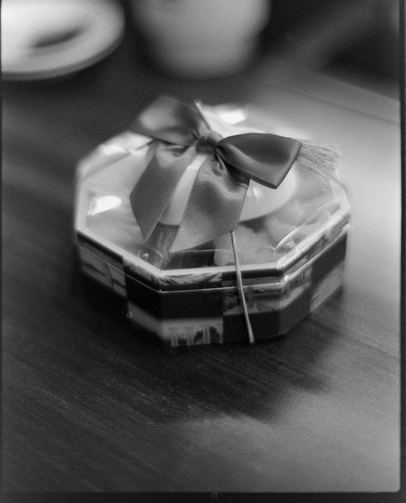

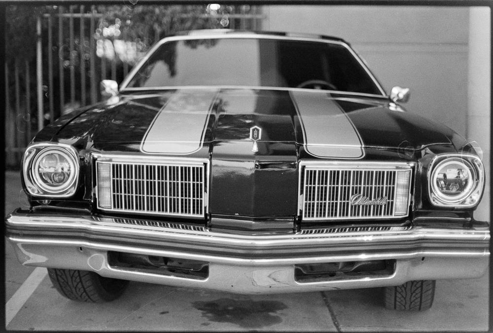

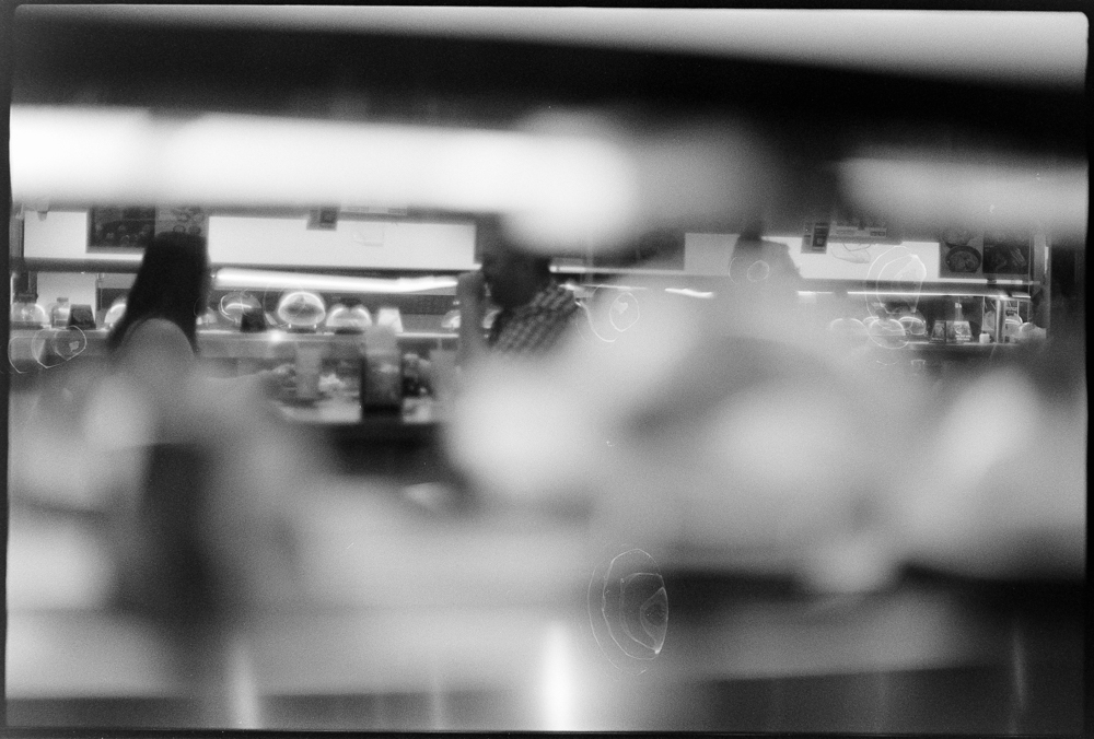

Results are decent, I used 11mins. Its nice not to have to stand there for 15mins waiting to agitate. More experimentation is needed. Forgive the water marks.
