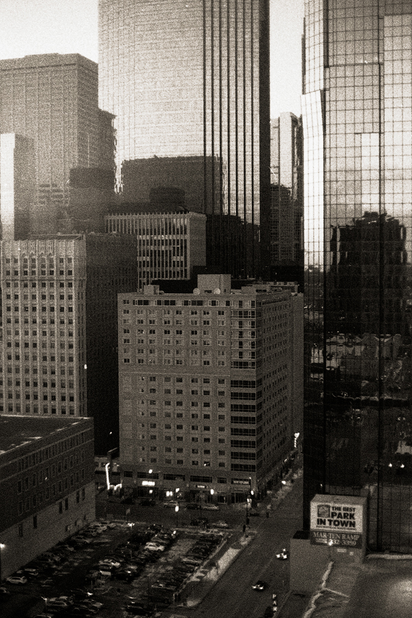

The following example is from a negative that looks to be really "thin". It isn't on anything like Delta 3200, but due to the nature of the light and the subject, it prints really well:

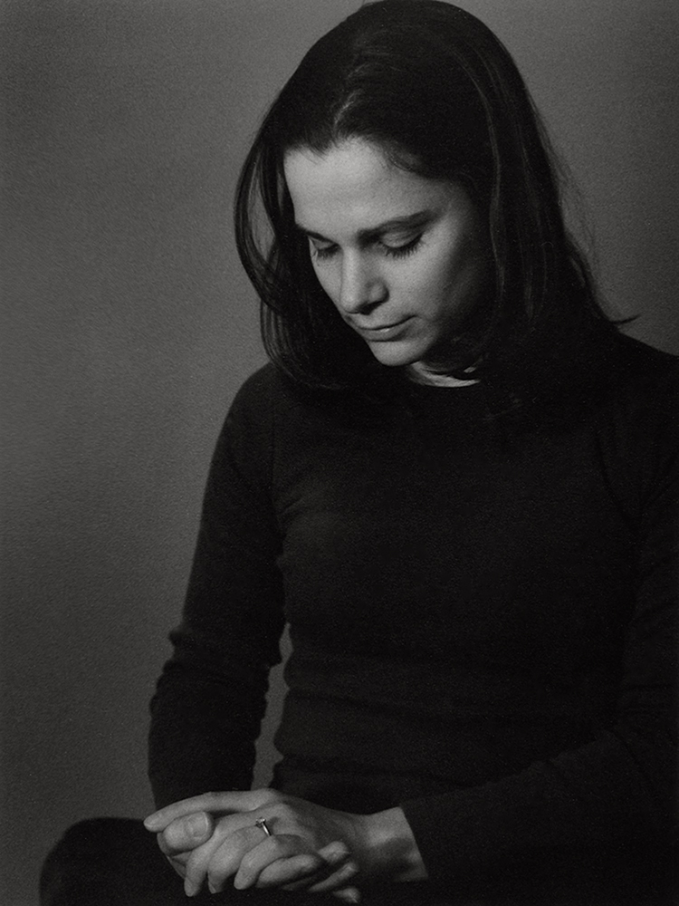

Agreed. Here's another example. Portrait is 120 645 (processed in DD-X), and the other is 35mm (processed in Rodinal). Both do look a little thin.

Of course. That is what a good craftsman should do. With subsequent rolls, like my post number (there was a url link here which no longer exists), that negative is not thin.
Both prints look fine to me, Thomas. I wonder what a thicker neg would have given in the print that isn't there in the current prints?
pentaxuser
I would say a bit better tonal separation in the shadows, which I don't particularly find all that important for the most part. It depends on the subject matter how important that is.
If I had exposed more I would have probably held back developing time a bit, which would have made the portrait a little bit more manageable to print, and the overall contrast in the cityscape image might have ended up requiring less dodging in the darker areas at the bottom of the building where having visible detail seemed important to me.
