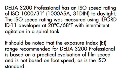

Well, according to the delta 3200 data sheet:
DELTA 3200 Professional has an ISO speed rating of ISO 1000/31o (1000ASA, 31DIN) to daylight. The ISO speed rating was measured using ILFORD ID-11 developer at 20°C/68oF with intermittent agitation in a spiral tank.

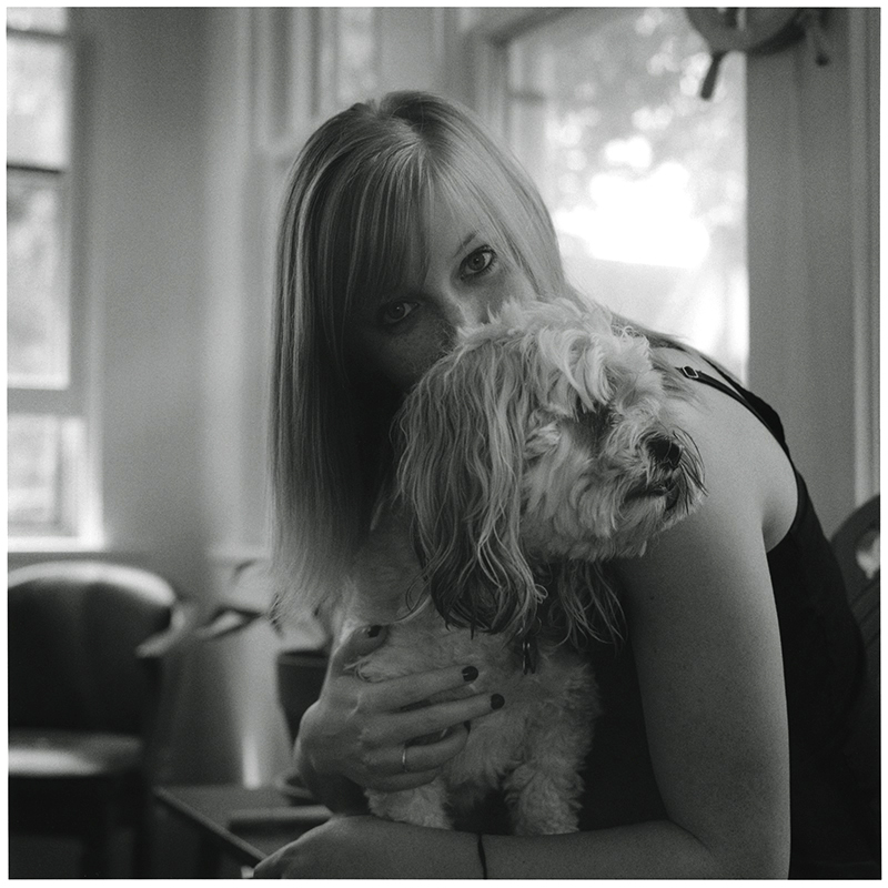

Delta 3200 is, for sure, a grainy film. I absolutely LOVE to use it for close-up work, particularly for portraits of women and children in 120 format. It looks incredible the way I see things; the grain adds something to the picture that I love. In 35mm it might be really grainy, but move in closer, and the resolution of the film will start to really shine, and the details will not be as obscured by the grain.
