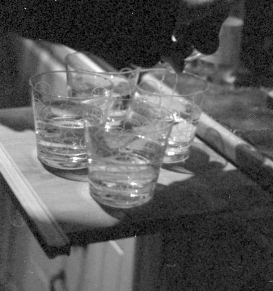

I wanted to take some pictures of my family this last Christmas, and as the Swedish winters are fairly dark I decided to use Delta 3200 in 120 format. I rated it at 3200 (exposure was around 1/30 @ f/5.6 for most shots) and developed the film in Microphen (stock solution) for 9 minutes at 20c as per Ilfords recommendation, continuous agitation for the first minute and then 10 seconds every minute.
However, when I scanned the negatives I noticed that the photos are *very* grainy, and more especially the grain is *ugly* it's huge and clumpy. Now I know that Delta 3200 is grainy, but I've seen so many examples that look so much better.
For example, this guys pictures look a lot better, much smoother grain and better tonality. This person also achieved better grain.

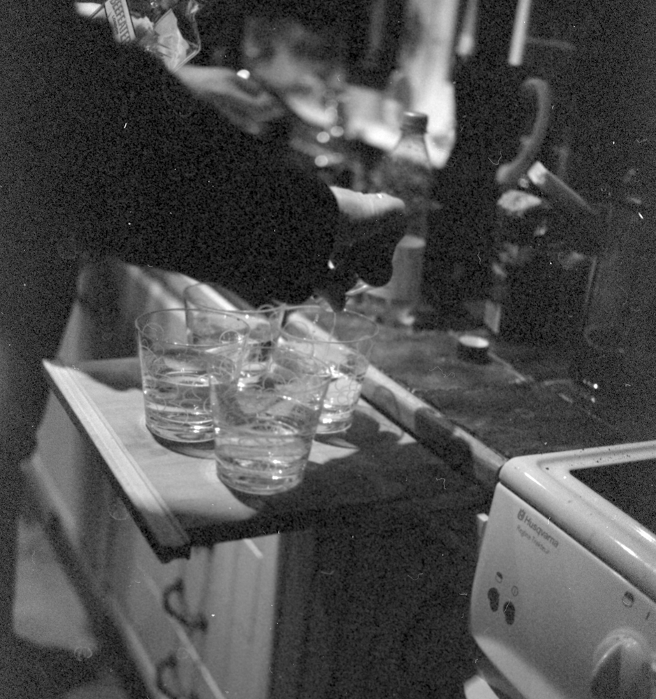

I've attached a scan of one of the pictures, as well as a crop of the same picture.
What could've caused this ugly grain? Agitation? Developer choice?

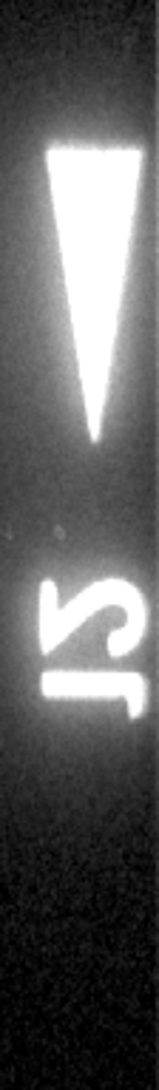

EDIT: I also noticed that there is this strange "bloom" around the edge markings (see attached picture), and it's not only the scanner doing it, if you look at the film you can see a "cloud" of density around the little numbers and symbols.

Based on your explanation and on the "this guys" description of his I cannot see why your pictures are grainier than his appear to be. However this is based on a comparision of scans. The real test is a silver gelatin print.
I'd strongly suggest that you get a print done and then decide if D3200's grain is acceptable to you.
Any fast film, even in 120, may show grain beyond a certain enlargement but you should get to at least 8x10 inch prints with reasonable grain. At least that has been my experience
You appear to have ruled out any problem with your scanning and you may be right but when you introduce scanning into the situation you introduce other possible problems.
What I am now going to say may not and probably will not make much difference but is worth a try. Next time reduce the speed to 1600, if at all possible and try either Xtol or DDX

I do not find the grain excessive or clumpy. Concerning the edge markings I just checked - indeed they have a bloom around them in 120 format on my films too (in particular the arrows with numbers, as you show it too), but they are sharp and crispy in 135 format - so I think this is connected to a different method for exposing them on the films and not an error of development.

To me, it looks like the film was underexposed. Notice the dark tones that have no detail in them, even though they're not dark black...the scanner lightened the image to compensate, but since there's no detail, all you get is empty dark tones full of grain.
I'm not so sure it's not underdeveloped. Normally more development would equal more grain but in the case of D3200 I'm not as sure. I do know I get great results if I use Ilford's times for one stop less. When I shoot it at 3200 I develop per instructions for 3200. It's a flat enough film that contrast doesn't build excessively and the midtones and highlights get much better development. Mine look great (for a film shot at 3200.)

+1 on the bad scan. All of the crap is in the shadows. Look at the mid tones on the cutting board. They're pretty much grain free.

I'm going to suggest that the problem is simply not enough exposure.
You can check this on the negative with a loupe or magnifying glass in the sleeve area and under the cutting board; if detail is hard to see directly when magnified (film nearly clear) that would verify that underexposure is the problem.
Printing these negatives darker and at a higher contrast rate might improve the result with these.

I think it's a combination of "not enough exposure" and the scanner. Scanners are good at finding information in shadow areas, and that means that an area that would look close to solid black in a wet print can have this kind of grainy look in a neg scan. Compare a wet print, and in the digital domain try squashing the blacks to match the print.

I bet if you made prints you would see less grain. Scanning always (in my experience) accentuates grain, especially when you are trying to raise the shadows up like you are in the examples.
Quick fix: drop the shadows down to where they should be (true blacks) and see how underexposed the shots are.

There is a very strange mottled look, certainly partly a bad scan, and maybe actually an out of focus scan...
I've certainly had much better. I've head Microphen is good for pushing I think so I'm surprised, but it also looks like there's something else going on, the edge marking light bleeding is normal, but is the film possibly very dense? Almost looks over developed... Or perhaps the film was fogged somehow? Hmm. Hope you can figure it out

I agree with others. Bring down the shadows to what they should be, you have grain in all the dark parts with no detail. They should be solid black. Also it could be over sharpening by the scanner software.

Or could it be reticulation caused by cold rinse water? That looks like messy grain too.

Until we hear back from Cybertrash as to how much detail is visible in the shadow areas on the negative, we are just speculating.
Normally though (with non-C-41 films) reducing exposure means less visible graininess.
More exposure (coming from bright subject matter in the scene) means more silver gets developed in the finished negative, which means more grain.
Less exposure (coming from dark subject matter in the scene) means less silver gets developed in the finished negative, which means less grain.
Too little exposure (coming from very dark subject matter in the scene) means no silver gets developed in the finished negative, leaves a pure clear film base, which means no grain.

I examined the negatives with a loupe on a light table (or well, a piece of ANR glass on top of my iPad) and I suspect that what many of you said is right, the negatives show little or no detail in the shadows (the shadows do show visible grain however, even in the clear areas of the film, interestingly enough). I suspect that rescanning with a higher black point might get rid of some of the clumpiness.
Stone mentioned an out-of-focus scan, the negatives were very curled (currently flattening them), could that have made the problem worse?
Nonetheless, I'll try to find the time to make some silver prints from the negatives and report back.

Where things get real thin on the negative you are typically down on the toe of the film curve and the contrast rate, the difference between neighboring tones, gets really small. This poses problems for both scans and printing because there simply isn't enough detail or contrast to work with.
The problem becomes apparent when you try to display it or print it to look normal.
This is one issue that should stick out like a sore thumb if you use a contact printing regime, at the normal contact print settings frames like this will print very dark.
Scanners typically default toward trying to "fix it" and show the scan at normal brightness, and you end up with "digital noise" in the shadows, not grain. Essentially the software doesn't have enough info to work with and just guesses. What I'm saying is that it's not a "bad scan".
The fix going forward is pretty obvious though given this info, use more exposure.
