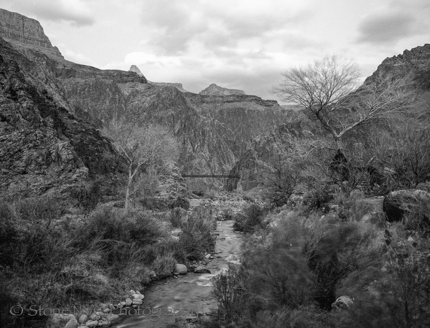

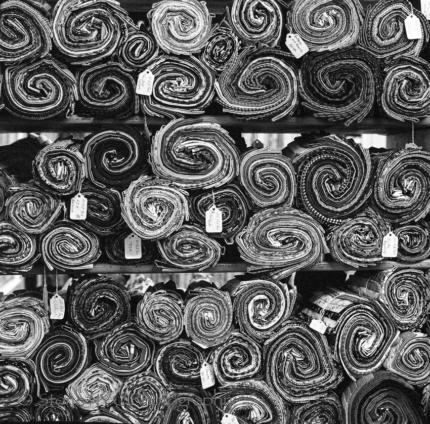

To me, it looks like the film was underexposed. Notice the dark tones that have no detail in them, even though they're not dark black...the scanner lightened the image to compensate, but since there's no detail, all you get is empty dark tones full of grain.
+1 on underexposed. But I would add that it also looks under-developed. Delta 3200 is a strange critter. I usually shoot at 1600 and develop 50% longer than Ilford recommends at that EI. This is something I do for this film only.

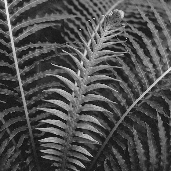

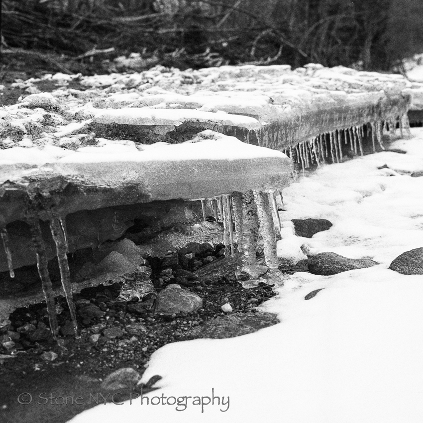

The fern is scanned 120 D3200, shot and processed as above, and the 'ice feather' is a scanned 9x12" print from 35mm D3200, actually a cropped negative.
Beautiful greyscale, and 50% is almost more than I would think and might blow out the highlights, but obviously for you this didn't happen, might partially be the grade of paper you choose? But I'm not as familiar with all of that, but starting to learn it slowly as an abstract concept since I don't yet do it myself.
Thanks for sharing.
Underexposed and underdeveloped, while normally rather distinct, get a bit murky when talking about pushing and, especially, pushing D3200 (or TMZ.) This film is deliberately optimized for pushing meaning it has low contrast unpushed. (I know you know this Thomas, for those who don't...) Increasing development does pick up some shadow detail in my experience, and the contrast build is more gradual so you get good midtone separation without blown out highlights. If it was shot at 3200 I would say to first try increasing development (as well as optical printing or at least scanning with a different black level or whatever it's called.)
Everyone I've ever heard from who likes and uses this film (and I have several rolls in the fridge to be developed soon) prefers more development than Ilford lists for a given speed.
Jan 21, 2003
15,715
Switzerland
Underexposed and underdeveloped, while normally rather distinct, get a bit murky when talking about pushing and, especially, pushing D3200 (or TMZ.) This film is deliberately optimized for pushing meaning it has low contrast unpushed. Increasing development does pick up some shadow detail in my experience, and the contrast build is more gradual so you get good midtone separation without blown out highlights. If it was shot at 3200 I would say to first try increasing development (as well as optical printing or at least scanning with a different black level or whatever it's called.)
It depends on how much shadow detail you want, I guess. I wish to remain objective, and judge the posted pictures as 'technically good' negatives, and those shadows have very little in them.
I find it isn't until D3200 has been properly exposed and processed that you get away from a very grainy result. But you get tremendously rewarded when you hit it just right. That's my experience anyway, and is based on shooting no more than 50 or 100 rolls of the stuff over the years.
To get it right, however, just get in there and see how far you can push you processing before the highlights block up. I know you'll find that you have to go really far before that happens.

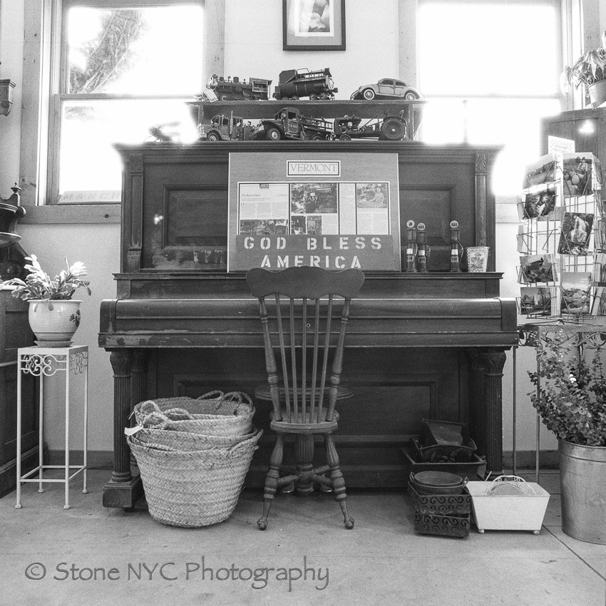

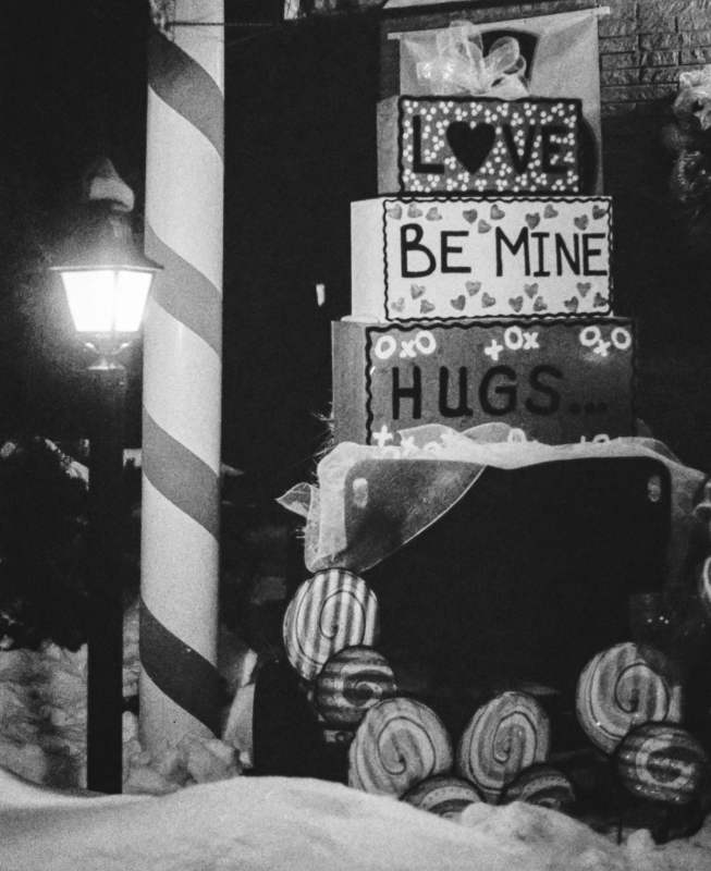

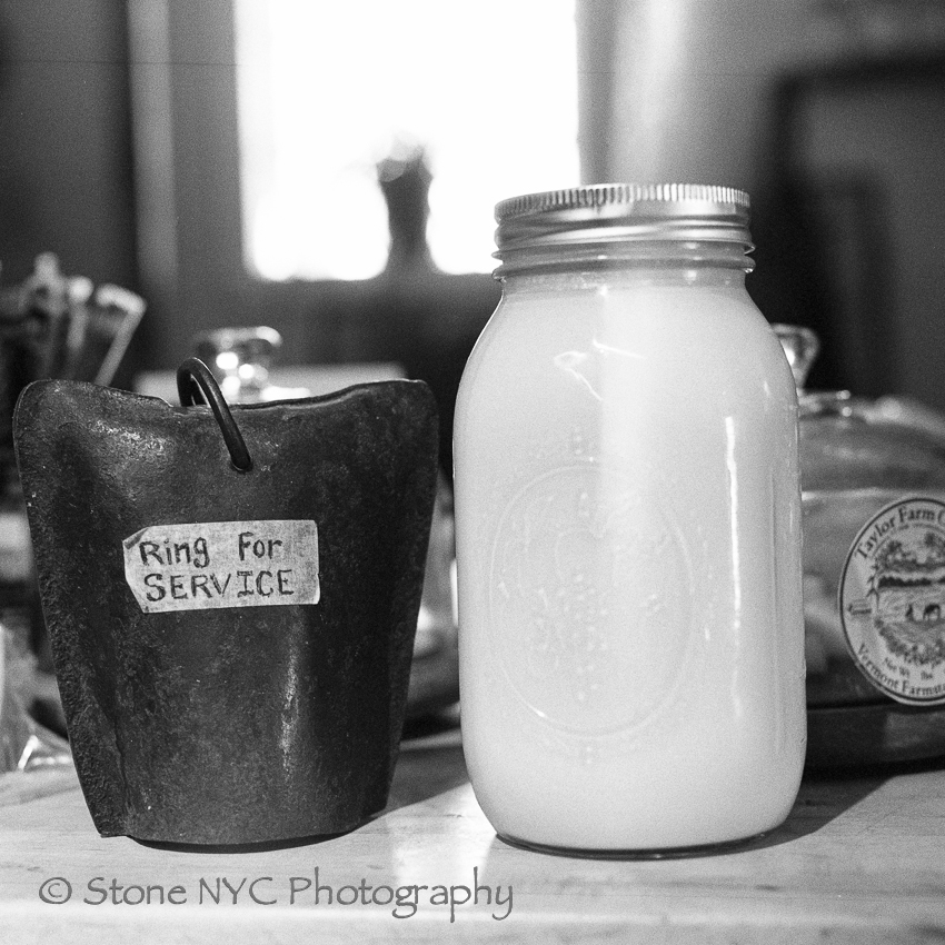

One of my favorite sets of images was shot on D3200 and developed for D3200 but it wasn't quite as contrasty of a scene as you have, but the grain and look is excellent. It's an Americana Series...
D3200at3200-DDXat5500or11min-3200-01.jpgD3200at3200-DDXat5500or11min-3200-05.jpgD3200at3200-DDXat5500or11min-3200-10.jpg

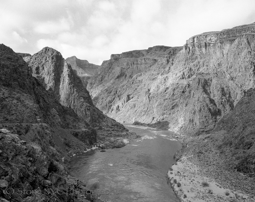

I've also shot outside with good grain results, although again this was daytime but just very low light, or long exposures on a tripod in dim light... as the last one following...
D3200at3200-DDXat5500or11min-3200-08.jpgD3200-DDX-Epson-3200-GC004.jpgD3200at3200-DDXat5500or11min-3200-12.jpg
Dusk 1(ish) minute exposure...

Stone, those are nice; and I'm not used to seeing that kind of contrast posted by you :smile:
StoneNYC
Aug 5, 2012
8,345
Antarctica
8x10 Format
Thanks, all depends on what I want from a scene.
Sometimes I actually like low contrast... Sometimes :smile:

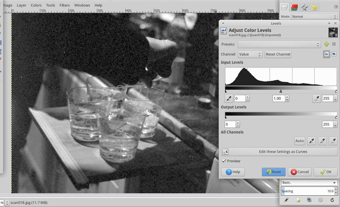

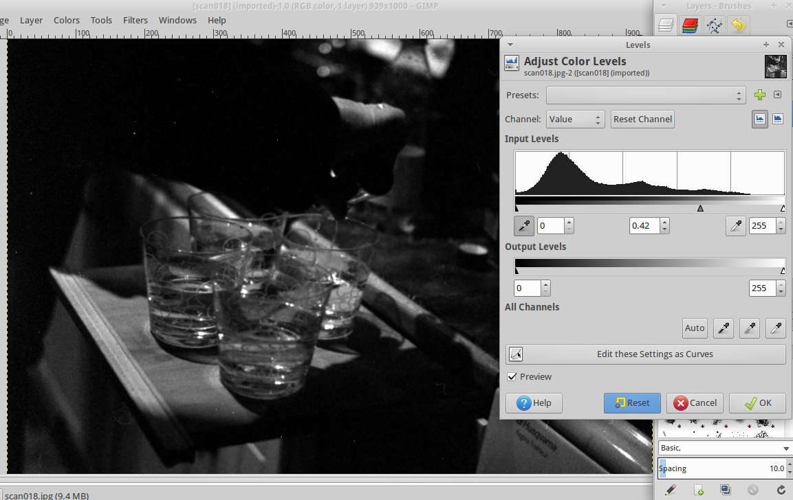

My guess is underexposure and scanning issues. The scanner software has set the black point to clip the lowest level pixels (of the inverted image), and that combined with noise can sometimes make the shadows contain completely black pixels like those you see. I see them often enough in my own scans of underexposed negatives.

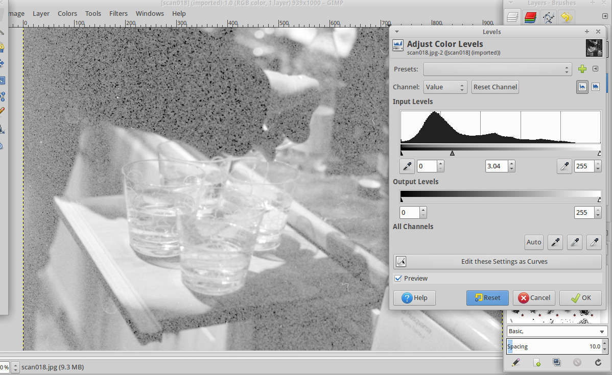

Here are some examples where I did a level adjustment in Gimp. I only moved the center point, not the cutoffs. This is roughly equivalent to raising/lowering the middle of the tonal curve.
First, your picture:
Then, the middle level pushed to the left, which leaves the completely black pixels unmoved but brightens the almost-black:
Then, I pushed the middle level towards the highlights, and suddenly the tones looked good on my terrible laptop screen:
You might be able to get a better digitalization by setting the scanner software to not clip either end of the histogram, and do the tonal adjustment in post.

Based on what the previous user posted (using GIMP a free type photoshop program) I'm now convinced it must mostly be a scanner issue.
I truly try to get decent values from my negatives with good exposure and development.
I don't know what a "good" negative looks like for printing, but I assume that if I can see information on the entire negative, and nothing is ultra black, and nothing is totally see through, then my negative would have a lot of tonality and tons of greyscale with a traditional print, and someday I hope to find out. I also have worked on my high contrast negatives and low contrast negatives, I find that I prefer more contrast in most circumstances, but that's preference.
That said... I don't often have issues with my blacks, because I pre-visualize what I want from a scene and pick my exposure based on that idea, and 9 times out of 10 I don't actually have to adjust anything in the scanner settings, because the exposure and development came to the right points on their own. And usually when I do have to adjust, I obviously messed something up and I can see it in the negative... (One of these is not like the others...) :smile:

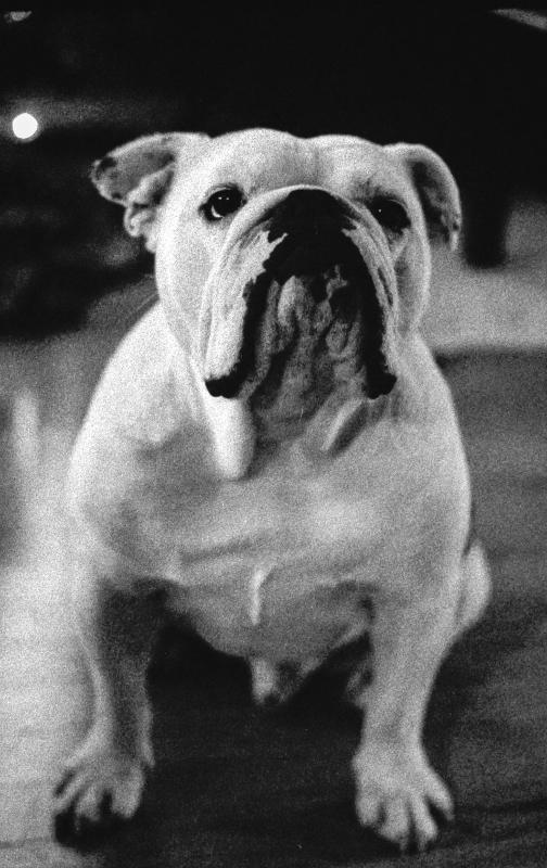

FWIW I haven't found that to be necessary for Ilfosol 3. I expose at 3200 and develop for 3200 and get results I'd expect.
