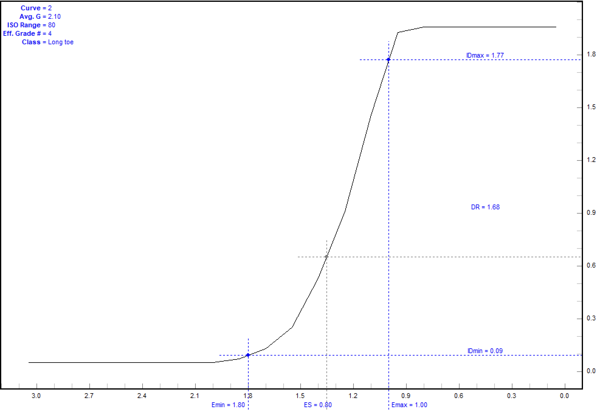

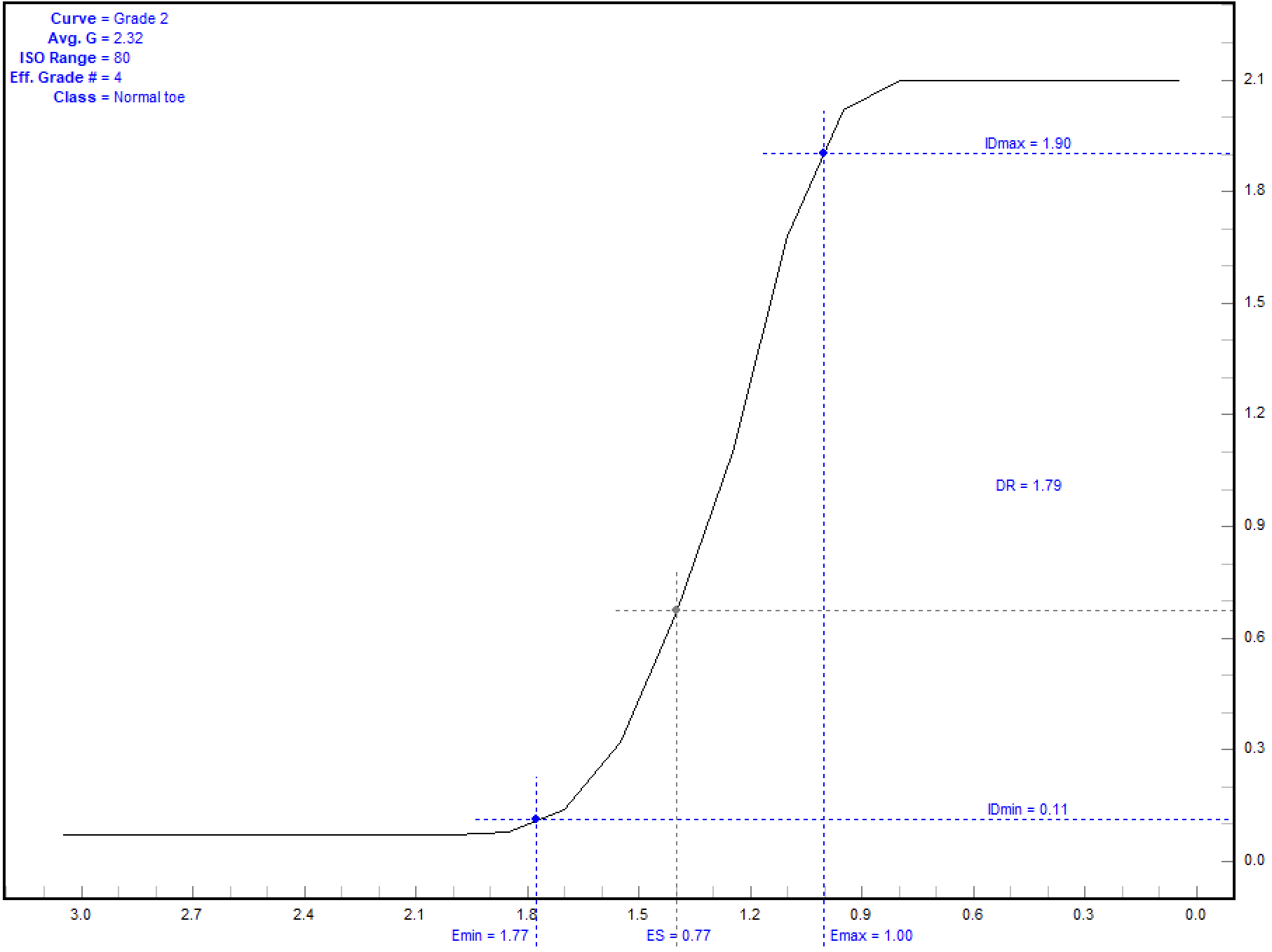

I'm struggling with a contrast control problem in my printing I hope someone can help me with.
I'm currently printing with an Omega D6, the variable condenser head and Ilford contrast filters above the negative. When I test with a Stouffer step tablet I'm seeing each filter print between 1 and 2 grades higher contrast than what I'd expect (and what the sample data that ships with the BTZS WinPlotter shows.) It's consistent across Arista.EDU FB Glossy, RC Pearl, and Ilford MGRC Pearl, so I don't think it's just the paper. I'm developing in Formulary 130, 1+1, for 2 minutes but I see similar results with Ilford's Multigrade Developer. The printing of actual negatives is consistent with what I'm seeing in my test data. For reference, the #2 filter is printing with an exposure scale between 0.7 and 0.8 and the sample data seems to say I should expect 1.00 or a little greater.
I'm wondering how much switching to a diffusion light source might control my contrast and if there's something else I should try to tame things a little. I'm recently back from a 20 year break away from the darkroom and I don't remember having this problem back in the day...

These are the curves I get using a #2 filter, printing a Stouffer 21 step tablet. The first is Ilford MGRC Pearl, the second is Arista.EDU Ultra FB Glossy.
