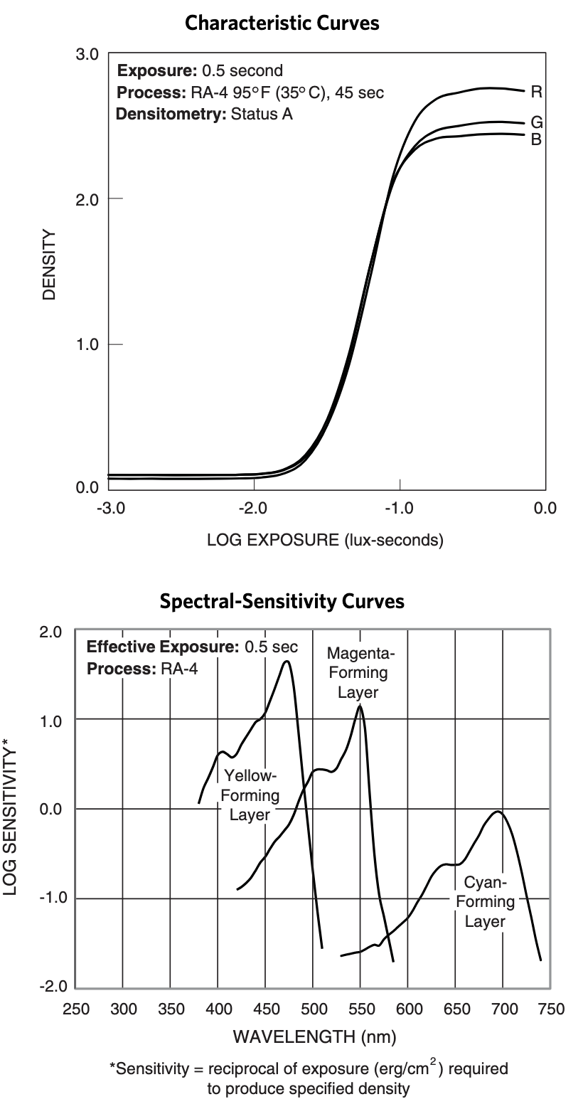

@koraks wouldn't the "digitally compromised" papers reveal their bias in characteristic and sensitivity curves?
From the Kodak Endura datasheet:

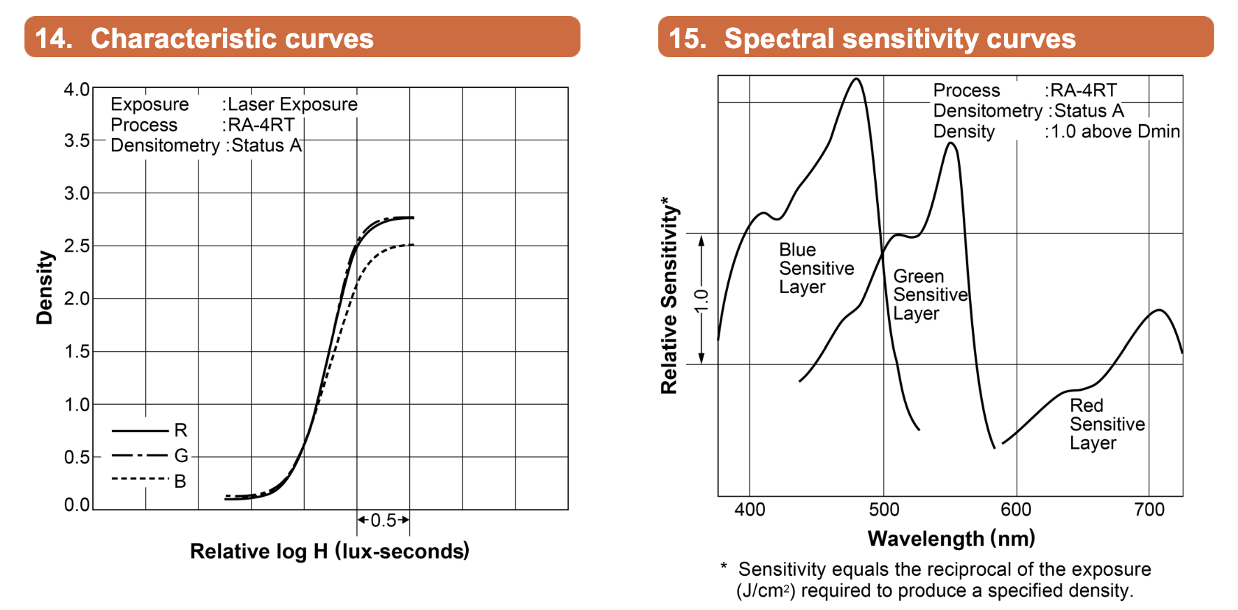

Fujifelx:
Interestingly, Fujicolor Crystal Archive datasheet does not list the characteristic curves. Perhaps your blog post is the reason why?
Indeed, I would expect so, and I've also had a look at that Endura curve you posted for the exact same reason. Interestingly, a man called Richard has replied to my blog discussing Endura Digital paper and indicated that in optical printing you can either balance it for a greyscale and then the skin tones end up 'ruddy', or you can balance for skin and end up with cyan greys.
What we currently don't really know is what the situation with classic Endura is, exactly. If memory serves, the datasheet you got that curve set from dates back to 2007. I don't know if that paper is being made anymore.
Fujifelx:
Note the interesting blue deviation. Btw, this is a different one than what I describe on my blog, which indicates a similar (but not identical) deviation on green/magenta. Then again, we do know that FujiFlex is the only RA4 material being manufactured in Japan. The papers and FujiTrans are made in the Europe plant. I have yet to check what the commonalities between Flex and other RA4 materials are.
Well, the thought certainly has crossed my mind...I'll be sure to ask why they include some information in one datasheet, but not another. If I were to hazard a guess, the answer will be along the lines of "we ask our customer base what they need to know and we include that, and the Japanese colleagues made a different call than we did for FujiFlex."

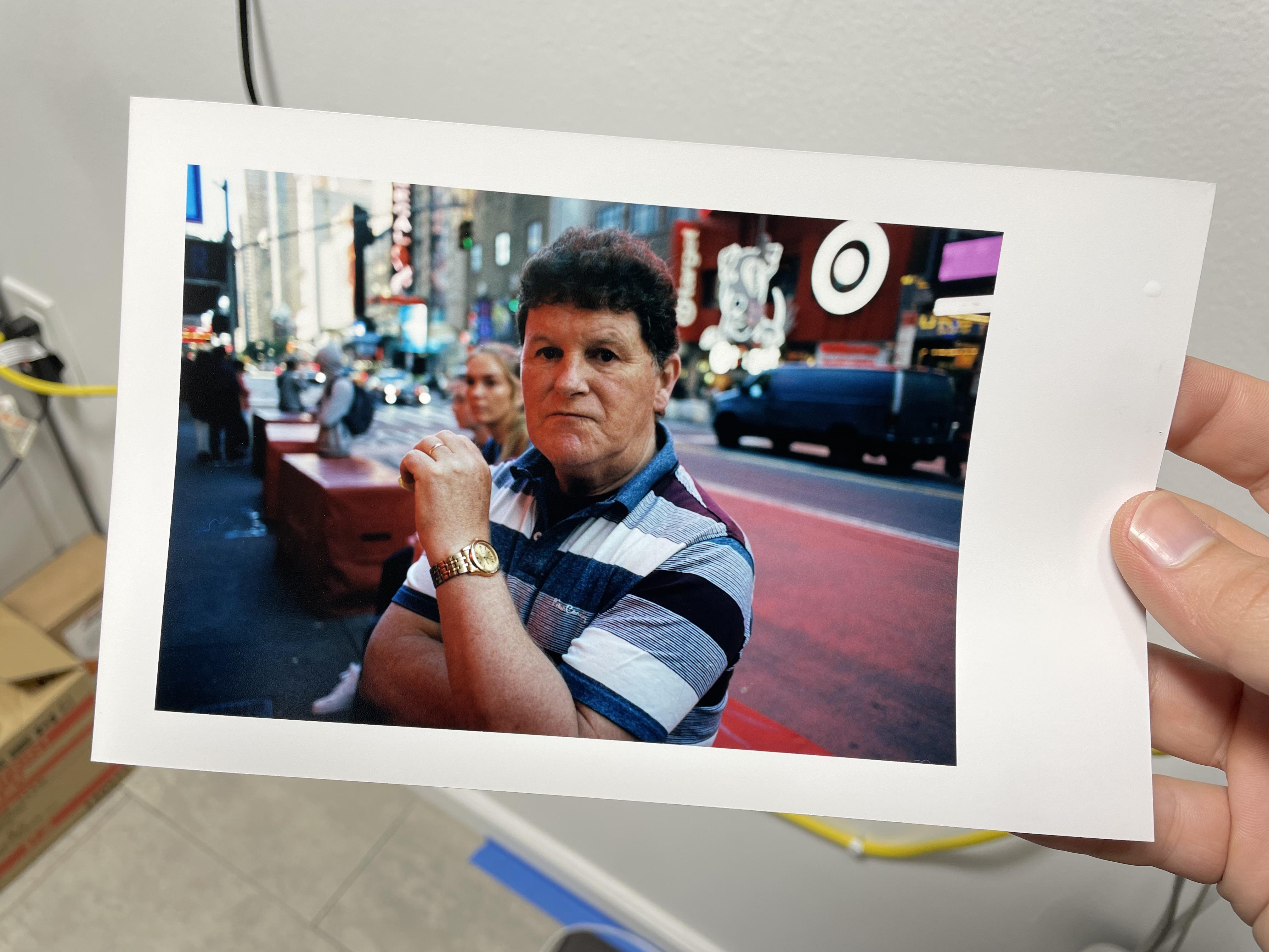

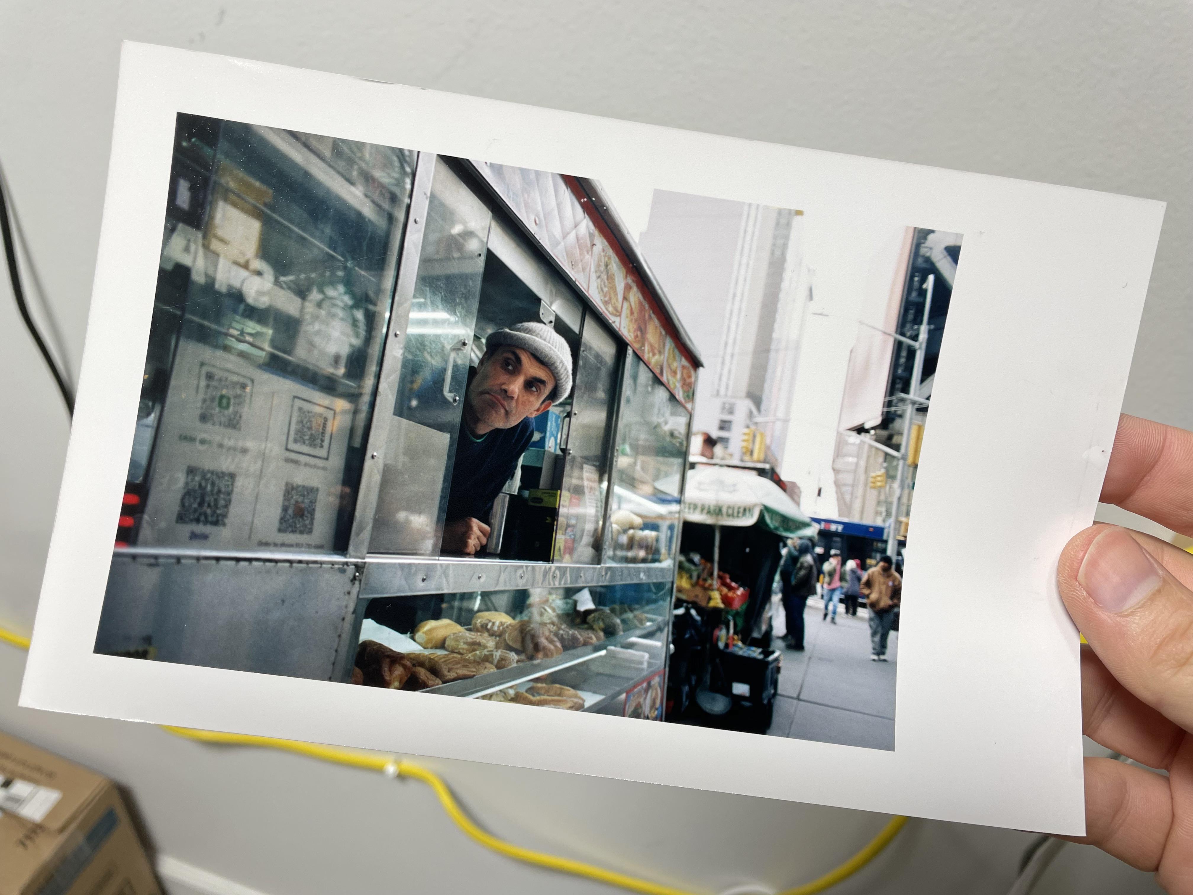

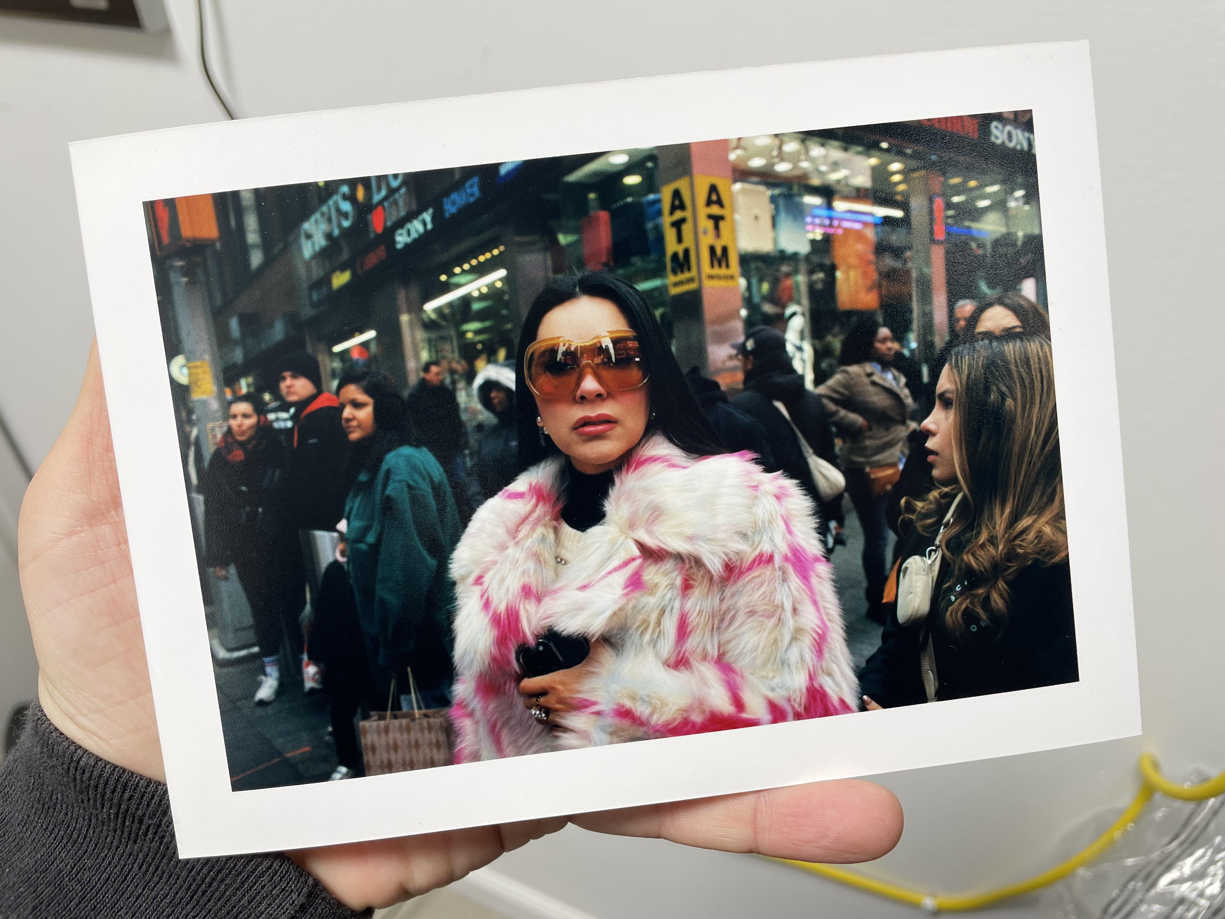

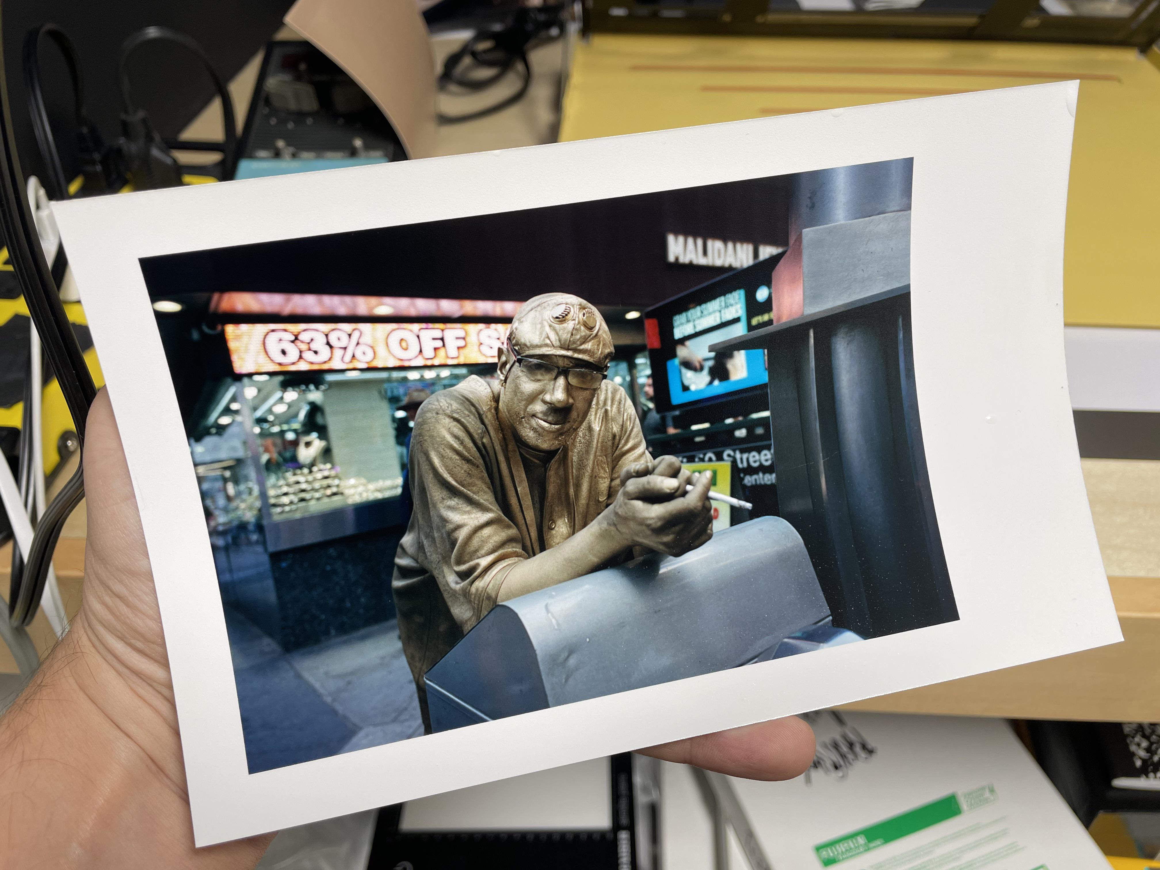

Almost exclusively portra 400 and 800. I've also printed lomo 800 and fuji c200 with good results. Mostly portraits/street stuff. Processed with replenished Champion chemistry in a nova slot processor. Still learning so they're not perfect, but I'm much happier with this paper compared to CAII.

@sillo, nice prints!
