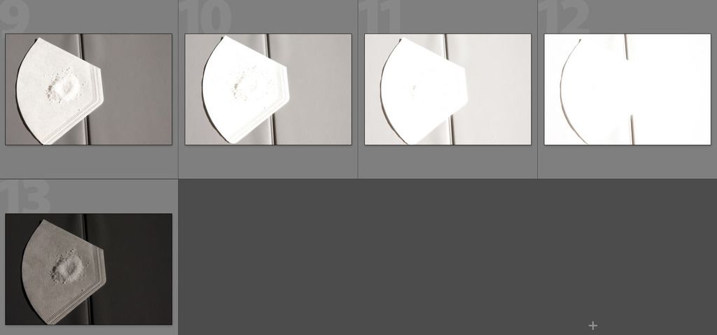

Here is such an illustration, shot many years ago...
I put a piece of while coffee filter paper in the sun, sprinkled something white (salt?/sugar?) onto it, and then recorded a series of exposures. The first shot renders the middle tone (18% gray exposure card) at its inherent brightness, or 'proper exposure'. Then I recorded each successive shot +1EV brighter than that prior shot, concluding with a shot -1EV from 'proper' exposure.
...notice that the white substance disappeared at +3EV, and was scarcely detectable at +2EV although the filter paper was still easily discernable from the 18% card, and (-- except for the shadows cast -- ) it had disappeared into the card at +3EV
Frame #1 probably already lacks texture in the white particulate matter, #2 is exposed into oblivion. This illustrates my point - while your 18% grey card may come out OK at +2EV, the problem is that the world we photograph is generally not a featureless field of even tone. It has texture, and texture means brightness variation. Things start to break down pretty quickly if you err to the side of overexposure. Even if you spot meter with a narrow 1% angle (or so, whatever your digicam affords), many textures are finer than that measurement angle - and they're by far not always specular highlights you'd want to lose.
What I notice is that essays that argue for ETTR often rely on very flat scenes with very little brightness variation. I agree that in such cases, you could overexpose a bit to optimize s/n ratio. The real-world gain in image quality will be really, really limited. Overall - not worth it, IMO.
What is worth it in my book is to determine how much overexposure your digital camera can take before things start to go south and then ensure you steer clear of that point for anything that needs tone or texture. Which is very much like how you'd shoot slide film.
Again, no argument. This is getting 'into the weeds'.
I will point out that if one is USING the histogram on the camera to keep pixels from falling off the edge of the histogram, the inherent definition of ETTR, then detail is preserved! So then rather than simply -2EV when reading something with Zone VII brightness, one might be actually using -2.33EV and preserving detail. The 'read Zone VI, then adjust -2EV' was, I believe, for discussion of the fundamental principle.
BTW, I just looked at the original shots and in the 'proper exposure' (shot 1) the white substance was already close to the right edge of the histogram (falling into Zone VIII brightness)
so at +2EV it was indeed 'off the histogram' and 'exposed into oblivion'!
