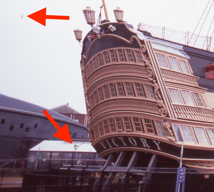

I am having problems with blue lines appearing on my scans. I am scanning Fujichrome Velvia 100 (slide film). This film is not mounted as slides but is in film strips and placed in the film holder that came with the scanner.
The film was lab processed by a reputable lab.
I am using Epson Scan and the latest version as updated by the updater software.
I am scanning at 6,400 dpi but altering the resolution has not altered the appearance of the blue lines. I have also tried cleaning the scanner glasses and film holder, trying all of the different heights possible for the film holder, turning digital ICE on and off, 24 bit and 48 bit colour but the problem remains.
Can anyone suggest what is causing this problem? I very rarely scan colour so I am at a loss. Is it a scratch from the lab? I can't see it with a loupe (but I might have better luck in daylight).
In the example photo the blue line is horizontal across the lower part of the photo. This line does not appear on all the frames.

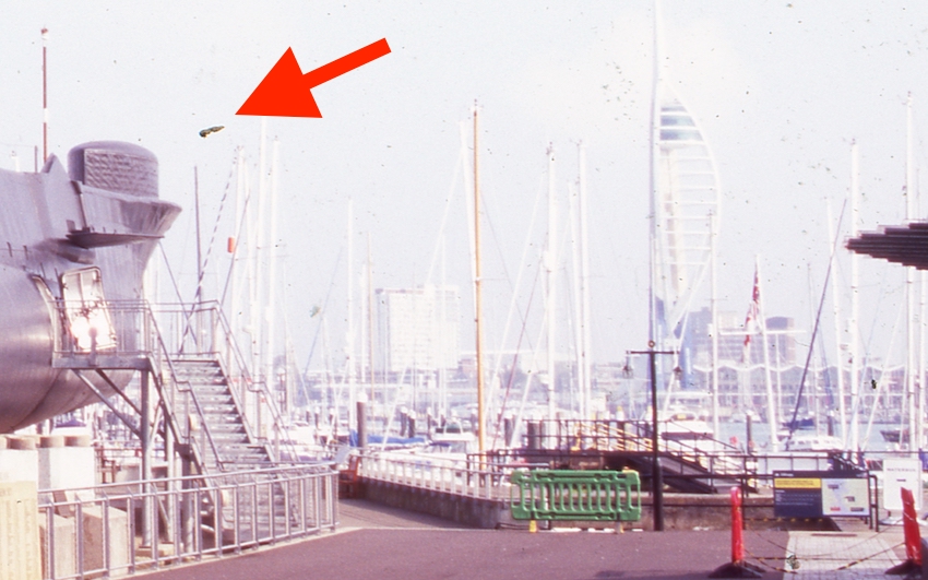

I think this is a lab issue. The blue line does not affect all frames but some of the frames are very dirty and seem to have odd green crystals on them. I will be expressing my displeasure at the lab's work.

That is almost assuredly a dirty mirror in your scanner. To make sure, flip the frame upside down and scan again. If the line is exactly the same, then it is the lab. 99% it is probably your scanner. If your scanner has a calibrate function, you should use that too. You should actually always use that before you make any scans.

I see this often enougn. Chemical (surface) residue on the film, particularly from labs using roller transport rather than dip-n-dunk. Clone it out (along with the blue line) in PSP/LRM (along with the heaps and heaps of dust!) and evening-out of corners (vignetting). Film can also very easily be scratched in-camera (just a speck of dust or dirt over the gate is enough to cause a lot of damage). "Odd green crystals" can also be symptomatic of excessive humidity, of which all Velvia emulsions are sensitive to.
Leave Digital ICE off for colour scanning — it is much better to master dust-removal by clone-out with tools.

The weird thing is the blue line only affected about 4 frames. The general dirt and weird green crystals affected a lot more.

The line looks a lot like a dust speck in the calibration area of the platen (near the hinge end of the cover). If you dust it and the line disappears, great. If not, then as mentioned, it might be dust on the underside of the glass or worse, in the scanning head assembly, which would require taking the platen off. Removing the platen to clean the underside is not as scary as it sounds; however, I've never attempted to touch the scanning head.
