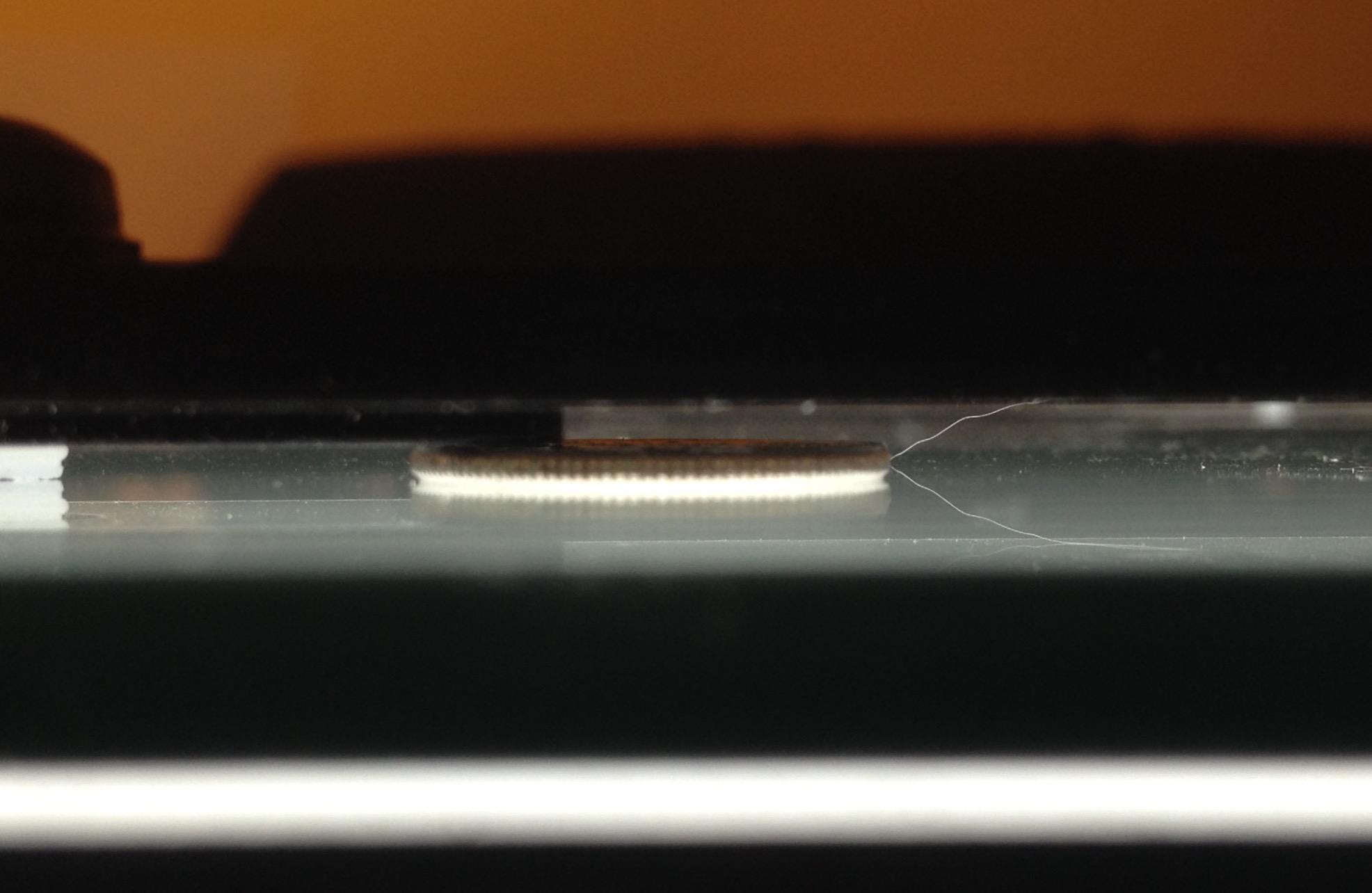

Very few flatbed film scanners out there have autofocus. This makes placing the film plane correctly at the focus plane a critical aspect of setting up a flatbed scanner. Epson has chosen to address this by using adjustable-height film holders, which allow a choice of 2.5mm, 3mm or 3.5 mm above the glass. The nominal focus point is 3mm above the glass.
In a previous thread, I measured the height of my film holders on the "+" setting (nominally 3.5mm above the scanner glass), and found them to be close, 3.38mm, on average (4 holders, 2x35mm and 2x120). I was satisfied with the uniformity of the results for the film holders, and felt that once I found an optimum height, I could set up all my film holders the same way.

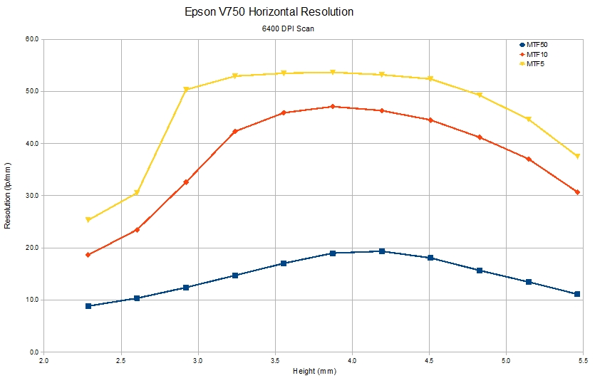

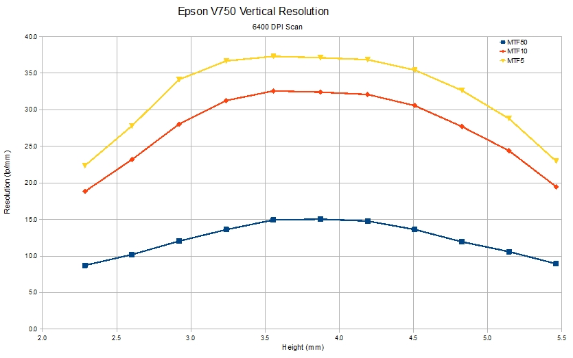

This got me to wondering what the actual optimum focus point of the scanner is. Due to manufacturing tolerances, this can vary from scanner to scanner, and needs to be tested individually.
Here are the results, in graph form, which show that the actual sweet spot (MTF50 line) is quite narrow, and in the case of my scanner, approximately 3.8mm above the scanner glass, higher than the stock Epson holders allow.
Horizontal resolution (across the scanner bed)

Vertical resolution (direction of scanner travel)

So what does all this mean?
First off, the graphs show resolution, in lp/mm, against height above the scanner glass (in mm), the higher the value the better, but the values of the 3 different lines must be looked at together. e.g. for the horizontal resolution graph, the MTF5 line shows a plateau from about 3.2 mm to about 4.5 mm, but the MTF50 line shows a much narrower peak. The sweet spot height is where all 3 lines are closest to their maximums.
Instead of using a test chart, like the USAF 1951 chart, and trusting my eyes to determine the best height, I used an analytical method called "Slanted-Edge MTF". In very brief terms, you scan a very straight edge that's slightly askew, either horizontally or vertically. In my case, I used a razor blade. Because the edge covers different amounts of a single pixel depending on where you are along the edge, it's like you've scanned it at 10x the sampling frequency, and the computer can do some math on the image to determine the Modulation Transfer Function (MTF) of the scanner. MTF is a measure of how much contrast (the modulation %) is preserved when going through the optical system at various spatial frequencies (lp/mm).
An ideal sampling system would have 100% modulation from 0 lp/mm up to the sampling limit of the system, and 0 beyond it. No system is ideal, there are aberrations in the lens, mis-alignments in the optical path, flare, diffraction, even intentional design design decisions like the layout of the sensors on the CCD or the quality of the lens that reduce the contrast transfer through the optical system. There are 3 lines in each graph, representing the resolution of the system at a certain threshold of contrast transfer. They are:
MTF50 -- 50% modulation. This is generally regarded as the "contrast resolution" of a system. It's a measure of how much local contrast is preserved in an image.
MTF10 -- 10% modulation. Based on international standards, this is the generally accepted value for useful resolution, this is sometimes referred to as "extinction resolution", but that's not entirely accurate, since the system is capable of capturing higher-frequency information than this, albeit at severly reduced contrast.
MTF5 -- 5% modulation. When looking at resolution test charts, like the USAF 1951 or others, I've found that a value of 5% modulation more closely matches what my eye perceives to be the last useful bit of resolution, so I've included this value as well.
In looking at the graphs, you can see why just using a test chart of bars (or even an image) might be deceptive. We'll tend to look for the rendition of the absolute finest detail we can, as an indicator of resolution, this is equivalent to just looking at the MTF10 or MTF5 data. By looking at that data, we might feel that there is minimal difference across various heights, as the large plateau on the MTF5 graphs show. So it is possible to choose a film height which maximizes MTF5 resolution, but is still sub-par for contrast resolution. It is much harder for us to judge the 50% modulation point by eye, which is why an MTF calculation is beneficial. The graphs show that the true sweet spot is quite narrow.
Lastly, I'll note that this type of testing is not expensive. There are commercial software packages out there that do this sort of calculation, but I used free image analysis software from the US National Institutes of Health called ImageJ, with the Slanted-Edge MTF plugin. It's not super user-friendly, but it works. There are also some Matlab programs out there to do the same thing, if you know how to use Matlab, and I would guess that Octave (open-source Matlab clone) might be able to run them as well. As for the hardware? Well, a scanner of course...a double-edge razor blade, a bit of plastic, some very small nuts & bolts from the hardware store, and a can of black spray paint was all it took.
Hope somebody out there finds this useful.

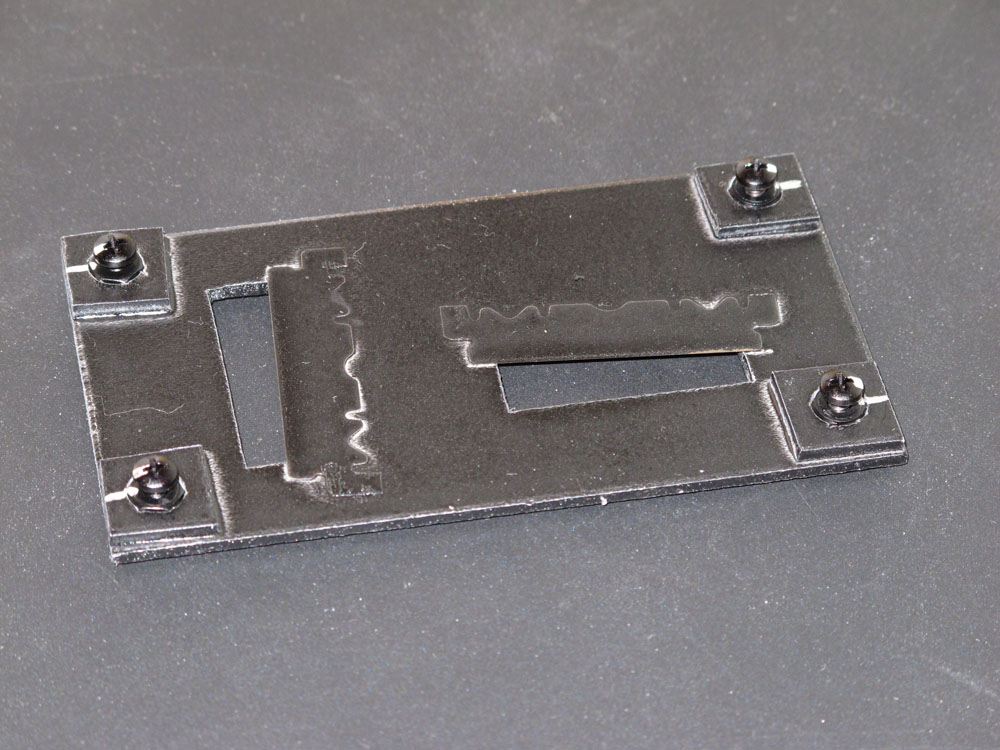

Here's a picture of the test jig.
--Greg

I am very interested but I have never done this and am a bit confused regarding the process. You scan the test jig at various locations and then use the software to assess the scan? Are there any website directions to explain the process a little more completely? Thanks for the work and the post btw.
There's no software that I'm aware of that does all the steps automatically. And no website that I'm aware of. I put this together from a bunch of different places. Here's a little more detail on my workflow:
1) With the jig at its lowest setting, scan both areas (for horizontal and vertical) at maximum resolution (6400 DPI) and save. I saved the horizontal and vertical scans separately, with exact cropping done in Vuescan. This makes it easier for analyzing with ImageJ.
2) Turn all 4 screws 1/2 turn to elevate the holder. Scan again.
3) Repeat Step 2 until you've covered the range of interest. For me that was 11 half-turns (5.5 full turns) of a 4-40 thread (0.025" per full turn). This is 0.138 inches, or just over 3 mm. Since my jig starts out at ~2.3mm, that made the final height 5.5 mm.
4) I ran the Slanted-Edge MTF plugin in ImageJ on each image, and copied the table of results from the graph into a spreadsheet. Separate sheets for horizontal and vertical.
5) At this point, you could probably just graph all the results together, and pick the line that is farthest to the right. Instead, I chose to find the exact MTF50, 10, and 5 points by interpolating the data, and graphed those. That helped me see how big (or small) the sweet spot for focus was, and I had a need for that data for something else.
It helps to play around with ImageJ and the MTF plugin to get a feel for how they work. You can start by just laying down a razor blade on the scanner glass, or across the 35mm holder, maybe. I'm not sure exactly how long those blades are. The key is to have it at just a slight angle. The international standard for this is 5.74 degrees (a 1-in-10 angle). But anything between about 3 degrees and as much as 10 degree will probably yield good results.
Also, I built a separate jig, but there's no reason you couldn't just shim all the feet of a stock negative holder. My concern with doing it that way was whether all the shims would lie flat enough to be accurate, once you started stacking shims.
I have reply notifications turned on for this thread, so I'll be happy to answer any other questions people might have.
--Greg

Keep these things in mind that if you're building a separate jig:
-- Make sure the razor blade is where the film would be, or make sure to compensate for 1/2 the thickness of the blade when calculating your shims
-- Make sure you measure the height of your film holder so you know how much to shim by.
This method would work great with a betterscanning holder...you've already got the screw height adjustment.
--Greg
I do have the adjustable better scanning holder so I will use that. Thanks

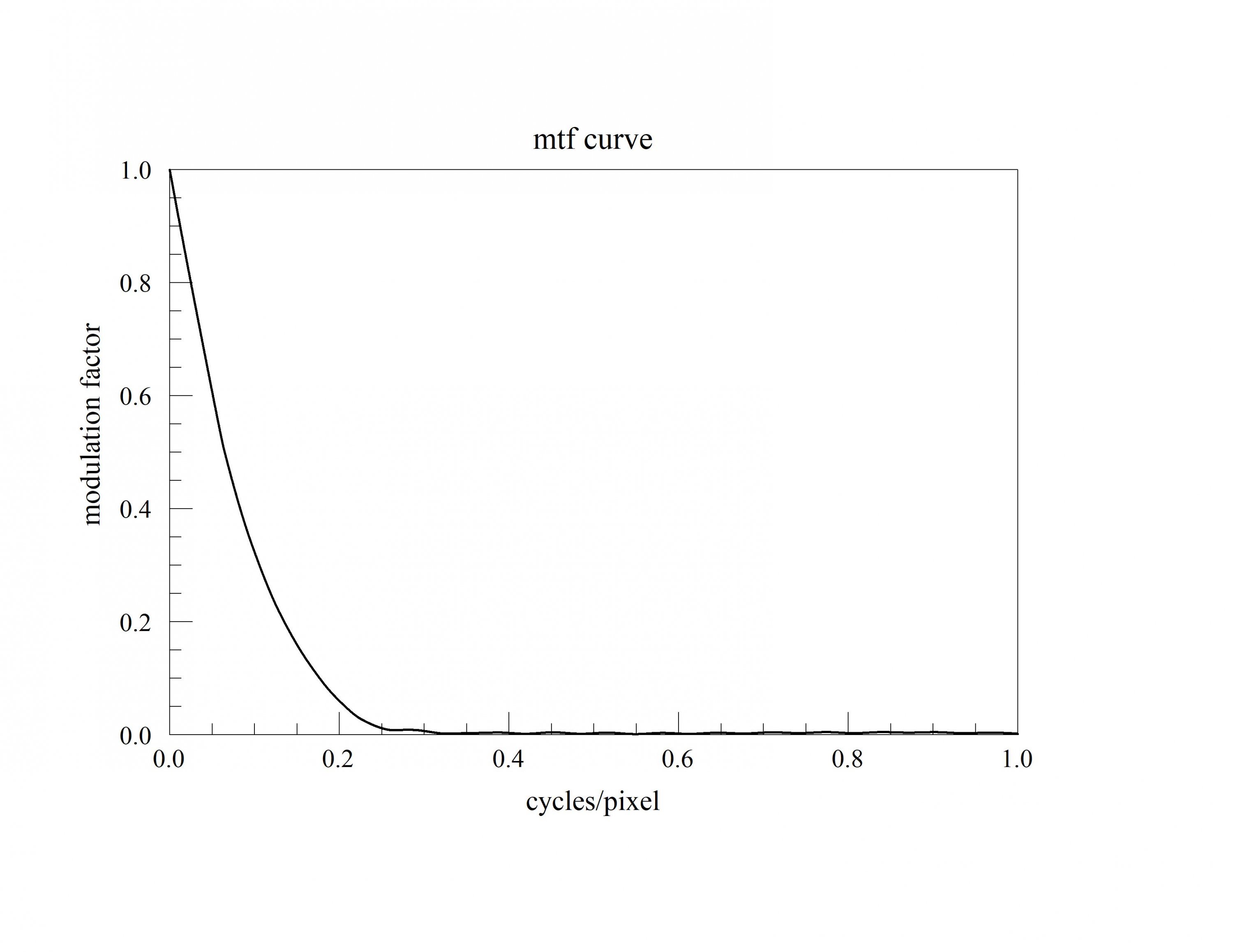

I read somewhere that if you select a spot on the mtf curve that is about 2% to 5% of the maximum of the curve then that could give a good estimate for the resolution. The spot on the horizontal scale that corresponds to full resolution (6400 dpi) is 0.5. The spot on the curve where the mtf was about 0.035 was at a horizontal position of 0.2183. dividing that by 0.5 and multiplying by 6400 gives approximately 2800. I am not sure how valid this calculation is.
Here is what the mtf curve looks like that imagej generated with the slant edge plug in.

By the way, I tried to post an image of an example of a slant edge image that I used, but I got error messages about the image being too big, even though I used rather extreme compression ratios when I converted the figure to jpeg.
I've run into this difficulty many times. I keep reducing the image size in PS until it will fit or Save for web and Devices will work without file too large notices. I then adjust for a 100KB to 200KB file size.
The MTF curve in post 11 is 3000 x 2317 at 72 dpi. A higher dpi image will require fewer pixels in each dimension to fit. A 96 dpi at 6 to 8 inches in the long dimension print size displays well.
