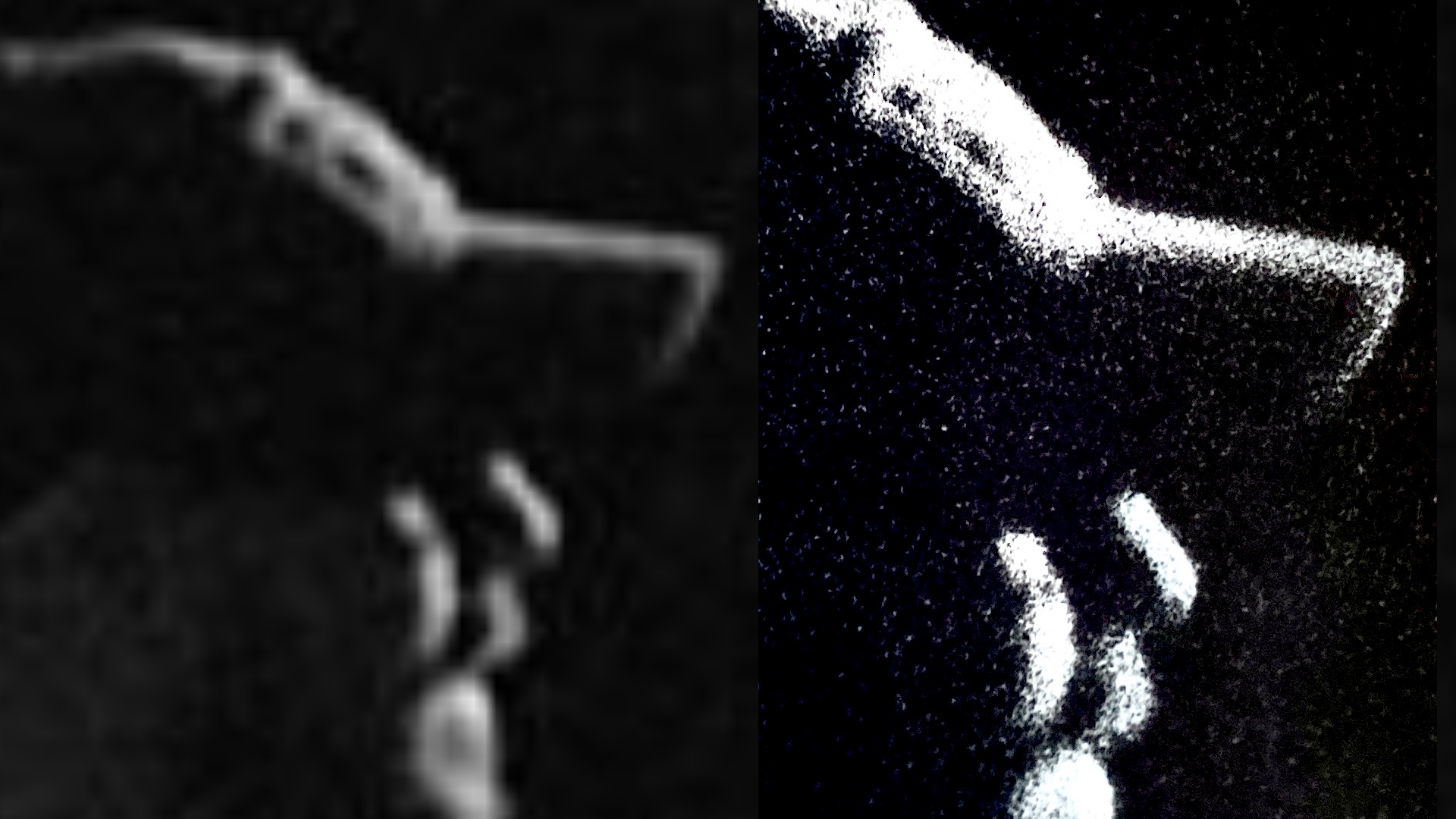

Here is 1200dpi scan at V600 vs darkroom print. The scan is 100% raw, no changes have made to it (expect the upscaling). It looks blurry because the low resolution. A 1200dpi scan doesn't have any chance to show the real grain that is visible in the print. There isn't just enough resolution for it. Even if I would double the real optical resolution to 2400dpi it wouldn't really help.
I agree that the darkroom is the best place to get detail from a negative. Is that darkroom print made with one of the 5mm enlarger lenses we were talking about recently? If so that might not be a fair comparison; in my experiments so far the specialty lenses adapted to an enlarger can show amazing detail of a small fraction of a negative, but can't capture an entire MF negative like the V600 can.
I would have argued against this if I would have not printed some negatives that I had scanned and compared. The grain just goes really smushy on scanners like V600. There is now way you can really see the real grain with V600. It looks OK if you don't know better but printing in darkroom makes it easy to see the difference. Also scanners somehow make some kind of own grain which is typically not that good looking..
Yes, this is my main point, and i previously spoke of doing exactly that test; the optical enlargement was so much better it really seemed like coming from a different camera and lens.
Again, it might be OK for many applications (i.e. internet posts). But for me it defeats one of the purposes of using film -- that crisp 3D detail that jumps at you on a print. And one of the purposes of digitalizing film: archiving.
Yep, night and day.

I'm not doubting the result of a test like that. I use a V700 and a darkroom, and the darkroom is the best choice unless I want to print large, or need to do a lot of editing to an image.
My point is that if we're trying to compare apples to apples, we wouldn't use a microscope lens on an enlarger for instance, one that can only show a few millimeters of the medium format negative, albeit at a fantastic level of detail. To be fair you'd need to pull that microscope lens out to cover the entire negative like the V600 does, and then crop/compare.
I don't know the lens Vedostuu used, maybe it's a normal lens, but my normal lenses don't resolve like that.

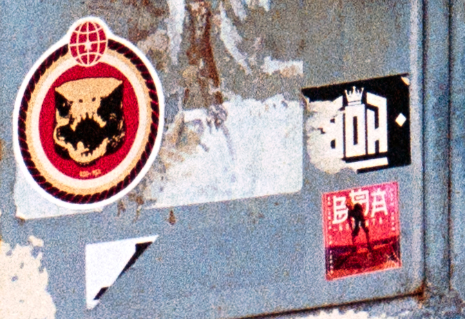

I wanted to share you the finding that I have personally found; grain is actually so small that scanners cannot resolve it like it is. Nothing else. I really don't know what scanner grain is; maybe it is some kind of more clumped grain, please enlighten if you know. I was personally blown away how I've always thought that the scanner grain is the actual representation of film grain and found out with my own hands that it isn't..
If grain is way smaller than what your scanner can resolve, then you don't see it. If the grain is bigger, at a certain point, the size of the grain gives away to the problem of "grain aliasing" which will give an artificial, exaggerated representation of the grain. Throw in the big levels of sharpening (as every epson flatbed user seems to do), and it gets worse. That artificial thing is what some newcomers to analog photography think is the real "grain".
DSLR scanning, with higher optical resolving power, is less prone to such problems.
Kodak Ultra 400 grain as seen by a macro lens on a 24MP camera on a 35mm negative. No additional sharpening whatsoever applied.
