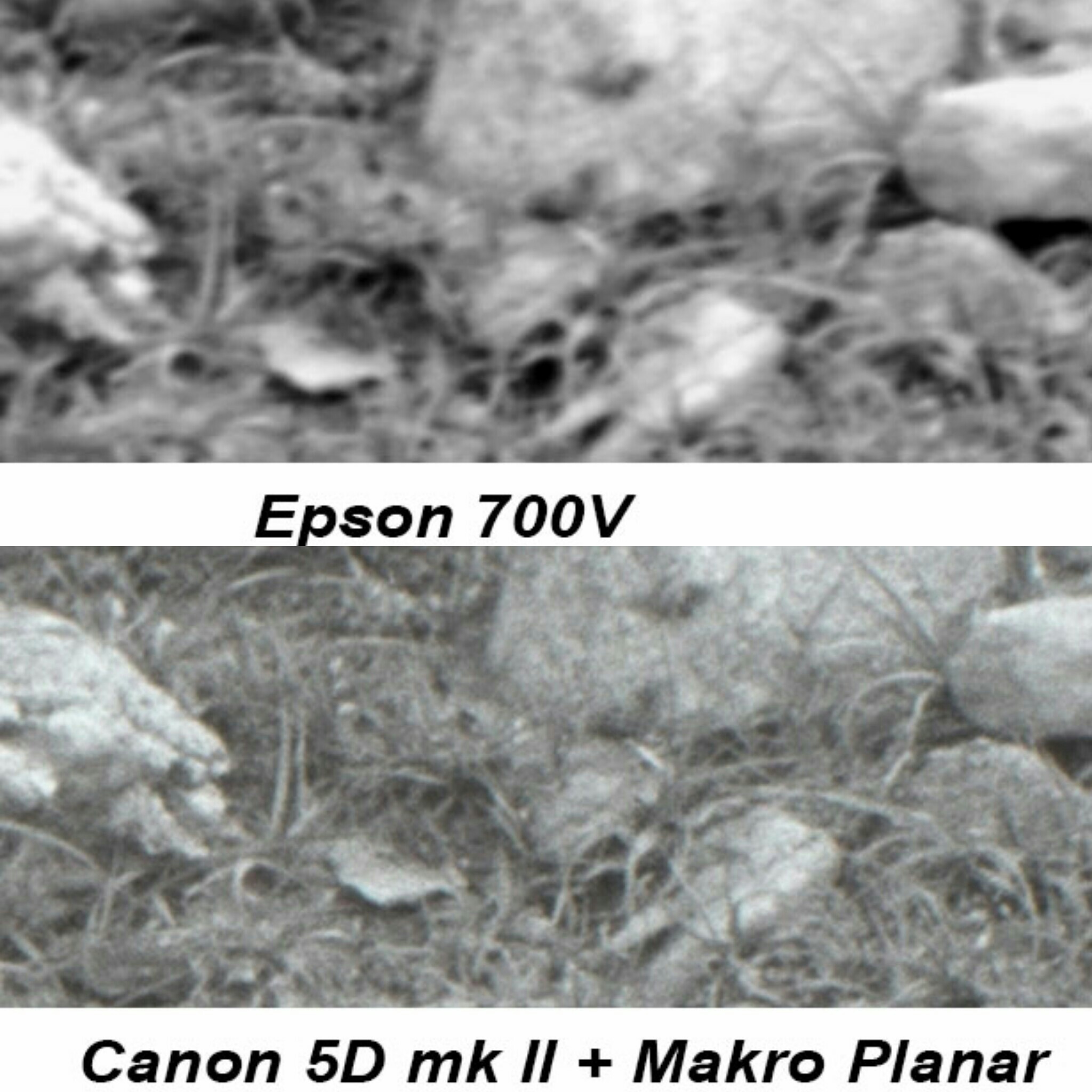

Just to illustrate my point --
Image sourced from the internet, but there are quite a few articles out there that do similar tests and reach similar conclusions.

You can't compare two images without knowing how they were scanned, how they were edited, etc. Especially two photos were taken from the web that you didn't do. It's a meaningless exercise that proves nothing..
It clearly says one was scanned with a Canon 5D mkII (with a decent lens) and the other with Epson V700. Why is that comparison meaningless? And why is your postal-stamp-sized scan more meaningful / representative of what you can expect from flatbed?
