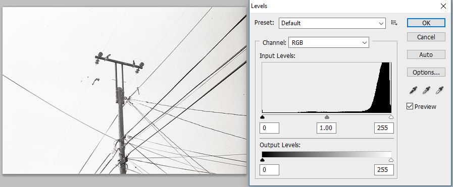

Short answer is NO. If the image scans with black at 10 and white at 180 with no color correction then turning color correction On, and manually setting the black to 10 and the white to 180 or what ever the points that information on the negative starts and ends results in the same information from the negative.
By having color control off I can tell if I'm getting correct exposure and if my development is correct.
Here is another example: Vigilant six-20 100mm f8.8 Diomatic shutter that runs slow after CLA. Sunny 16 exposure on Arista EDU Ultra 100 in HC110 @ 68°F for 6.5 minutes.
Blacks start at 70.

What IO believe I see in my scans is that with Color Correction of, the scan will cover the full range. The resultant picture will have a range on the lower end of the histogram - from let's sy 10 to 180. Then in LR or Elements, I expand the range to 0-255 using the points or Levels.. The result gets me about 95% of the corrections and I tweak from there.
My questions is do I really get more data by pre-adjusting the white and black points (levels) to 0-255 for the scan. Or am I already getting the same bits of data anyway since the range falls into it with as per my example of 10-180? (Note that the scan file size is the same in both cases).
With auto exposure ON the black and white points are clipped. With No Color Correction black is set to 0 white is set to 255. If the tone information starts at 10 and runs to 180 you get a flat line from 0 to 10 and a flat line from 180 to 255.
If you set the black point to 10 and the white point to 180 you get the same information as the 0-255 scan as 10-180 is all the usable information there is.
You can set the Levels in PS to 10 and 180 and have the same image as setting the B&W points in scan software.

Others have made the argument that if you set levels from 10-180, rather than 0-255, you will get additional data since you won't waste data on the non-data areas 0-10 and 180-255. What is the truth about this? Is there a way to prove it one way or the other?
I have never heard that. Scan several negatives with both full tonal range and with the 0 line section eliminated (B&W points set) and compare the resulting scans for both adjustment latitude and fine detail in the image.
