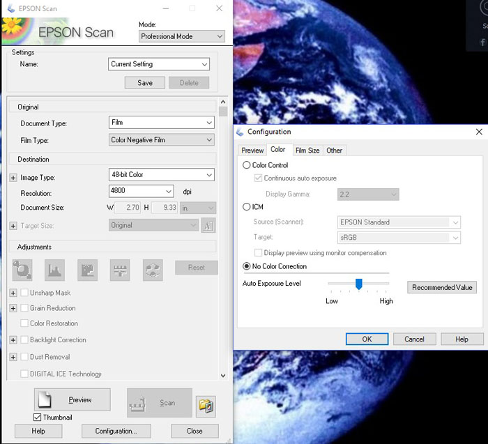

Clicking on the Configuration box at the bottom of the EpsonScan Professional page gives the box on the right. Clicking on the Color tab and selecting No Color Correction gives a basic scan with no corrections. Continuous Auto Exposure resets any settings you have made every time you press Preview with Color Control selected. With Color Control selected the histogram is always clipped at each end, but with Continuous Auto Exposure deselected you can set the 5 adjustments on the settings page for the best scan for a group of negatives without them changing when you press preview or advance to the next frame.

With Auto Exposure turned on EpsonScan sets the White and Black points inside the range of usable detail a small amount to increase the contrast in the main part of the image.
With auto exposure turned off you can set the points as you wish and with color control turned off (as in post 29) the white is set to maximum (255) and black is set to minimum (0) with the mid point the operating system gamma..

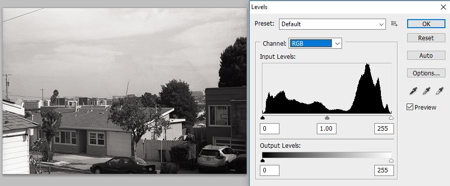

This example was scanned on a V500 @ 6400 dpi 48 bit color (16 bit RGB per channel), with color correction off.
The master file is 1.66gb, it has been reduced to 150 dpi in PS Bicubic Sharper with its histogram in Levels captured with Advanced System Care's built in screen shot saved as a jpeg. No other editing.
Vigilant six-20, 105mm f6.3 Kodak Anastigmat, #1 Diomatic shutter, Arista EDU Ultra 100 in HC110 for 6.5 minutes at 68°F.
Smoke from the Northern California wild fires 75 miles north of the photo's location. It got worse two days later.
The example is both over exposed and over developed.
The rise above the base line is usable information, correctly exposed negatives start the information rise between 0 and 10, this one starts at 0. The fall to 0 beyond 255 is over developing. Normal development with whites correctly exposed drop to 0 between 225 and 255. Over exposure is 1/4 to 1/3 stop, over development is around 10%.

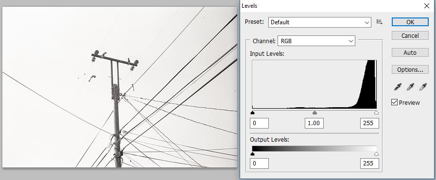

Here is another example: Vigilant six-20 100mm f8.8 Diomatic shutter that runs slow after CLA. Sunny 16 exposure on Arista EDU Ultra 100 in HC110 @ 68°F for 6.5 minutes.
Blacks start at 70.
