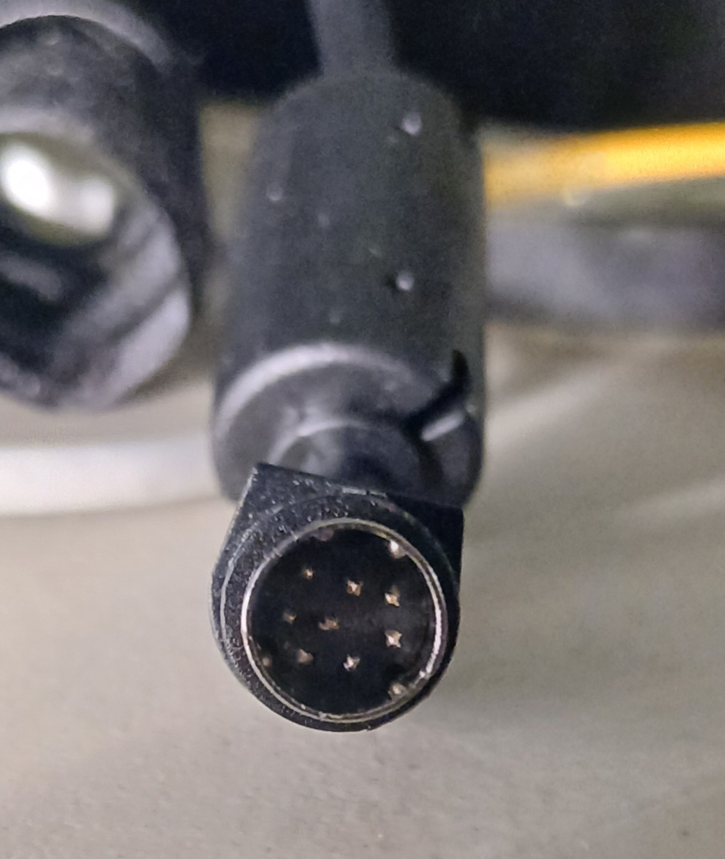

Could you please disconnect the lid from the scanner and upload a photo of what the connector looks like, when looked head-on at the contact surface?

Thanks, that looks good to me as far as I can tell without holding it in my hand. Can you verify none of the pins is squashed or severely vent out of alignment?
Could you re-try connecting this to the scanner, carefully observing correct alignment of the connector?

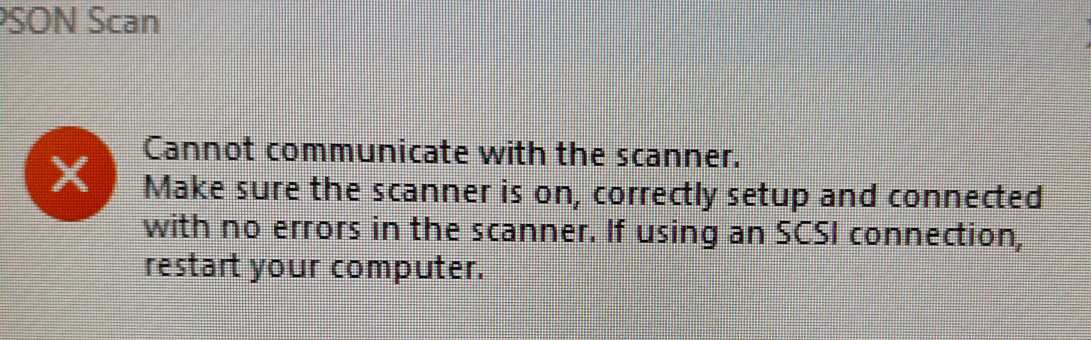

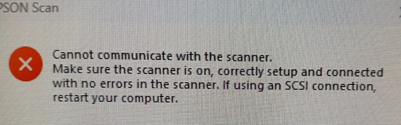

pins appeared to be in alignment, "scanner type" sounds, no clicking or rattling. Flashing red light and this message

I assume the error message you posted does not occur ever if you operate the scanner with the lid disconnected, correct? In that case, the error message is likely the result of the scanner itself reporting an error back to the scanner driver, which translates it into a generic error message towards the user. Sadly, this message isn't very specific.
