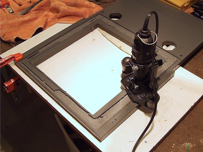

Yes, I can't believe they were actually using that. My suspicion is that when the lamp was new it was better. About ten years ago I had a thread over at Large Format Forum on how I improved it, but that head is long gone. The guy that bought it put a new lamp in it. I'm using a CLS2000.
