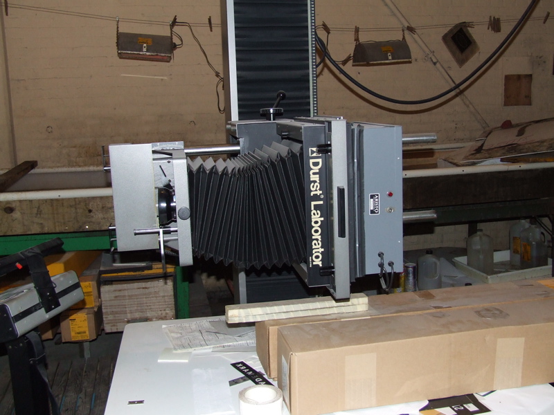

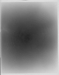

    Well said. Here is my enlarger when I picked it up from a graphic arts house. It was used for lith separations.
    Here is the test print, with no negative, exposed to usual continuous tone photographic paper. The print shows the light falloff and hot spot in the center:

    You can get rid of the hot spot by grinding a diffuser which is thicker at the center than the edges, by making a double-diffused light mixing box, by using a dimensionally oversized light source, and choosing a longer than "normal" enlarging lens. There are fancier options too. But as far as "stitching" goes, I saw an immaculately detailed print 20 ft across which NASA made of the back side of the moon. A technical masterpiece with a huge budget behind it. But frankly, I'm more impressed by a Weston 8X10 low budget contact print. Big for the sake of big leaves me cold.
