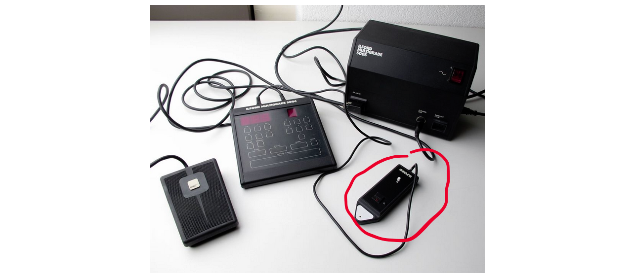

Please provide specific information on the enlarger and/or multigrade head you're using. Post a photo of the actual setup if you can.
For the popular Ilford 500 system, a light meter is/was available, but it was an optional accessory. I've come across it once or twice, but most setups I've seen, didn't have it.
Here's an example of an Ilford 500 setup without the actual exposure unit/light source. I've circled the metering probe. Also pictured is an accessory foot pedal. Like the probe, it's often not included in the setup.
Note furthermore that Ilford to the best of my knowledge never made any enlargers. But their variable contrast exposure systems are quite common on the second hand market and could be fitted onto several enlarger frames. There are several versions of these units, hence my question to you to please specify what you have there.
