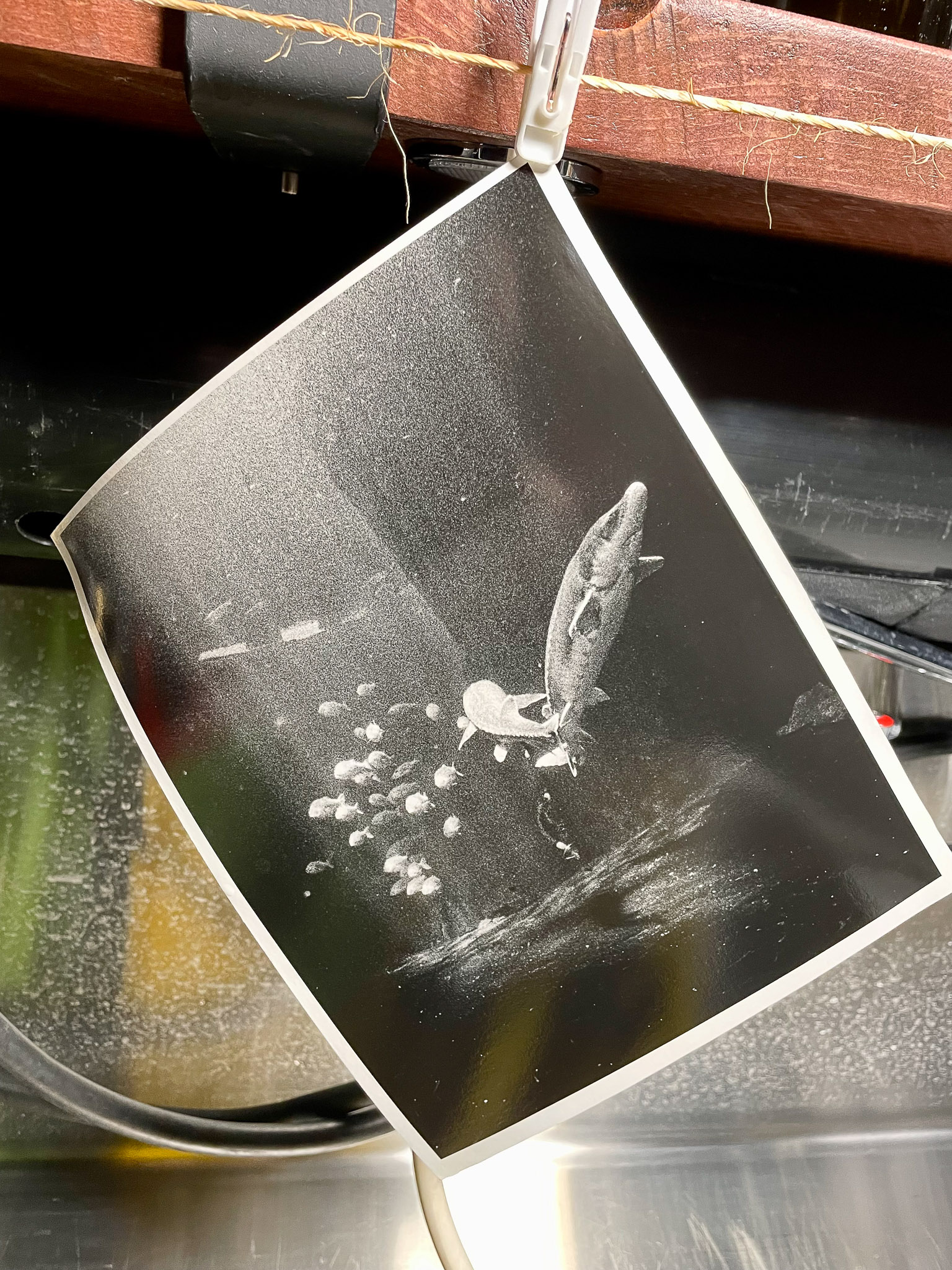

To bring some closure to this thread here is the print I was working on when I asked for advice. It was shot with a Nikonos III using Delta 3200 at 6400.
Will try glass carrier sometime soon. Thanks for the focus slack fixing tip. And thanks @M Carter for the DIY adjustable lens board!
Thanks to all for the inputs!

Your underwater photographs with your Nikonos III are better than mine with the Nikonos V.
Thanks a lot!
I adopted a simple and lazy method in this case. I was shooting with ambient light in a low light environment. I just shot wide open at 1/30 the whole time and did a stand development in DDX. Kind of auto-iso P&S.
