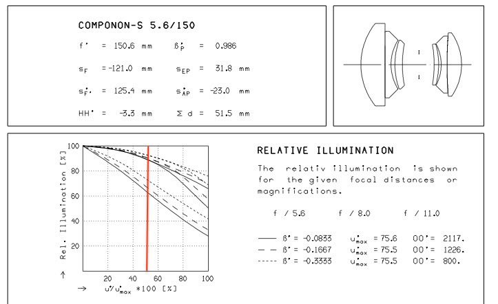

It is the other way around.
Red line indicates relative illumination at the corner of an 80x80 negative compared to the center at varoious aperture numbers at high and low magnification. Even wide open the falloff is the same as stopped down with 4x5" negative.
