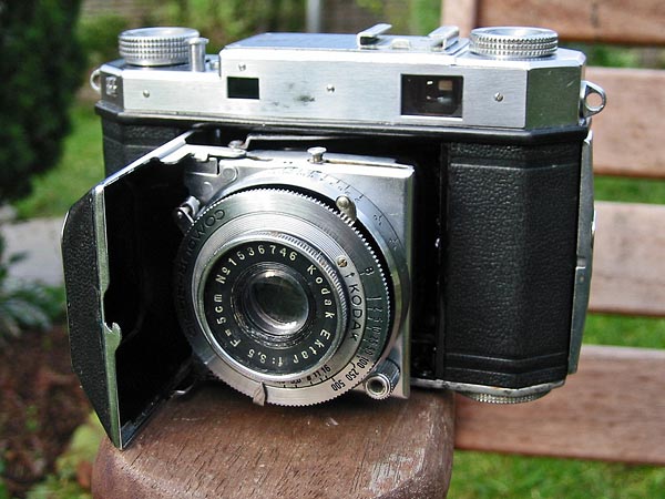

We're these Ektar lenses from Eastman Kodak in USA or were they relabeled Schneider lenses? And why is the 47mm version special?
The pre-war and wartime 3,5 Ektars are Schneider lenses. A few Retinas after the war had american made 3,5/50mm (marked "Made in U.S.A.") and 2,0/47mm Ektars.
The 2,0/47mm Ektar = The faster top lens, made in the U.S. which many americans like, and since most (or all?) of them where sold in America they are attractive for European collectors as well.
The f3.5 Ektar is of uncertain origin. I can't say if its a Rochester product, or a rebranded Schneider lens (I suspect it is). Many of the so-called Ektar (and Anastigmat) lenses on the Retinas were rebranded Schneider products.
The 47mm Ektar lens from Rochester is a genuine Kodak product: it has a CAMEROSITY serial number on the front dress ring. Most on the Retina II's are either 1946 or 1947 lenses. In my experience, these are similar in performance to the Schneider Retina-Xenon in most ways, except "bokeh": the 47mm Ektar has very Petzval-like bokeh when used wide open, or maybe as far as f4.0. Otherwise the 47mm Ektar isn't any better or worse than the Schneider or Rodenstock lenses on these Retinas, it just has a bit different "feel" to how it renders images.
People tend to value the Retina II with the 47mm Ektar way more than the other lens version, citing its "rarity" as the driving force behind its price. (Expect to pay $500. for a good example) But the truth is that there were approximately 4000 of the Retina II made with the 47mm Ektar lens on them, so its far from "rare".

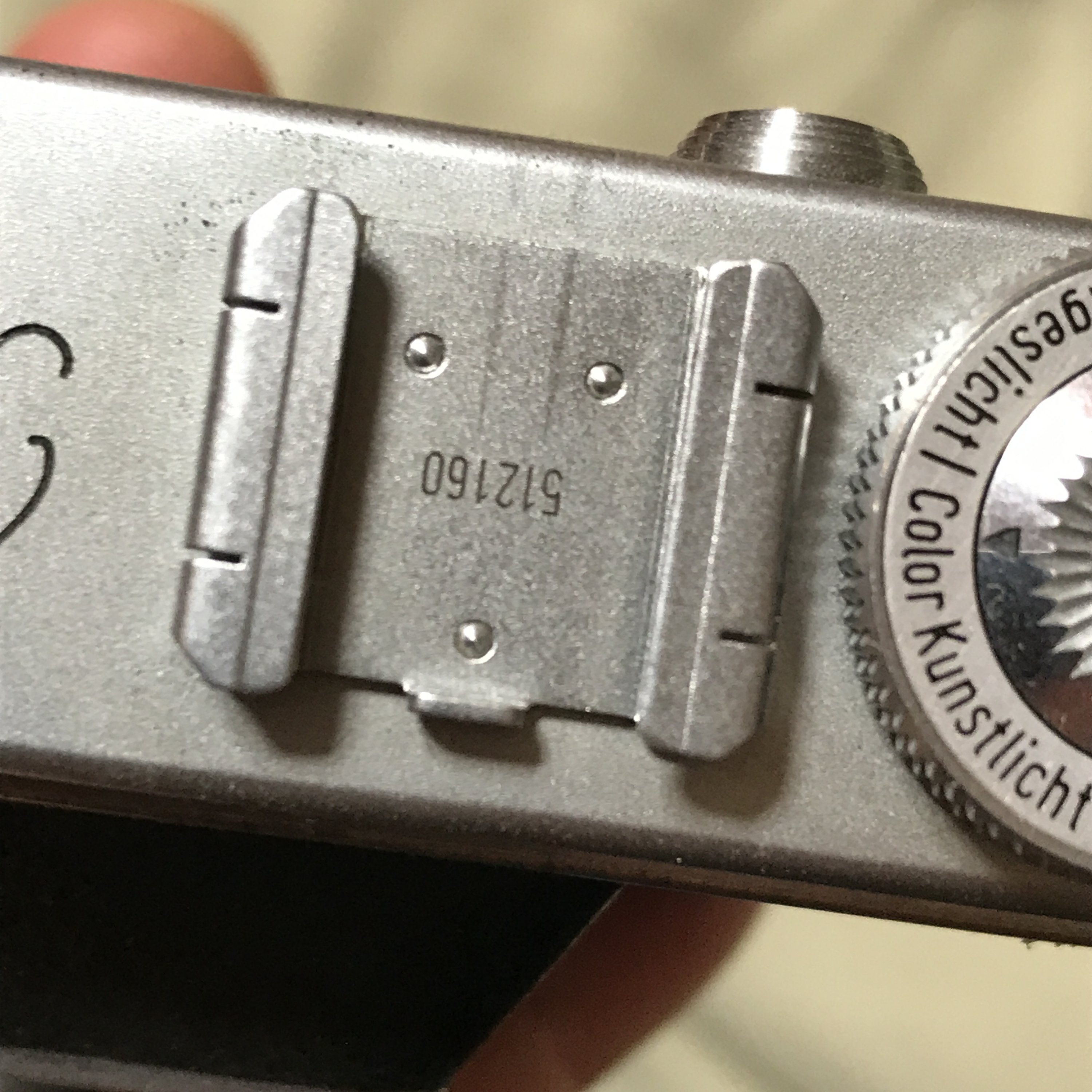

If you have a IIa, and the accessory shoe is mounted FROM INSIDE the top cover, there's a very good possibility that one or more of the mounting screws have fallen off INSIDE the top cover, and fallen into the film advance gears. So first things first, look at the accessory shoe and see if the screws mount from the outside (you'll see the top of slotted chromed screws) or from underneath, in which case you'll only see the tiny ends of the screws visible.
Attached photo shows what the accessory shoe looks like if the screws mount it from underneath the top cover. If there's a blank hole in one or more of these places, the screw is loose inside the top cover.
