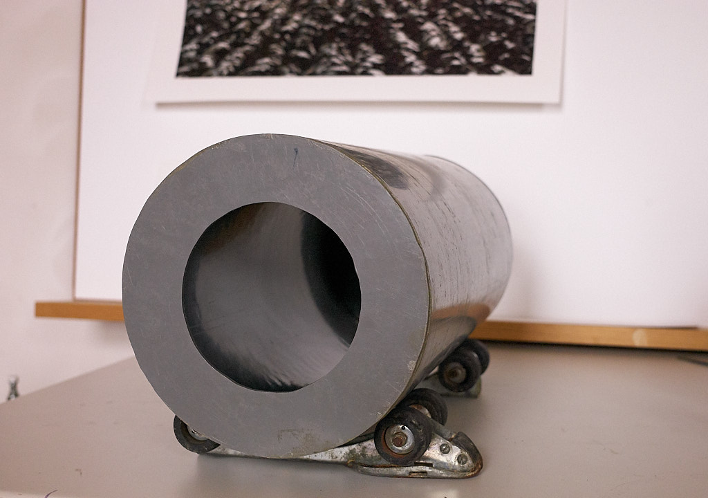

I did prints. to 120x200 cm this way. The hard part is washing the print.
