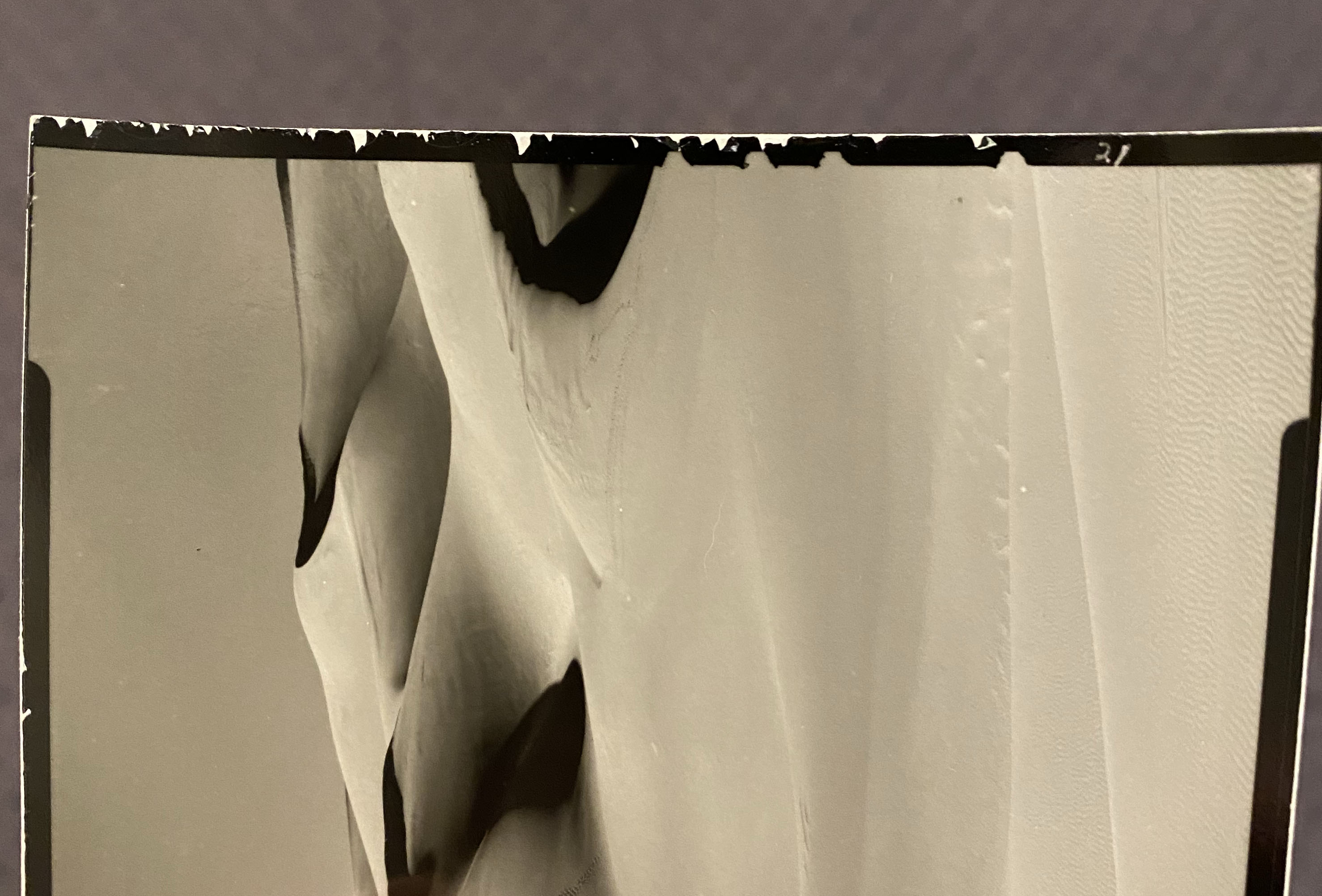

During processing of fiber paper, I'm having a problem with the emulsion flaking off the edges. I think it is happening while sitting in the holding bath waiting for the second fixing bath, toning, etc. It's happening with Ilford and Foma paper, and it happens regardless of using an acid or alkaline fix. Mainly, I notice it when I contact print large format negatives so the edge of the paper is black.
I'm wondering if the water in the holding bath is causing the issue (I use tap water), but I can't seem to find that anyone else has this problem. Any thoughts would be helpful.

I was plagued by this problem, hundreds of sheets of Ilford paper.
you should contact their customer service department and send photos of the problem like like you posted.
when I did their response to me was confusion and then
"do not print to the edge and to trim off the flaked parts".
I know . bad response. I hope theirs to you is better.
How long are you leaving the paper in the holding bath? The only time I've ever had this happen with Ilford paper is when leaving prints in a water bath for several hours waiting to be washed. Once I stopped doing that my prints never flaked at the edges again.
Ilford gave good advice. It is mechanical damage to the emulsion on the cut edge (can be made worse by a long soak).
Keep it white and one won't notice it.

I had put it down to emulsion cracking when the factory cut down rolls of paper into individual sheets.
If the flaking is always on the same edge of the paper then I'd say it was more evidence of a problem at the factory. Ilford's advice to print with a white border or trim the print may be as good as it gets.
Good point, Nicholas. Though in theory, the factory has to cut at least two sides, and usually three or four sides, off the main roll to make sheets.
It also might pose an issue if using a dull cutter at home.

That doesn't look like it results from the emulsion being brittle. That looks like the edges swelled due to soaking too long, so swelling the paper and splitting and peeling the emulsion.
It is not a bad idea to trim edges of a print...especially RC. Chemicals enter into the cut edges of the paper/emulsion and are difficult to wash out.
Yup, that's why I asked in post #3 how long the OP was leaving the paper in the holding bath. But I don't think he's visited since starting the thread.
Extended soak times aren't ideal for any paper - particularly incompletely fixed paper. It sounds like the OP is using the paper in a way that is outside the recommendations of the manufacturer. So if it is a necessity that those extended times be employed, other compromises may need to be made.

To the OP - have you tried a brief wash after the first fixing bath, and then hanging the print to dry temporarily? That may prevent the damage, and shouldn't make it any more difficult to later wet the print again and precede with the second fixing bath later.
I hope it's ok to post this since it was sent to me in a private email from someone at Ilford, but there's nothing particularly private/sensitive in it and it might be useful information for anyone having a similar problem to the OP (as I was):
The issue you are seeing (we call it edge frilling) - is virtually always linked to the paper being washed for too long. FB papers are very fragile and we really only advise washing MGFB Classic for between 30-45 mins.
If its washed for a lot longer than that - as the paper gets very soft, it simply can lead to the emulsion lifting of along the paper edges. It can be triggered too - if the paper edges are in contact with other sheets in a washer (ie if a lot of paper is attempting to be washed in a small sink), or if water is running fast and the paper is swirling around a lot and hitting the side of the washing tank.
Our advice would definitely be to not leave paper to stand in water for anywhere near as long as you are doing. ie 5-6 hours would definitely soften the paper way more than its designed to cope with - especially as your final washing method in an archival washer, will tend to be fairly vigorous/long too.
Ideally we would advise that any prints made, simply go from the fixer tray straight into their final wash method container (ie your archival washer - or a sink) - so they are not having to stand in a waiting tray of water, as it really is likely the time in the waiting water tray, thats causing the problems.
I appreciate it might be difficult for you to do this, so can only suggest try to keep the waiting water tray time as short as possible, and maybe just stick to a max of 30 mins in the archival washer - instead of the hour you are currently giving. (Thats assuming it has quite a good water flow).
I hope you are now able to eliminate it happening - from the above comments.

I might be misunderstanding you, but 'frilling' and edge flaking are the same thing. Ilford seems to use the term 'frilling' for what we've been calling flaking. Their response was to my question about flaking.

Frilling is caused because of mismatch that occurs due to excessive swelling/softening of one of the layers with the other layer being relatively rigid - the former being gelatin in this case.
Flaking is caused further as the paper dries and those frilled edges have created a source of cracks and de-laminated emulsion from the base which then comes off in flakes.

Which is what happens, due to excessive absorption of water at the edge of the paper - the paper adjacent to the edge doesn't absorb as much. So, at the edge, the paper has linearly expanded but is restrained by the field of paper, which has not, and so gets wavy. The emulsion, however, has not linearly expanded so releases from the surface of the paper.

Isn't it possible to do an archival wash after exposure under the enlarger of FB as per the Ilford instructions on the 5-10-5 basis of 5 min wash; 10 mins washaid and 5 mins wash so that's 20 mins plus if it suggests a total of 30-45 mins in water this allows for up to 25 mins in a holding bath or a bit longer as Ilford clearly indicates that this 45 mins is a conservative limit
If you need to store exposed paper, how about storing it dry in a paper safe or box? How long before the image fades?
