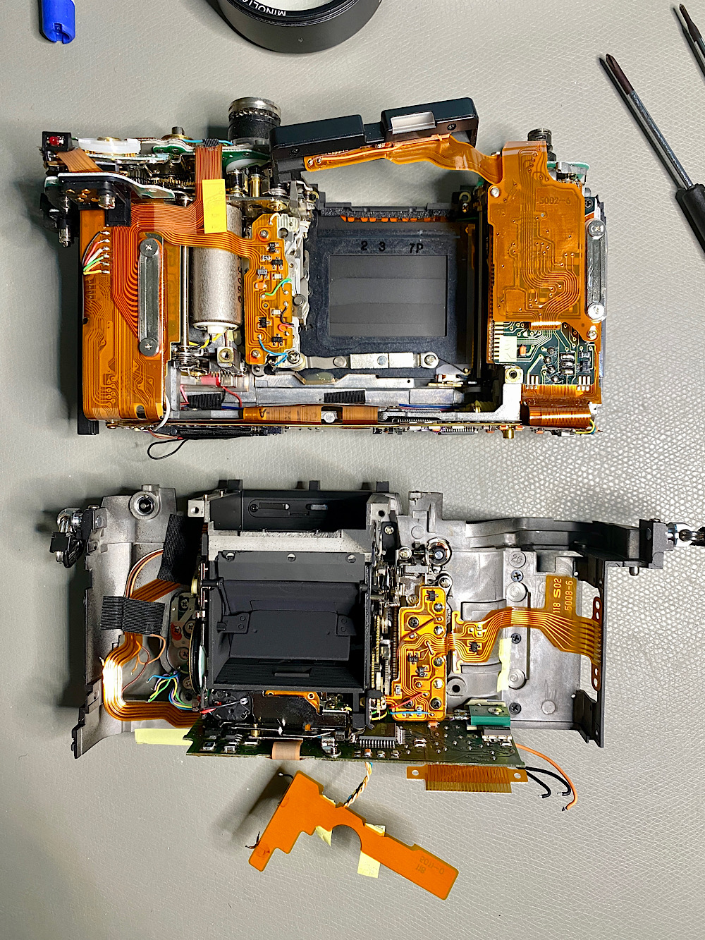

I have a Nikon F4 I got as I gift from a friend. In almost perfect working condition, but the teeth in the take up spool were all missing. There’s a thread here about it.
Long story short: I took two F4 bodies a technician, so he could use the spool from one of them to replace the other, but he decided not to disassemble any cameras He just made metal pins and put the on the working camera’s spool.
This camera sometimes doesn’t advance film. It’s like the end of the film’s been reached, but it’s not. It takes capping the lens, turning the camera off and on, then firing a couple (or more) times to have it advance.
I have no idea how and who could fix this. I am not sure if electric motors get ā€œtiredā€ with time or if it’s just dirt or gunk. Anyway, most of the camera must be disassembled to reach the motor… and no one seems to want to do it.
This isn't the solution to the problem your F4 is experiencing. But disassembling the camera to that extent is doable; there are instructions that should make it possible for anyone willing to get started:
Even if the F4 looks like a battleship šŸ˜‰
I don't understand the thing about covering the lens. But if the motor isn't running, you should be able to hear it.
