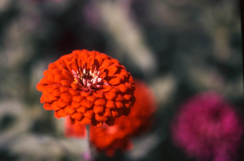

UPDATE: Raising the temp helped. I manually set the ISO of Provia 100F at 40, Used auto bracketing of 1 stop with Nikon F5. Ran the whole process at 80 F up from original 75F. The film is still drying but there are some decent looking shots, much better than the first roll. It's still underdeveloped but I'm just pulling the film speed, colors look quite good. I think the next roll I'm going to set the speed at 32 and bracket 1/3 EV. That will give me ISO 25,32,and 40. I will pick the best speed and shoot a final roll at my "personal film speed" and probably call it good.
I'm shocked that I'm getting this good of a result from something that is so old. I think the chemicals are as good as they were when they were new. If I had enough chemistry and could keep raising the temperature and I think I could get to the film's rated speed. I've been lucky so far. The clock is ticking on the solutions I think I have about a week total from the time I mixed them. The CD will go first, I've been keeping the bottles full and using the Developers as a one shot. I don't want to mix the used developers with the virgin. The Jobo must be oxidizing the developers. I would hate to be doing this without the Jobo machine, it would get old standing there agitating a Nikor tank.

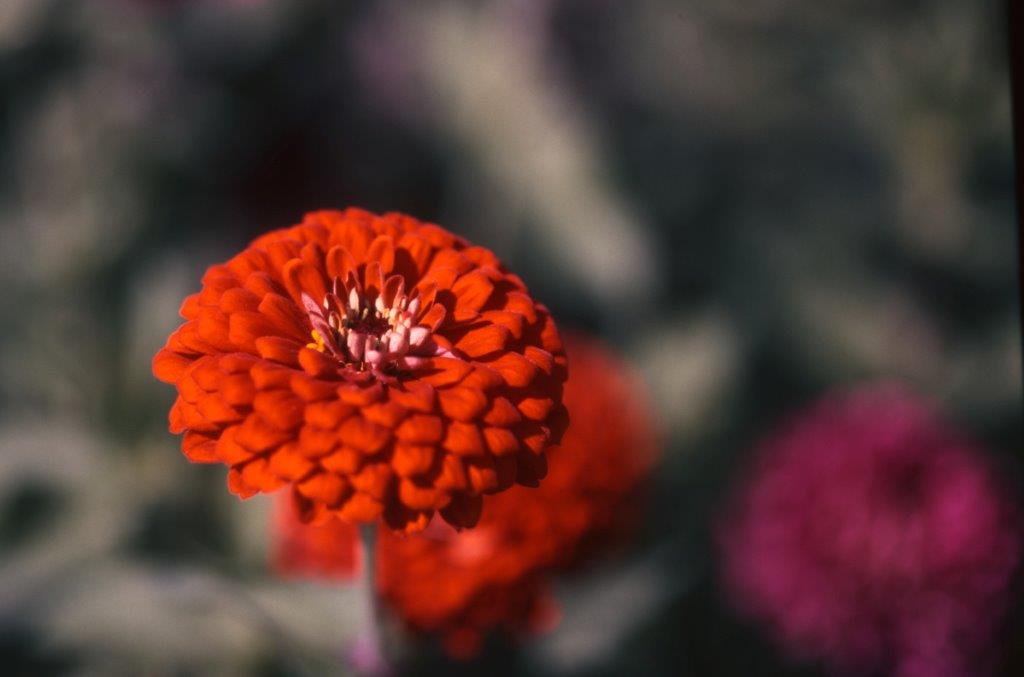

Here's a 80 degree F, ISO 40 shot scanned with my antique Coolpix scanner Unaltered. I don't know much about scanning this scanner is dead nuts on with old Kodachrome , The slide looks a little better than this scan. I shot this with an 85mm @ f1.4 thus no depth of field . I wanted to isolate the color. I still am amazed that this stuff works at all.

In my opinion, now that you’ve made the first development with the kit, you have a starting point to begin with. I would not shoot doing bracketing on the next shots (unless you want/need to), thanks to you now (& the kit) that you have an "rough" idea of how to deal with the film results.
I (we) can see that you are doing this for fun (or experiment), but now that you have let the blindness an uncertainty behind, you can go further getting both: fun & target.
Temperature: You’ll have to find out the “ideal” temp. for your kit/film (as you could see, mine was 77F, although I started with 68 …), but first thinking that the kit “was made” in “those days” for “those films”, besides the fact that the kit is in such state of conservation, what forces you to act other”wise”. So, increasing the way you’re doing, sounds “pretty” go to me. However, keep in mind that the first developer may have been the problem, not the temperature itself. I don’t believe it is a crime to use another fresh developer (doing that first job instead), just to experiment, just to try (worth it as a suggestion?).
About the risk of reticulation or wipe the emulsion out from the base, I think that nowadays is not so easy, modern films are not the same as the old ones (unfortunately, Oh those old days!!!) so, to get to such serious situation the temperature need to be extreme, as harmful for the film as for the chemicals (besides modifying the estimated working time as well)
Anyway, all this literature without knowing what was the process line you’ve made, and without some previous “questions” unanswered ... (T&T)
Happy hunting.

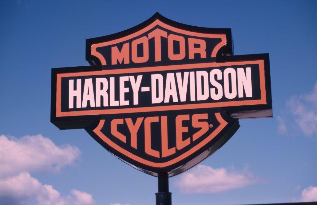

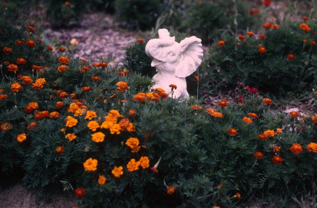

The End of a Successful Experiment. Shot my final roll today ISO 32 in aperture priority auto with auto bracket 0.3 EV. Very good results. VERY slight magenta cast to whites. But all in all a fun time. I have properly disposed of the chemistry cleaned everything up. No CD stains on anything chemicals had another 8 or 10 rolls left in them if you lived in the 50's and were so inclined. These are all straight scans off my Coolpix no Photoshop etc. The sign is in the sun. Others are with Sun behind clouds on otherwise sunny day. This little Kit did a Great Job. I cant believe what people went through in the "Good Old Days" to make a color photo to have color separation negatives made etc. This is a good way to end. aurevoir beauté
