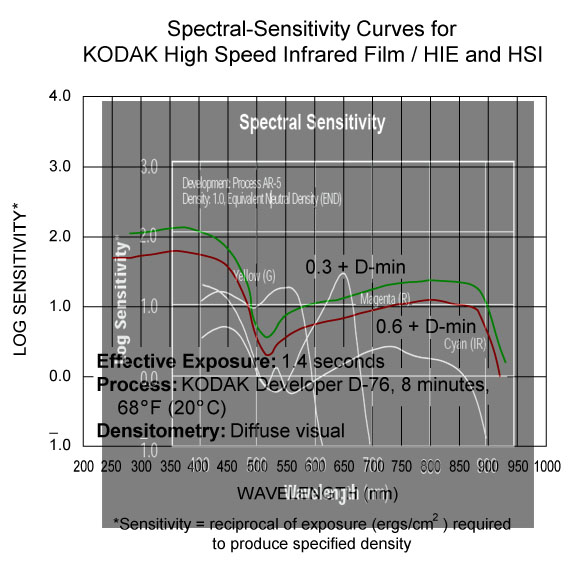

From the technical data sheet: "SPECTRAL SENSITIVITY KODAK AEROCHROME III Infrared Film 1443 is sensitive to ultraviolet, visible, and infrared radiation to approximately 900 nm."
So, yes, its IR sensitivity is *about* the same as HIE. Reproducing the halation effects is a different matter.
See attached graphic with the two spectral sensitivity charts overlayed on each other.

Well then, I was wrong, sorry. But OTOH, see the dip in sensitivity at about 500 - 550 nm. This goes to my post in another thread on quality testing of IR films. This hole allowed dim greenish safelights to be used to examine the film under some conditions. I can verify this if anyone is interested, and probably come up with a sensitizing dye structure FWIW.

Amuderick,
To be precise, from comparing those two spectral charts one can only directly conclude the proportionality in IR response of the two films.
The speed is different in both charts and related to two different aim densities. If I interpolate to neutral-density 1, and I’m not sure whether I just might do so, the HIE would be one stop more sensitive.
EDIT: it schould be `transpolate´ or something like that... I guess you'll get the point.

Amuderick,
I know people shoot and develop HIE in many different manners, but I've had best success rating both of these films at ISO200. It must be my HIE development strategy that slows it down? I find that it's too grainy at 400.

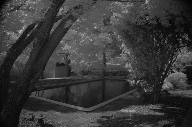

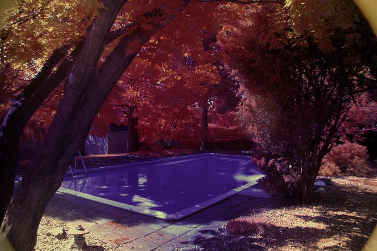

If you look at the spectrogram referenced by AgX, you will see transmission of a crossed polarizer out to 1000 nm. What is not clear is that to get this deep blocking of light, you need to cross two of them (of the exact same type). This blocks no deep red, it is blocking all visible light and allows deep IR. The filter is visibly neutral but virtually wide open in the IR. If you use one of them to control reflections, you get an overall blocking of reflected light and little blocking of UV or IR.
In fact, the filter has about than 50% transmission at 900 nm, which is IR. This is not red. In fact, you will only lose about 1/2 of the light at 900 nm and have complete transmission at 1000 nm. That is a lot of light. Actually, I used a cross polarizer to block visible light with a digital camera and take quite good IR photos with it. If you partially block the visible spectrum, you then can get an EIR type effect combining color and IR using digital.
So, a pair of polarizers can be set to achieve any density neutral density you wish when crossed but be open in the IR region, and a single one is the normal type used on cameras which just merely blocks out unwanted reflections.
With sincere apologies, since EIR is not available I have shot the following:
Left picture, crossed circular polarizers
Middle picture WR IR filter (deep red - #87)
The rightmost photo is the normal (digital) version.
Both shot with a Nikon D70 to illustrate this situation more clearly. It probably belongs on the hybrid forum and if so, demote me and banish the post.
BTW, the circularly polarized filter was not invented for the digital camera, but came into its biggest use there due to problems with linear polarization.
With apologies.
PE
