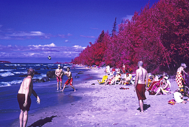

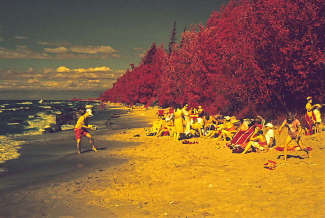

This thread prompted me to post a couple of my favorite EIR shots. Rated @200, the first is with yellow filtration, the second with orange. I've tried no filtration, and am not happy with it- way too much magenta/red. I've also tried green, but it didn't work out- it was waaaaaay dark- not sure if it was underexposed (I thought I applied the correct FF), or if the subject matter was not a good choice for green....
Tim
