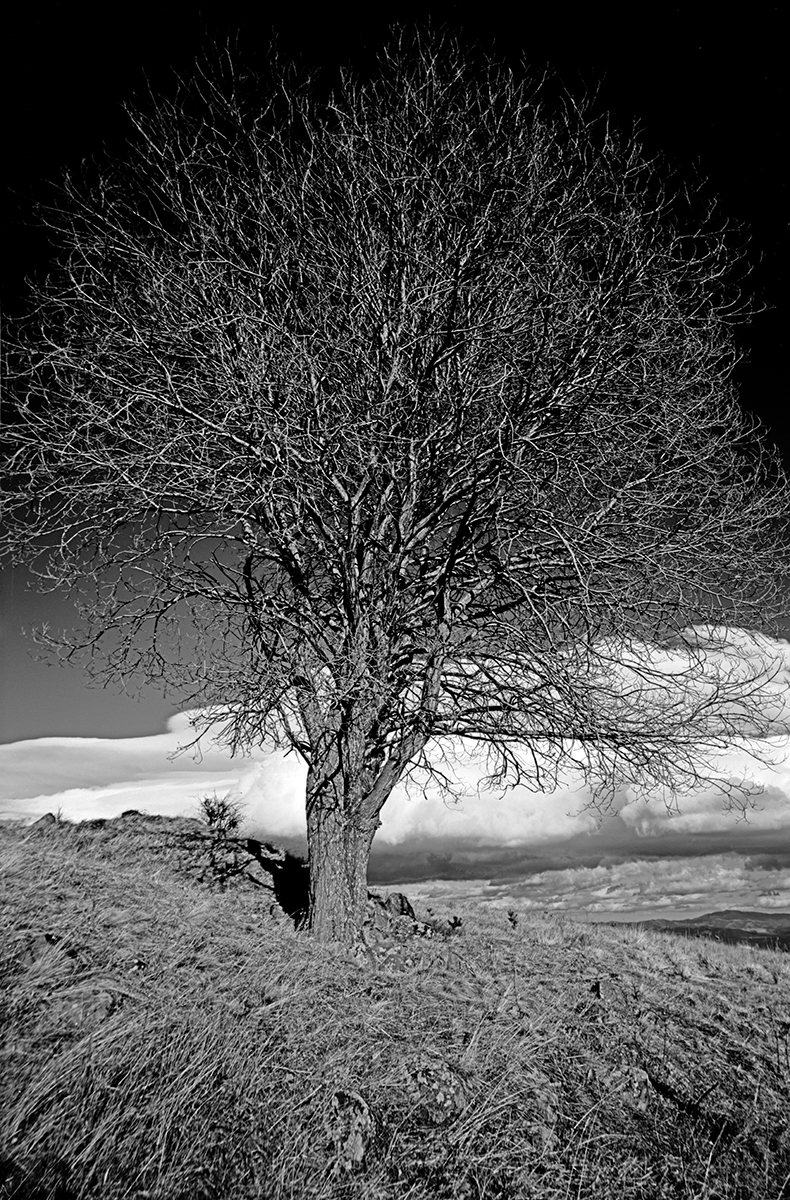

Also, here is one daytime shot using Adox CMS 20 + Yellow filter.
Wanna bet that with panchromatic film + Yellow filter it will look way too flat?

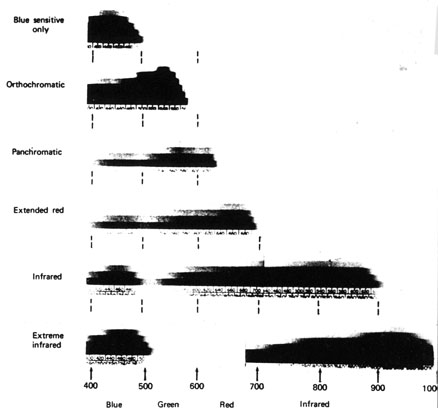

ortho-panchromatic is telling us that the manufacturer ran out of red sensitizing dye :D
Typical examples of ortho-panchromatic are Fuji Neopan Acros 100, Adox CMS 20 and whoever join :wink:
Let the attached spectral sensitivity curves comparison do rest of the talk :smile:

At Kodak we would be more precise using the terms short red pan sensitized or long green ortho, so that the term was clearer (I hope) than this one.
PE
You are welcome!
Yes, it might be clearer saying short red pan sensitized but orthopanchromatic is what those manufacturers decided to use.
I quoted what those folks at Fuji and Adox writes in their Tech data pdfs, the Kodak and Agfa curve graphs are there for the sake of comparison - if possible :wink:

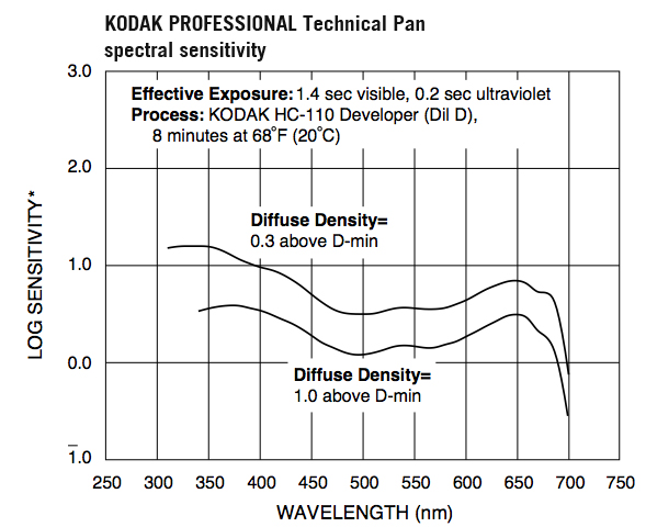

What did you call Technical Pan instead of "Superpanchromatic"?
Not having a spectral sensitivity curve here to compare, I cannot say. Sorry.
I can show the figure below. It is typical of Kodak sensitizations and naming.
PE

Thanks again. That looks to be close to normal panchromatic sensitization. The pan curve I show is closer to a daylight sensitization whereas the Tech Pan is rather poor IMHO. But, people loved it so who is to complain? Right?
PE

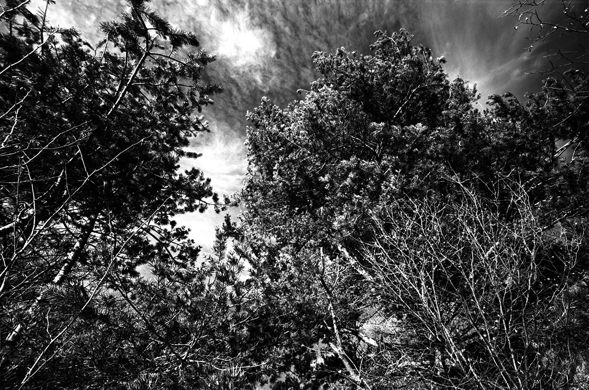

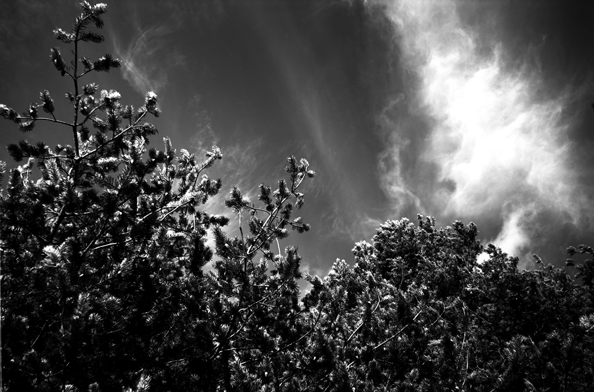

Here are 2 shots from the autumn of 2010, shot on a 35mm Technical Pan roll expired in 1985 (black colored canister, yellow lettering) :D
I used russian Zorki 1 rangefinder, 20mm wide angle lens, orange filter.
The roll was shot as 50 ASA, developed in Rodinal 1:100 for 15 min

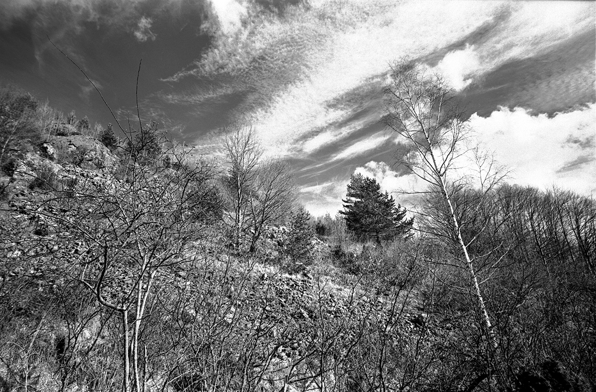

This one is from the same day, same place but on Adox CMS 20, shot as 10 or 12 ASA, again Rodinal 1:100, 15 min.
camera was Fed nkvd with its matching original uncoated lens 50mm f/3,5 closed just a single stop from wide open, light yellow filter
