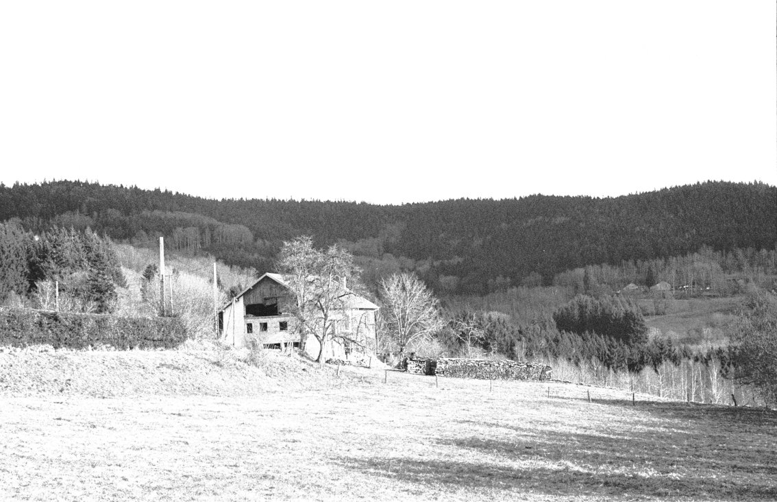

    Hello , I've developped efke KB100 ( exposed at 100 ) in beutler 1+1+8 for 15 minutes . The result is flat wit burned highlights .
    How can I have best results ? exposed to 200 and developping 21 minutes ?
    Could you give me an idea ?

    Generaly : You would need the avoid of overexposure/overdevelopement?
    Then you should first shorten your exposure/developement. From your given example it looks like a bit more tv an a full stop correction.
    Next is the contrast. I am wondering about delution of beutler in your example. What is your intention to come to such delution? Your intention is to control contrast or is it in regard of sharpness?
    with regards
    PS : Don't worry to much about your first results with beutler. I have seen worst failures by preparing new developements at the first time. You allways have some corrections on different workflows.

    OK - Alisouscous I just checked it Form my notes. Your time with beutler isn't correct. With medium films the developer time should be "arround" 10 - 12 min.
    Perhaps you need in addition delution
    1 + 1 + 10 this also should help a bit against overdevelopement.
    The control of contrast should work as following : Change the ammound of part A (just a little) I guess 10 - 15 % should be enough to higher the contrast.
    (Just if it is still necessary after corection of exposure/or developing time)
    If I am not (total) incorect this may change developer characteristics in regard of higher contrasts.
    But pls. be carefull - you also change the developer characteristics in direction of increasing grain (remember the aggressive neofin red type! ).
    with regards

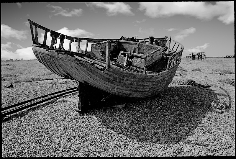

    Here's one on Efke 25 @EI=32 with a yellow filter developed in Beutler 1+1+10 for 8min 20C.
    There is no time for Efke 100 in the massive development chart but it seems to be a bit higher for the 100 than the Efke 25 and 50 so I suggest to expose at EI=100 and develop for 9-10 min 20 C.

    Hello all ! Thank you for help and good informations !
    I've made tests all the afternoon .
    @trendland : yes 15 minutes is to much , and in my test , 9-10 minutes is the best ( but some highlihts are burned )
    @darkosaric : it looks like a good idea to expose @200 ASA to protect the highlights - Tomorrow i'll test a film exposed @200ASA and processed in D76 11 minutes 30 (maybe i'll test beutler for 13 minutes )
