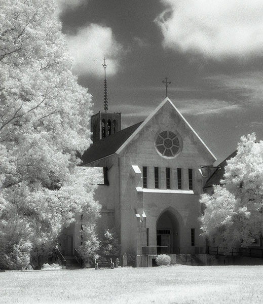

This is Efke 820 Aura shot at ISO 1.6 ans I used an 89B filter. This was shot in SE United States two weeks ago. HOT full sun.
Looks pretty neat, but.....them thar trees is WHITE!!!?????
