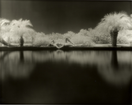

So I tried out infrared film for the first time and the attached print is my first effort. This was just my first check print - not an attempt at a final print by any means. Metered at ASA of 6 and exposed with a #87 filter. Exposure time was 30 seconds (about plus 5 stops) in mid day sun with no clouds or haze in the sky. Film developed in PMK Pyro in trays.
Negative is pretty low in contrast. This print is done with a #4 filter on Ilford MCMulitgrade FB Warm Tone paper.
One thing that I'm wondering about is that there is some blotchyness/streaking in the sky on the left side of the image and some lightness in the water lower left. Have any of you used this film before and is it unpredictable regarding areas of no detail to have minor problems like this? I don't know if it is something related to the film or my processing (in PMK Pyro). Perhaps this fllm doesn't like Pyro very much. I'm interested in anyone's thoughts/recommendations towards developer if in fact this problem is due to the PMK Pyro that I used.
I love the look that Infrared film gives. Image looks very eerie looking as expected. Note that the print looks much better than the scan image.

Hi Dan
I have been using this film for a while now and process it in Rollo Pyro. I exposed it at 1.5 ISO and use a Hielopan RG 715 filter. This film needs and wants and good exposure and I have found negatives that are underexposed, as I think yours are, are difficult to print. I think the streaking in your negatives are either caused by under exposure, under development or both. You mentioned that the exposure time was 30 seconds, what aperture were you using? With my setup I would normally expose at F. 32 at 3 seconds to 10 or 20 seconds, depending on direction of the light and wether I feel there is plenty of infrared radiation. Do some tests with plenty of notes. This film is worth the hassle of learning its inns and out's. It is the only option if you want true infrared film. Good luck.

What was I thinking - you're right it is EFKE film not Ilford.
Michael.
The Exposure I believe was something like F16 or so, but I'm not sure on that. I did another exposure for about a minute, but that only resulted in a negative that is slightly darker overall. The sun was just about directly behind me. Perhaps that wasn't the best angle.
The development time was based on info on Digital Truth however they don't give any info for sheet film. I definitely need to do some bracketing to test it all out.
For what it's worth, the shadows in the neg are fairly dense as compared normal film negatives and the density range as measured by my densitometer is only about .3 between the shadows and the highlights.

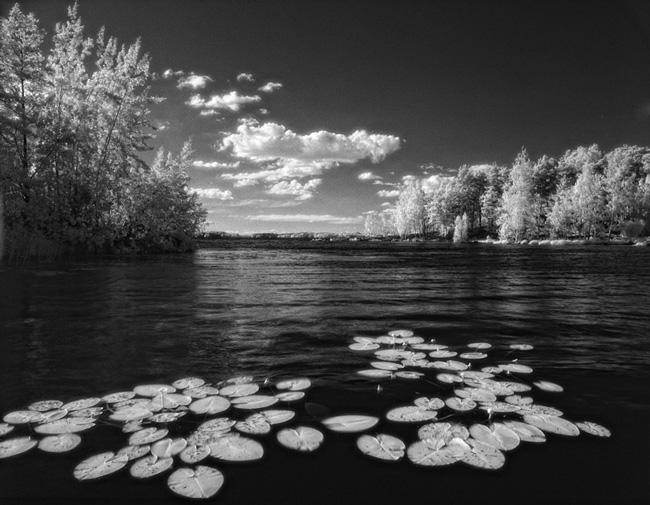

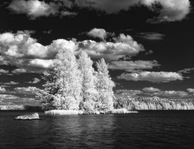

I rate it at 100 ASA using Hoya R72 and then add 5 stops in bright light - mid day and 7 stops early evening. Need to bracket your shots to ensure you get the right exposure
The 2 shots here were approx 4 hours before sunset, around mid summer in Finland
Processed at 21c in XTOL 1:2 for 11 minutes in Jobo

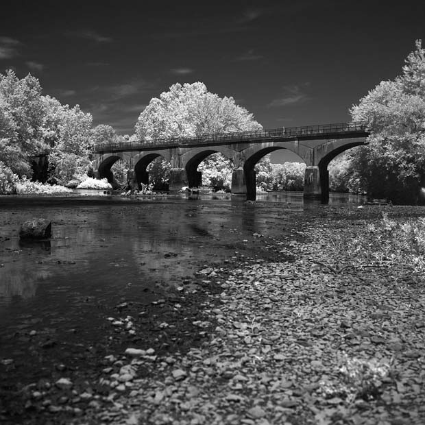

Here's a synopsis of a recent shoot involving several hundred frames of Efke IR 820 and Efke IR 820 Aura in 4x5 and 120 roll film formats.
The "Aura" feature does not do much on big film as the image "halation" or "flare" is quite small. I imagine in the 35mm format where the enlargement ratios are greater the "Aura" would be more prominent. Bunches of green leaves which "glow" in the infrared tend to merge into fuzzy blobs with significant over exposure. This effect is worse with the Aura version of Efke IR 820.
There is a loose correlation between conventional meter readings and infrared exposures. My Pentax spot meter was set at EI=1.5 for sunlit scenes, EI=0.75 for sunny day subjects where shadow detail was important, EI=0.3 for cloudy overcast days. Exposures were through IR680 and IR720 filters. Surprisingly it did not matter which filter was used. The results looked much the same!
The IR680 and IR720 filters, 77mm diameter, came from China via Ebay. They cost about $20 each. It is possible, for me at least, to see through these filters and preview the infrared effect. The filter has to be held close to the eye, extraneous light carefully excluded, and the eye "dark-adapted" for about 30 seconds. I suspect that with the iris of the eye wide open looking at the sun through an IR transmitting filter would be a very bad thing indeed.
Efke IR 820 film shows significant reciprocity failure but the following corrections worked well:
1 second metered, give1.5 seconds
2 seconds metered, give 3.5 seconds
4 seconds metered, give 8 seconds
8 seconds metered, give 24 seconds
15 seconds metered, give 1 minute
30 seconds metered, give 3 minutes
more then 30 secs, give up.
Infrared focus shift is real and horrible. Everything I shot with the 360mm lens on my Mamiya RB 67 is out of focus. I suspect I have to rack this lens out about 5mm to compensate the difference between the visible and IR focii. More exact measurements are planned. Wide angle lenses well stopped down yielded sharp images but only because increased depth of focus forgives imprecision.
Some development variations were tried including hot paper strength Dektol! This was supposed to cure the reputation IR negatives have for low contrast. Cure indeed! The resulting super-contrasty negatives still made acceptable (sort of) pictures on grade#0 and grade#1 paper. Optimum development for my film turned out to be 7 minutes at 20 Celcius in straight Xtol. YMMV, naturally.
In practice Efke IR 820 like other IR films I have tried both disappoints and exhilarates. A lot of subject matter I had high hopes for yielded unremarkable schmutz but some plain things turned to visual magic. That's the deal.

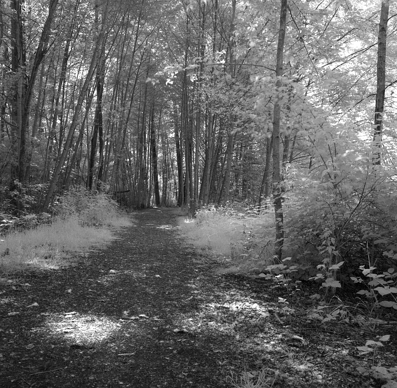

The 720nm filters are very close to the Hoya R72. I'm happy with my results with a R72 and the Rollei film:
