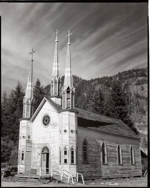

Efke 25 8x10 silver gelatin contact print. EI 16. Wratten #25 filter.
That's a nice photo. How did you compensate for the red filter? I use to give Efke 25 a half top more than the filter factor for orange filters, to compensate for the less red sensitivity.
I'll check my notes when I get home. Its reciprocity characteristics are interesting, too.
One of the things I loved about the film was its weak red response - it was truly "orthopanchromatic". Never used it with a red filter, but often used a green one for clouds.
