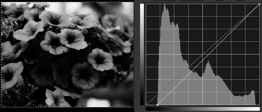

Part of the issue is also in the digital representations/scans, which have a black pointed that's lifted significantly above zero; let's have a look at e.g. the petunias with a black point zeroed out:

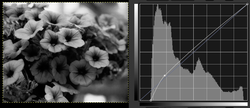

It now becomes more apparent how much of the center part of the image, i.e. the shadows, are compressed. If we were to salvage this, a steep correction curve in the shadow region would be required:
Things don't really get all that much better since a lot of differentiation int he center of the flowers is just lost (compare to the better exposed ones above).
You could do something similar for the other two images and find that they work the same. They all suffer from strongly compressed shadows.

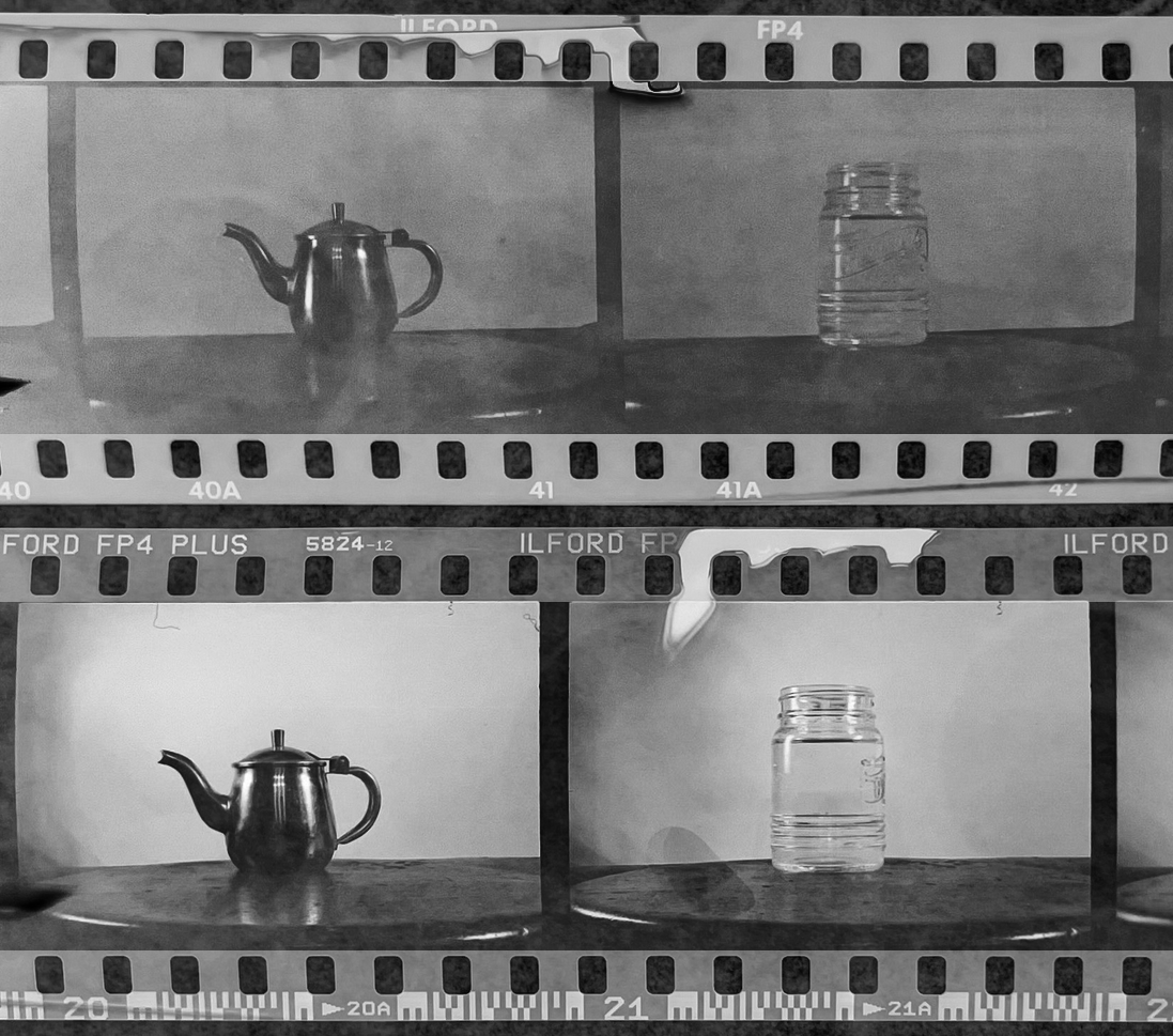

I had a look at inverting and contrast-adjusting a snippet of your comparison...
