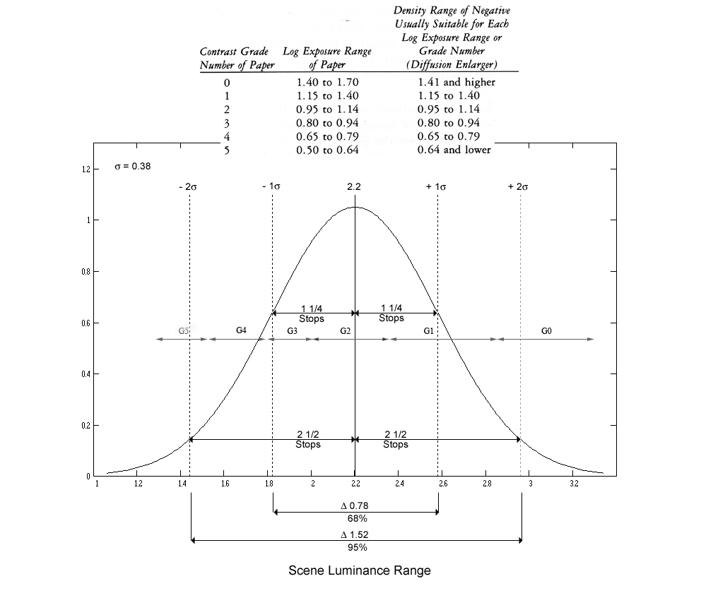

Doremus, it's an average. Just like normal processing is based on the statistically average luminance range of 2.20. There's an average level of flare for a scene having a general distribution of tones. Flare is variable and most of it is caused by the subject. Two scenes with the same luminance range can have very different levels of flare is one is predominantly black with some white and the other is mostly white with a little black. Paper and printing techniques can be utilized and there is also the idea that flare is acceptable and even expected that in certain cases. You don't expect back lit scenes to look the same as front lit. The lower local contrast is expected and part of the look and mood.
Average flare with modern lenses is about 1 stop for a luminance range of 2.20. 35mm lenses with more lens elements generally have slightly higher levels of flare. Based on their aim CIs, Kodak has apparently been having a little debate over the average degree of flare. What is considered normal development begins with a scene with a 2.20 log luminance range. A CI 0.56 has about a stop of flare to just over a stop depending on rounding. CI 0.58 is about 1 1/3 stops of flare. Under Dick Dickerson, Kodak used CI 0.58 for normal. Before they used CI 0.56. In the last few years, it looks like it's back to CI 0.56. The difference doesn't really mean much in practice, and the saving grace to photography is that it doesn't really matter because you can do almost anything and still have a printable negative under average conditions the majority of the time; however, most of us here probably want something slightly better. So the idea is to aim for the bullseye in order to have the best chance of hitting the target. As with any model, how good it's considered to be is how well it works in the greatest number of circumstances. With an emphasis on greatest number of circumstances. For example, Jones found the fixed density method for determining speed isn't as precise across the board as the fractional gradient method; however, most people get by just fine using the fixed density method. The difference under average conditions, depending on film type, is negligible, but it becomes more obvious when the conditions become more extreme.
I put together something that is kind of interesting. I took the normal distribution curve of luminance ranges, and asked if a negative was processed to Normal (CI 0.58) under the different luminance ranges, where would it fall on the various paper grades. In other words, if I just went out and shot and processed everything normal, what grade would theoretically produce an acceptable print. One standard deviation includes 68% of all data points or more than half of all encounters. Below they would fall in the middle of Grade 1 to Grade 3, excluding personal taste. This suggests most personal testing methods don't have to be too accurate while still producing a usable negative in most cases.
