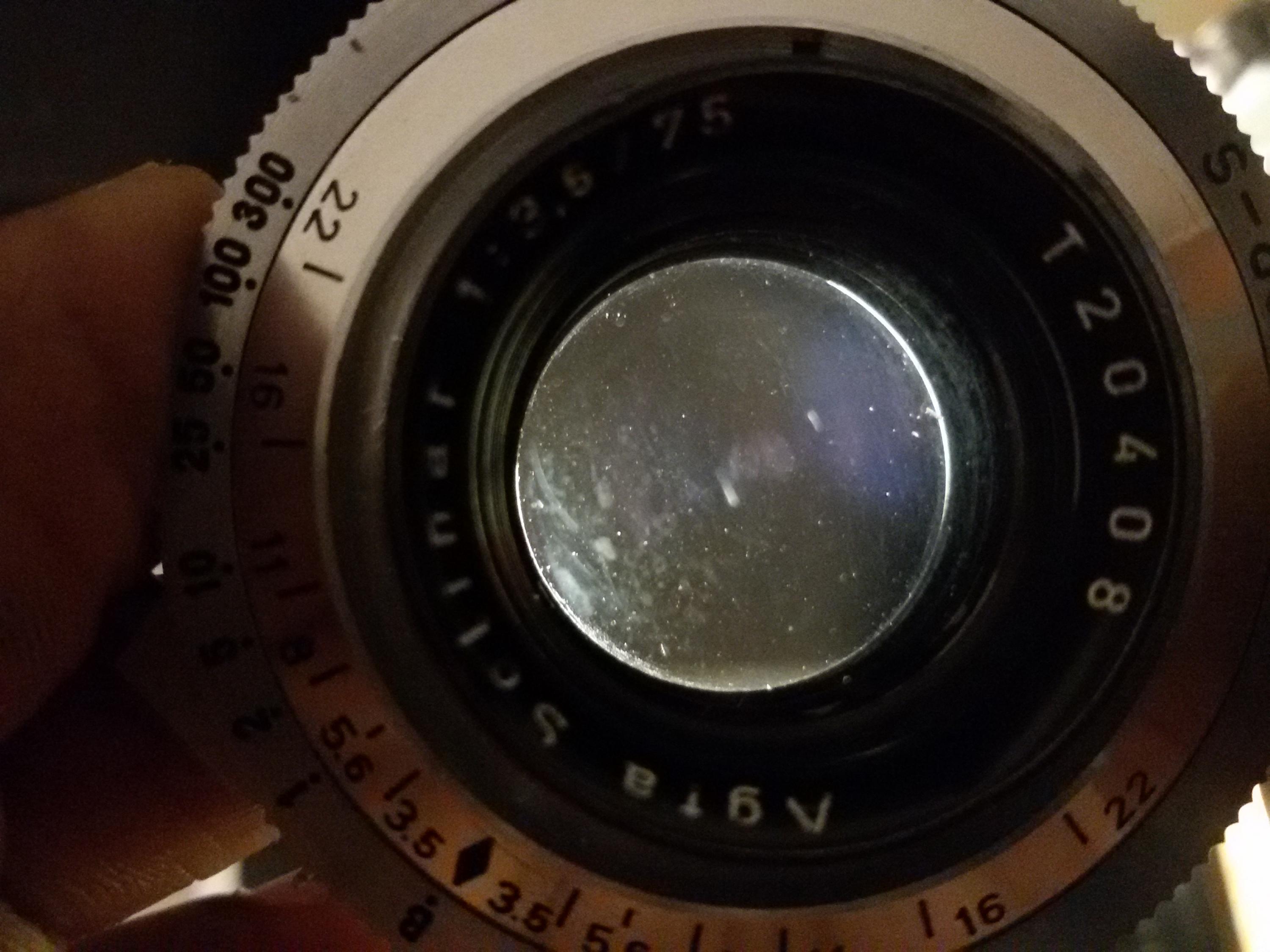

I did some BS with dry grease which has caused damage to the front surface of the second element. Result fine circular lines.
Contact lens lotions has removed the cloud and it is clear now except the damage on the second element.

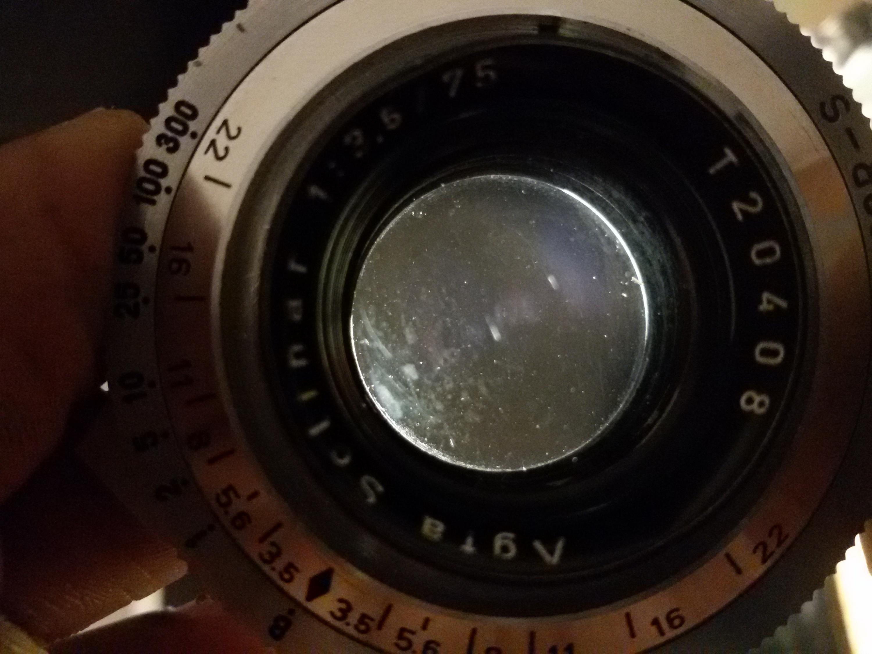

...and the damage.uploadfromtaptalk1445728474274.jpguploadfromtaptalk1445728492428.jpg

I believe during soaking in lighter fluid, the dissolved grease might have settled down on the surface of the second element and subsequent heating in the oven might hardened it.

I think I can live with it. This lens can be good for portraits.
I presume the polishing can only be done by professional? For €30 camera, I don't know whether I can go for.
Its sad to see it but its okay.

At f/8 and above I don't see those damage and that is perfectly okay for me.
