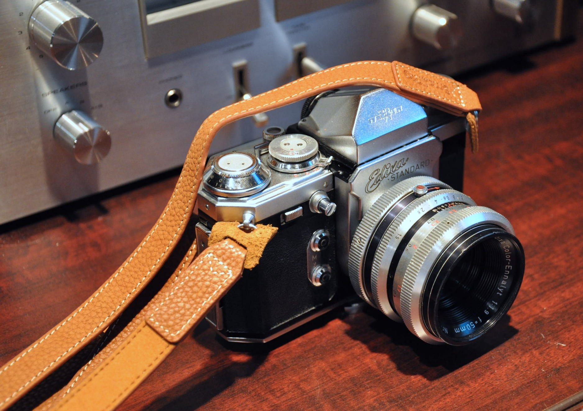

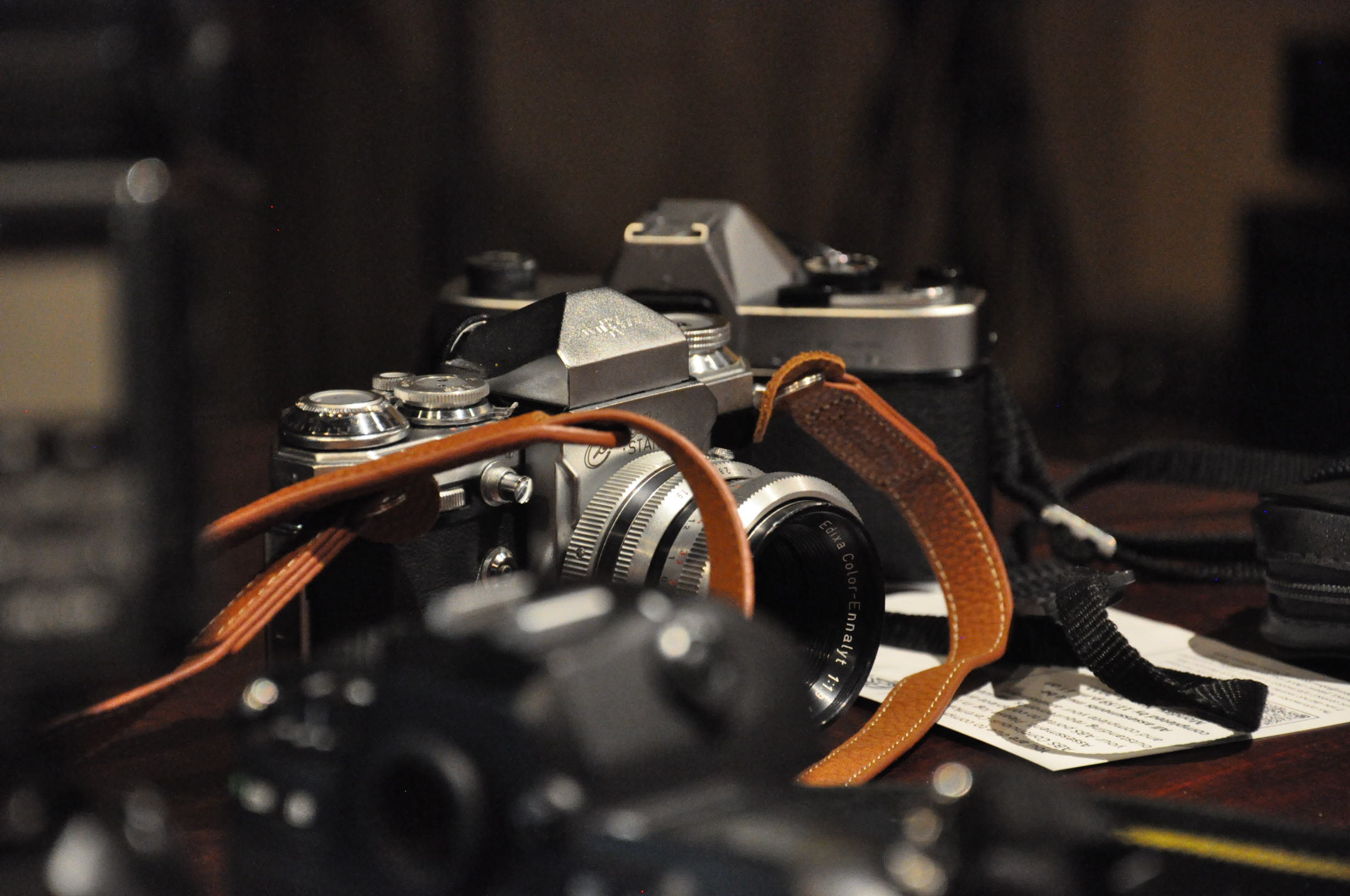

I found a nice strap to complement the esthetics of the camera.

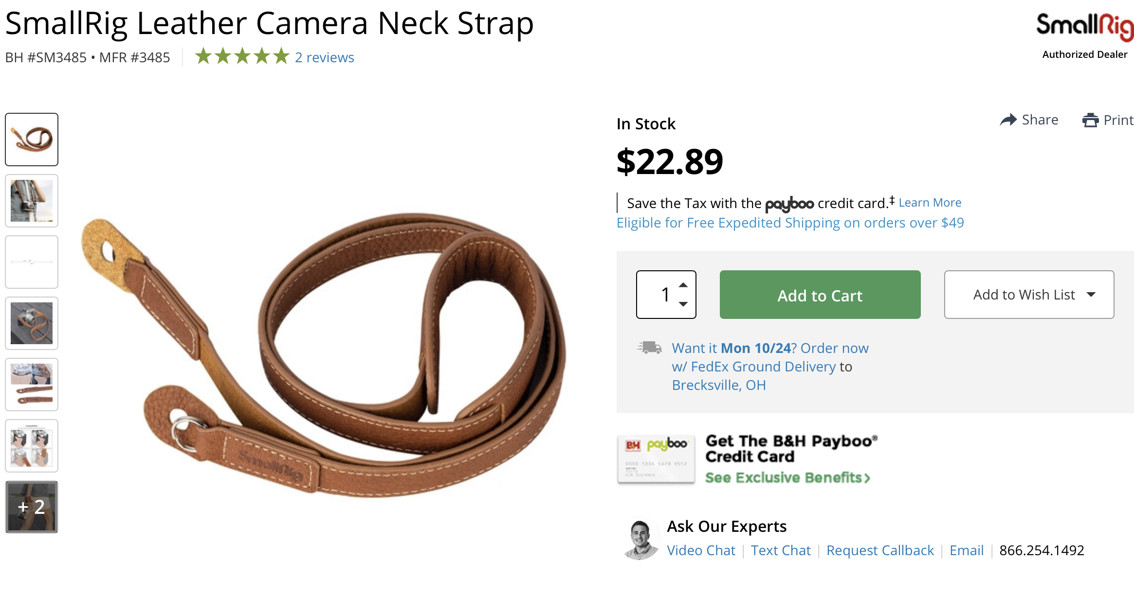

I found that at B&H. One problem with B&H is they carry TOO MANY straps. I had to wade through pages and pages of items to find that.
It is really nice, I will likely get one or two more for some of my other chrome cameras.
The leather is very supple not stiff like those original leather Rollei TLR straps.
