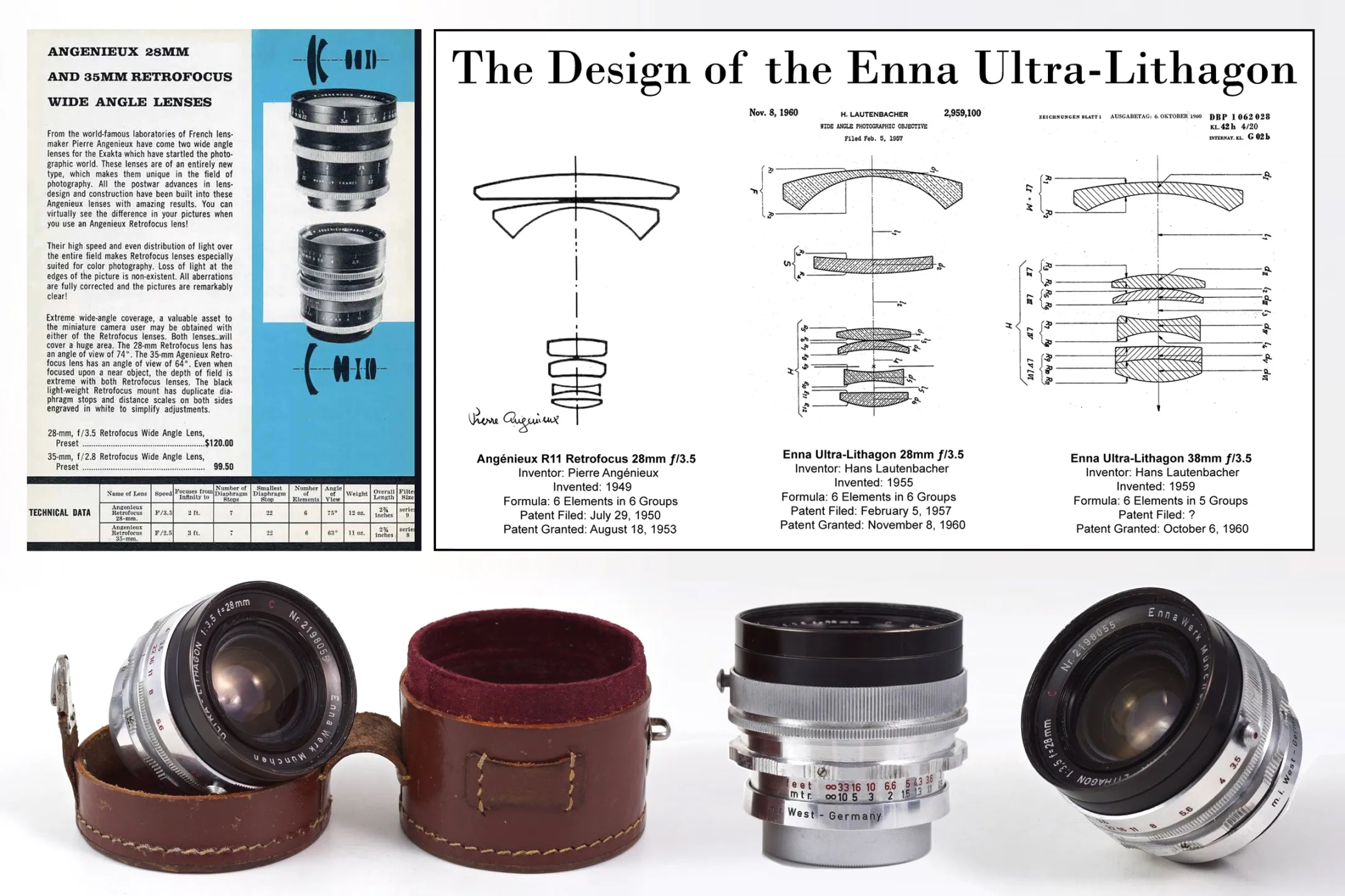

Here is some information from the internet on Enna lenses. They designed the 35mm and 28mm lenses first. The 24mm that I'm getting came a little later.
Again, the lens pictured in #26 is the actual lens I'll be receiving, but here are some other Enna 24mm Lithagon lenses with slightly different zebra stripes. I believe the lens came in Exacta and Robot mounts (in addition to the M42 mount for my Edixa). I believe it also was offered in a universal mount ( Sockel-lenses),.
These lenses are called "Lithagon" and according to Captain Jacks Exacta Pages, the lens names "Ennalyt" and "Lithagon" interchangeably among their wide angle lenses.
