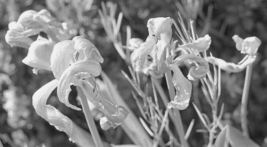

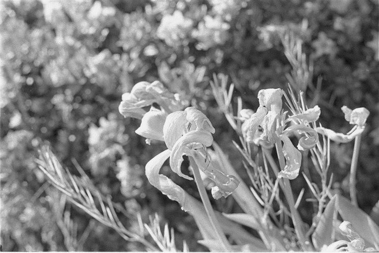

Spotmatic SP, Super Takumar 50/1.4, early 2000s Tri-X, Caffenol (no ascorbate). Here's a crop:
Grain is "crisp". Scanner doesn't do much with the imagewise stain, though that would show in darkroom prints on multicontrast as a softening of grain, as well as smoothing of mid-tones due to the color of the stain.

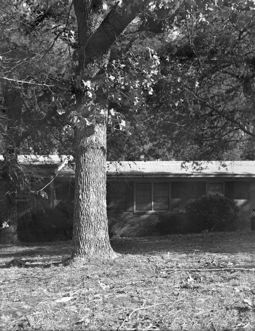

Here's another one, with Fomapan:
Kawee Camera (aka Patent Etui, 13.5 cm f/4.5 Radionar), 9x12 cm Fomapan 100, Caffenol (no ascorbate).
