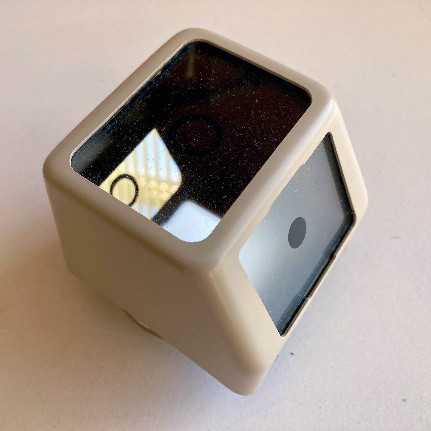

Linhof:

Could you rephrase that question? One does not need a magnifier to see sufficient detail in an image, so I am not quite sure what you are asking.
I’ll try. You make the image as sharp as your eye can tell you under the enlarger. You seem to be saying that in the resulting print your eye will then see it as unsharp. I don’t see how that is possible.
I do my initial focusing wearing a relatively strong pair of reading glasses. But I'm often amazed just how much I'm off once I introduce the Peak magnifier.
I only have the Paterson jobs, but that’s what I meant about eyesight: my experience is that my eyes have always got it right. I stick the Paterson in place and there’s the grain. I understand what @MattKing is saying about fine grain (and presumably larger formats) making it necessary to focus on edges, so it’s relevant to say that I am only using 35mm.
