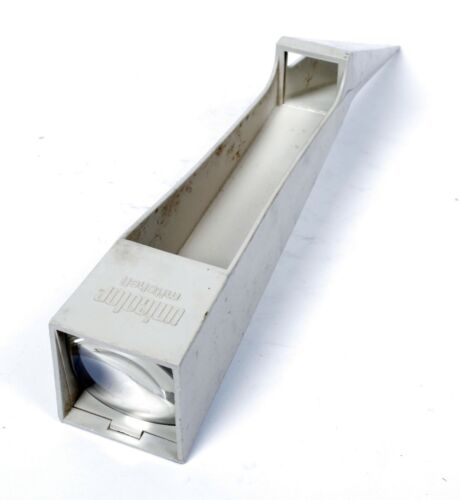

This works for most of my needs.
The Mitchell focus scope.
Corner to corner focusing but not highly magnified.
I used this exact model for three years when I was a custom printer at a Wedding Lab here in Toronto , great device.
