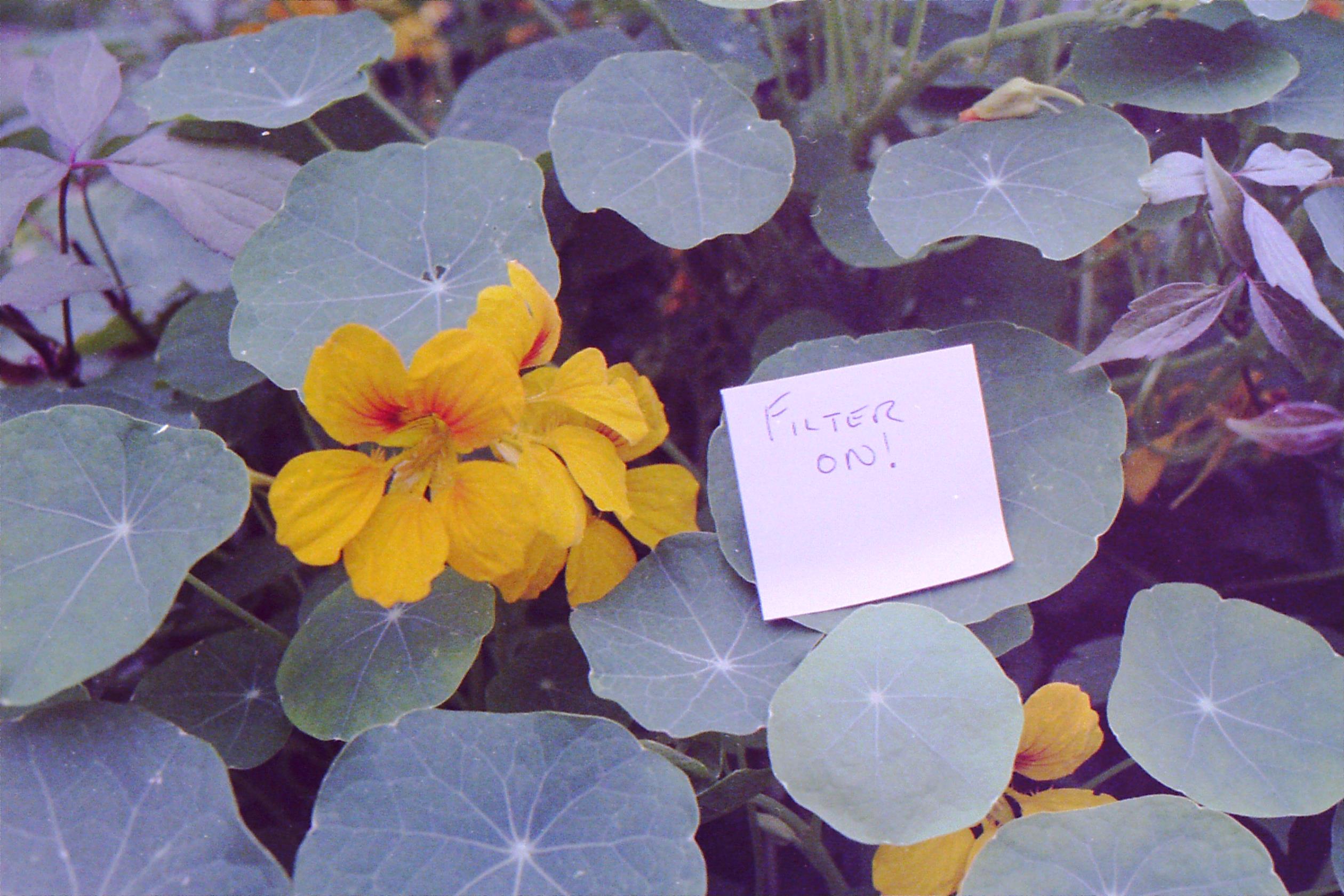

Here are the results from the home made Developer 'V' Lab pour off!.Film is Vision3 500T.
45_03 is the Lab pour off.
15_03 is the Home Brew.
Canon T70 with lens barrel set to auto, camera set to 320 iso with Hoya No.85 filter. Consecutive shots with shutter release held down for 12 frames. I cut the film in the dark so I could get two strips of exposed film of equal length. I used the Paterson Thermo tub with added water curculating pump to get the temperatures as close as possible. I do not have an assistant to do side by side Development test, so i had to do one after the other.
Please accept my scanner is useless.
I want to show you the difference with the developers. Which one is best. Both solutions are on 3rd use for the test.
As I mentioned I got my hands on the antifoggant now.
I think my latest shows that i need the anti fog to help with the storage of the home brew developer. Please can you remind me what chemical the anti fog is. i will buy some.

you don't need to set the camera to ei320 when using the filter. With the filter attenuating brightness and the camera set to 500 you will effectively be shooting at 320 as a result. That is what kodak is saying by giving you that 320 value. Of course, if you were using an external meter then you'd have to set it to 320.

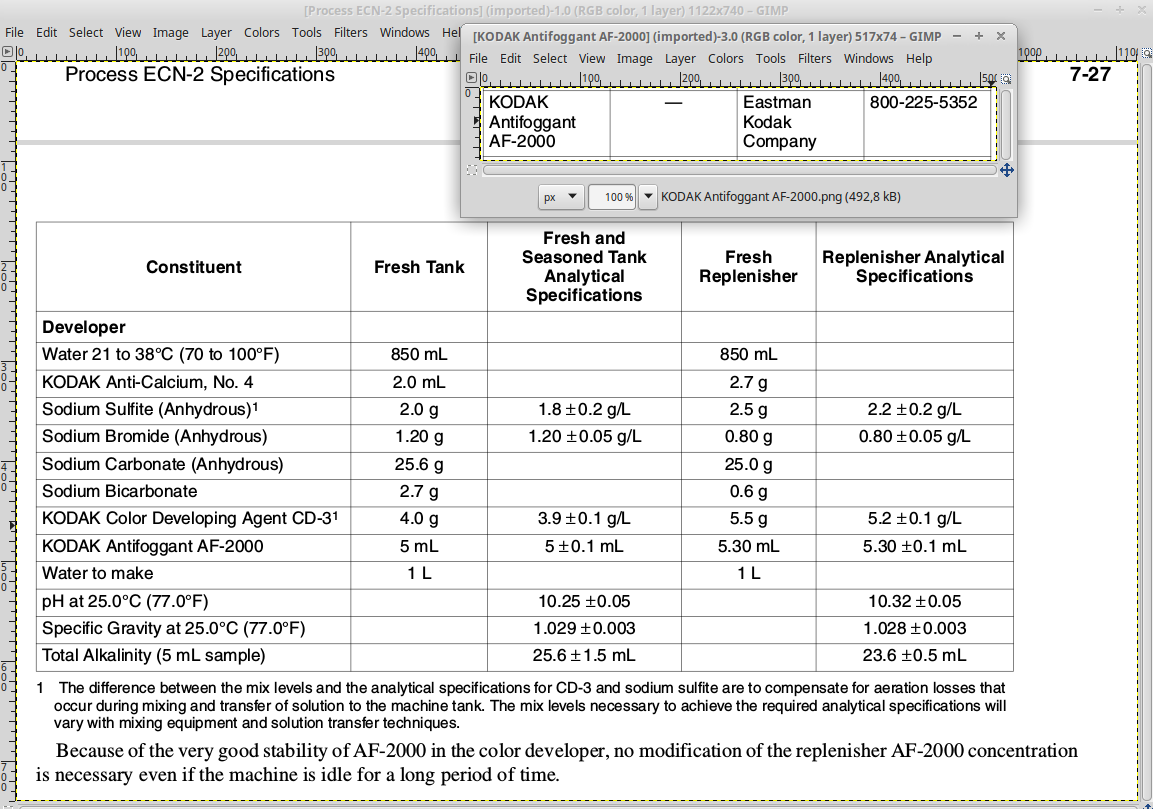

I'm not convinced that AF2000 will better the keeping properties of the developer. pH is quite important, though.
Anyway, there is a great resource created by a member. It will tell you all about AF2000:
https://www.photrio.com/forum/index...ition-of-kodak-af-2000-for-ecn-2-process.342/
I checked the patent and come to the same conclusion.

In connection with antifogg, I think you'd better buy the KODAK Antifoggant AF-2000 commercial product.
Patents do not always tell the exact networks.
Ask PE to tell you how things are.

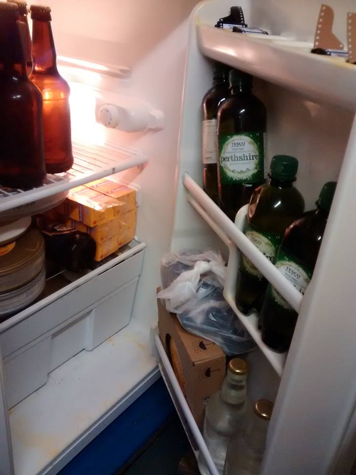

Putting film processing solutions in the refrigerator where you probably have your food too, I think it's a big mistake.
George, I have a seperate fridge in the shed for film and chemicals. (see pic) The wife would cut something off me in my sleeep if I put my photo stuff in the kitchen fridge.

I envy your fridge. I have a small freezer cube which is pretty full.
The problem with solutions in the fridge is that some components can precipitate before others. That can affect pH, disable a preservative, etc. Rodinal is a week known example. Will keep forever, unless stored too cold.
Still, I kept Fomadon LQN in the coldest part of the fridge for months while using it and it was fine. The previous bottle kept at room temp was becoming darker, IMHO. So there is the exception. But at €2.50 a bottle I could afford the experiment.

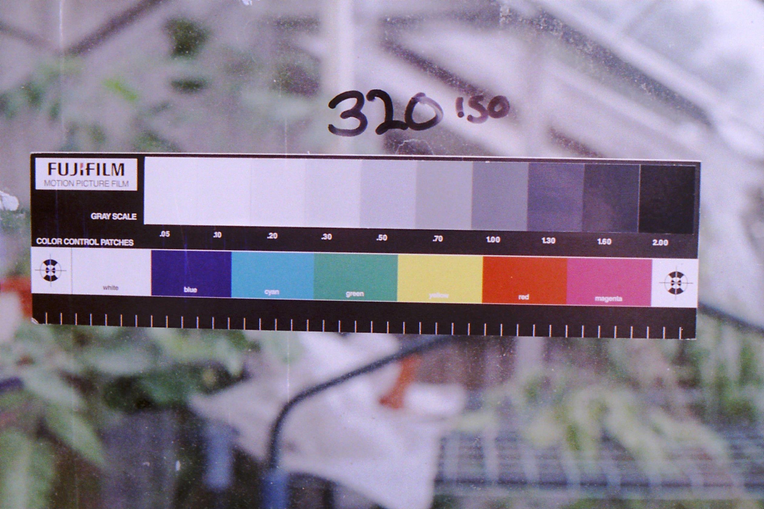

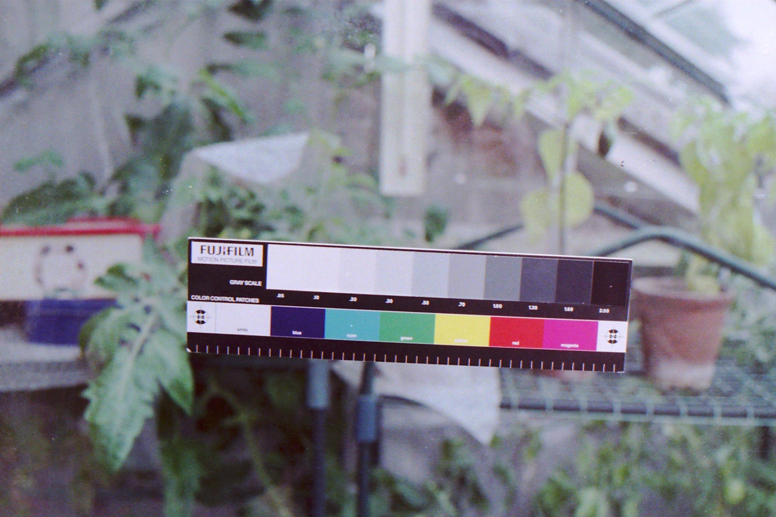

I attach the latest test with fresh film and the Lab chemicals. I took your advise and left the camera set at 500 iso.
The with/without test :smile:.

The colours on the test chart look more or less correct. The magenta seems to be a magenta. The entire look is lo-fi. So your problem may really be down to the scanner only.
Making positives from colour film will end up costing money, unfortunately. Whether that is a scanner/digicam, a darkroom with colour enlarger or a professional motion picture contract printer, if it is even possible to find and then operate such a thing.

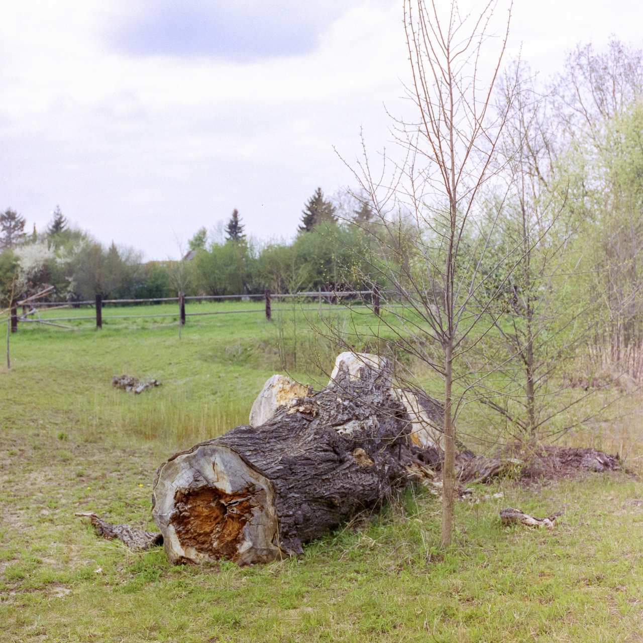

In May I shot a first test roll of the Cinestill 800T (V3 500T). It was an alpha roll for Kickstarter backers. Because I was dragging on with my purchase of chemicals I didn't develop it until I finally upgraded my ECN developer a few weeks ago. That means it was in the fridge for at least three months. Along with another six rolls of various Vision3 35mm rolls. There were some quality problems with that roll as you can see in the first image. I shot another roll recently. That one had no abrasion in the emulsion. Both rolls were developed together on the same jobo spiral.
Here are two samples from that older roll. For the first one I forgot to use the 85B filter. I deliberately applied the same colour correction as for the filtered frames taken in the same light. It is also overexposed because I used an external meter. The second one was shot with filter.
