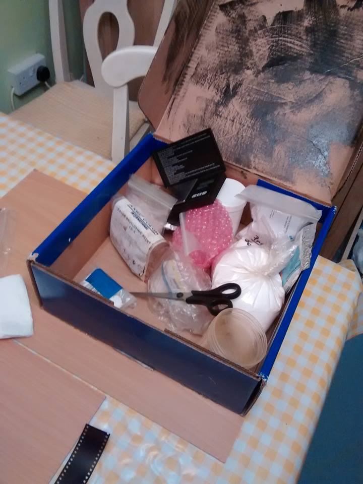

I made up a second 500ml batch of ECN2 developer following the Kodak recipe and the film i just processed came out with colour shifts. I have seen some industry ECN2 kits that require a dev starter. The Kodak ECN2 processing module says nothing about a dev starter.
The first batch i made I had put old Fuji and Kodak Cine film through it (I expect the colours to be off on that sold stuff) before I put 2017 Vision3 through it, The fresh film result was good but not perfect. So I decided to make up this new batch in the hope of getting a really good result!. I got the opposite. I have read that developer starter is used to season the developer!, if i run some old EXR through the dev, would that season it?.
The only change I made in the workflow was to use a sulphuric acid stop bath rather than the B&W stop I had been using. Kodak say to use Sulphuric acid 7.0N. I don't have that!. But I do have Sulphuric acid 60% concenration. So to make 1lt of stop I added 15.5ml of acid to 12.5 ml of deionised water, I made that up to 50ml, then added it to 850ml of deionised water.
The other problem is that the negs are very thin! Could that be caused by the stop bath I made?.
Something in the box of tricks makes me sneeeze :sad:.

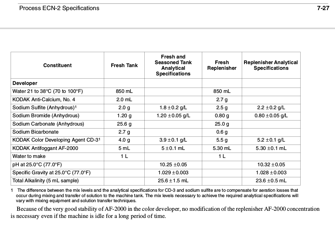

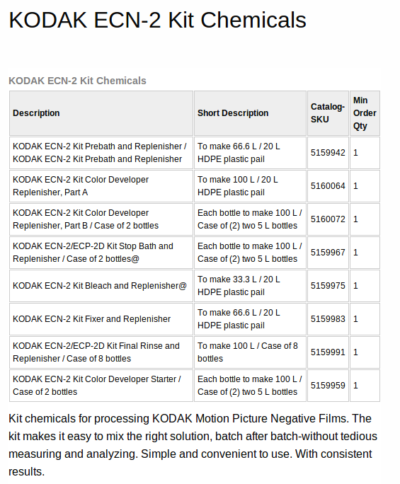

The ECN-2 kits use the name of:
- KODAK ECN-2 Kit Color Developer Starter
- KODAK ECN-2 Kit Color Developer Replenisher
The Kodak specification uses the name of:
- Fresh Tank (developer)
- Fresh Replenisher (developer)

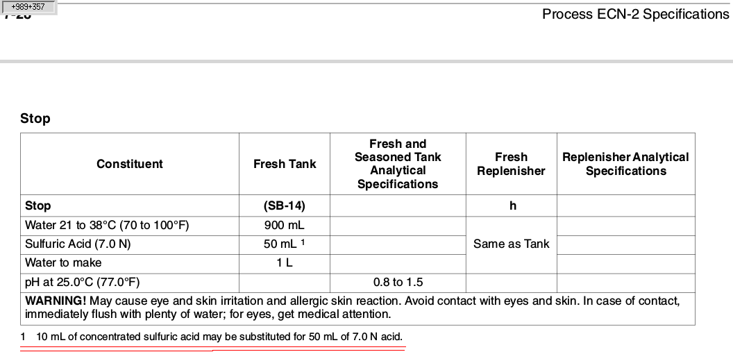

In connection with stop solution, Kodak says that for 1 liter of solution use 10 ml of concentrated sulfuric acid.
Depending on how mode is expressed your acid concentration (mass or volume), determine how much acid you needed.

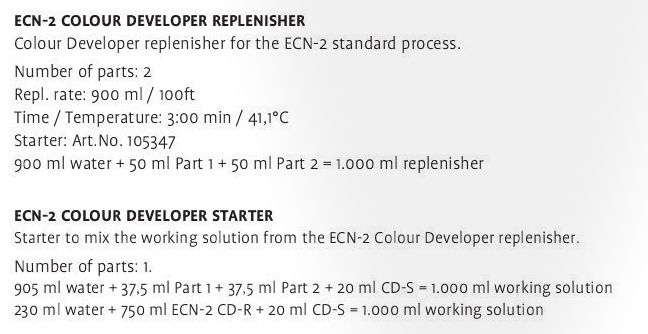

You must understand that there is developer and then there is replenisher. The starter is used to season the replenisher, not the developer. You see, replenisher should not be used as developer, but can be made into a working solution developer by adding starter to it, and probably some water as well. I have not used ECN-2 but this is the way it works for C-41 and color developers in general.
To summarize, starter is only used to make working solution developer out of replenisher. It is not added to the regular developer.
I think you have to decide with what developer you want to work for ECN-2 process.
If you want developer from raw chemicals see - Process ECN-2 Developer.
If you want to work with the kit see - ECN-2 Colour developer Kit
George

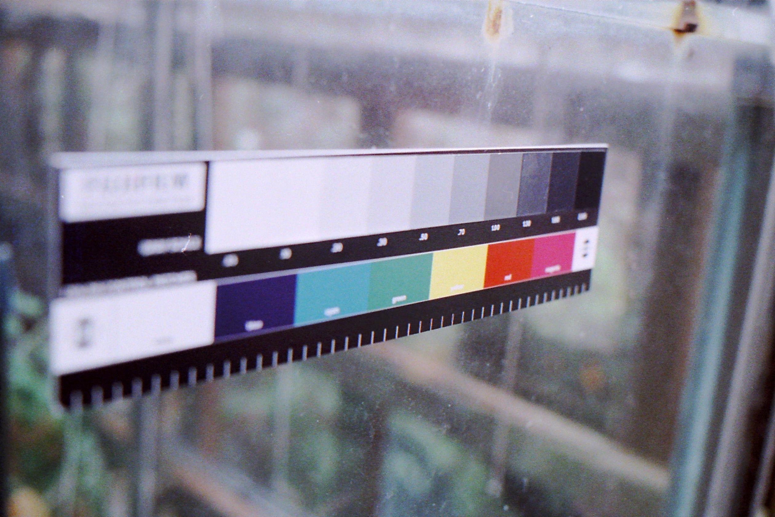

George, I attach some better images with Fuji colour card for you to look over. To my eyes the colours look a little shifted and for brand new film they should be spot on. OK, I can scan and PS the frames but my real aim is to get the best negs I can and then contact print them onto 2383 stock.
OK, first through the fresh solution was a strip i shot indoors using a couple of CFL lamps, (first two images).
Next strip through was a strip i shot outdoors with 85 filter and camera set to 320 iso.
Maybe you have the same colour card, if not, you know what colour Tomatoes are and maybe the Tin cans. I'll say nothing and wait to hear what you think.

Mogsby, I appreciate the fact you went to a color scale.
I do not understand with my English what negative color you are using.
Is the negative color the same for all samples?
Do you get the negative color of the same piece of film?
Do you want to develop 100ft negative color in what ECN-2 developer candidate?
But in general some processing kits do not contain developer, but only replenisher and starter. As the typical consumable would be the replenisher.

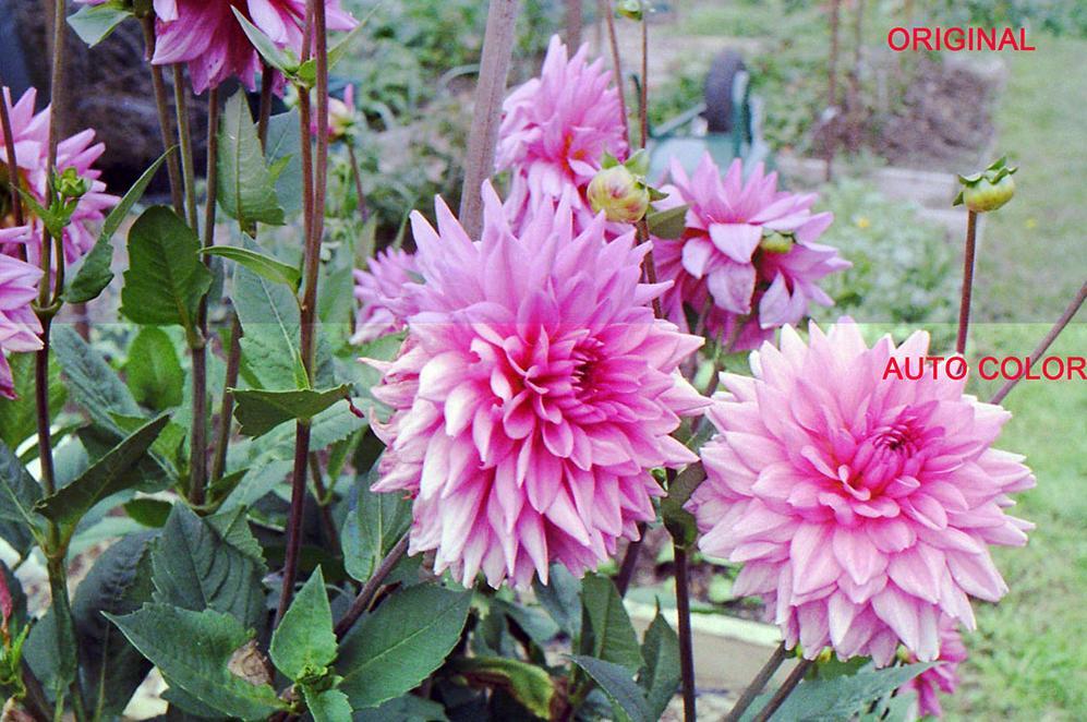

Mogsby, I think there are problems with the quality of negative scans.
I gave a „auto color” to a few pictures and here's how it looks.
With your scanner, I think it's more confusing than to help you.
I agrre with you, my scanner is not helping me at all. A better quality scanner is on the shopping list but there are few coins in the purse :sad:. At the moment I am trying to sell off all my older Kodak and Fuji cine film stocks on Ebay.

Athiril, I am currently using the Kodak documentation for the ECN-2 color negative process.
https://www.kodak.com/Kodak/uploadedfiles/motion/h24_08.pdf
In the present case, I suspect that the scans here are far from reality.
Mogsby, I think a convenient option for you would be to go to a mini lab to scan the cine film (a film).
Do not worry about dedicated software for ECN-2 film.
For amateurs there is no dedicated software for ECN-2 film.
Scanners generally handle such films responsibly.
It is important that the color temperature at shooting is correct.
Mogsby, you tell me that the ECN-2 developer can be kept for two weeks.
There is talk of fresh and unused compensation (replenisher).
You have the ECN-2 developer from a lab - used.
Based on a storage week, to have repeatable results.
Use the method - to develop a film and throw the developer.
The fog substance has no photographic effect.
It is for keeping color stability in time.
If you do not put the antifog substance on the ECN-2 developer, it's just the same, but the colors can degrade after a while.

The fact that thedeveloper is from a lab, that is almost a safety for you.
You can only influence the development time and the passing time of the developer in the stop.
Here is the problem not to carry a lot of developer to the stop.

George, I read the Kodak module and its says that developer in the tank can keep for one week open lid and two weeks floating lid, my mate tells me the flaouting lid can be plastic balls!. I realise the tank has 100's of litres and has the anti fog for keeping quality. The pour off I get, I put it in PET fizzy drink bottles and expell the air as best i can, the squezzed bottle allows room for expansion. The first batch of pour off I got, i sealed that in beer bottles and Crown capped them. It was OK over the winter, spring came and the bottles exploded in the heat :sad:. The pour off developer I get I will use as one shot, as you suggest. The developer I make from the raw chemicals does need the anti fog to help with the keeping quality. I will find the anti fog and buy it. I have two parts, the pour off and the raw chemical mix, I need the third part, the lab developing. Then I can compare the results.
There is a company close to me that supplies replenisher concentrates, but its enough to fill a bath tub.
Another can of worms!. I have Number 85 warming filters that I use to shoot the 500T in daylight @ 320 iso,but, non are kodak filters, they are a mix of Hoya etc. all say they are No.85 yet I can clearly see they are all different density/shade/colour even!, probably for some of the filters, its due to age.
I'll load up 3 short length cassettes of the fresh film and shoot them under same light conditions, then procces them using the pour off developer as one shot for each film. For consistency of the stop I will make 3 bathes and use use stop in turn.
My developer without AF2000 lasted for months. Of course I digitise and colour correct in software. So I couldn't tell if there were moderate deviations. As I mentioned I got my hands on the antifoggant now. So I'm using almost real developer now, only lacking the antical.
The statements about how long the developer lasts in those big tanks cannot be applied to our situation. Even 'covered' there will be a lot of exposed surface. I keep mine in glass bottles and use protectan.
The buffer used in ecn dev is carbonate based, so that might be why it blew up. Use screw cap and open occasionally. Especially upon strong temperature changes.

Mogsby, is the difference between the fresh clearing revealer that can last for two weeks and a revelator used in the car.
Keeping the machine revelator in colored PET bottles is an acceptable method.
Glass is the best solution, but it is more difficult to obtain.
Your bottle of drveloper broke because he froze and increased his volume.

Wratten 85 color correction filters, even if they are not Kodak, are likely to change the color temperature.
Follow the filter indications.
It is important to scan at least a few photograms developed by you on a normal scanner (minilab type - for example).
I think scans will look good.
If your sky is a bit blue in your scanner, on a better scanner the colors will be more acceptable.
