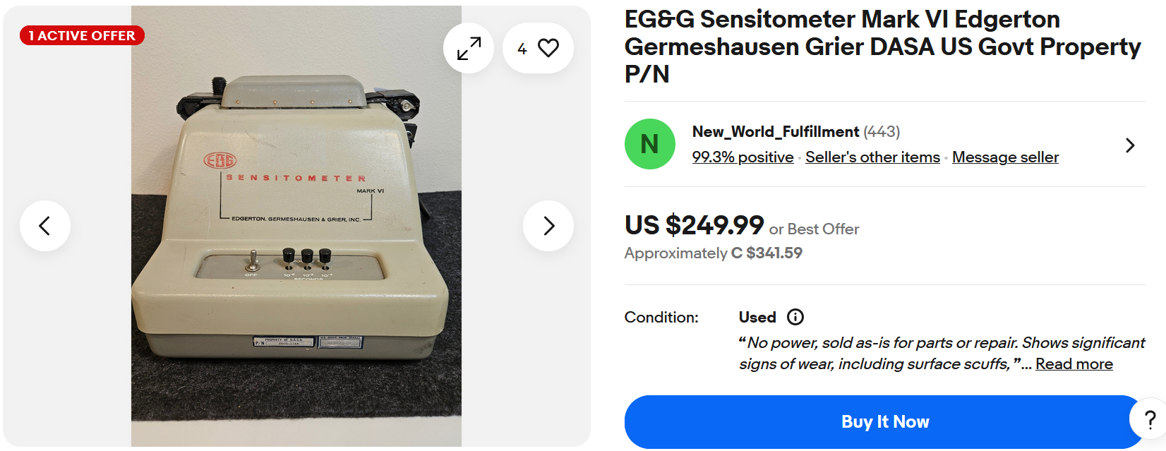

I have no connection with the seller.
Then perhaps you should share the link.
How about this?
Someone made an offer, so it may not last long.
I got mine on e-bay. Mine needed a new flash tube, other than that it works fine.
Ok I guess - if you have the skills to bring it to spec / calibrate.
I'd be wary - "Sold for parts or repair." The photos show a number of wires running over the case of the instrument and held in place with duct tape - so it has been modified and you will either have to remove the modifications or figure out their purpose. The 'negative carrier' (??) is loose: missing screws; not installed correctly; or broke? OTOH it seems to be pretty simple with only a flash tube, power supply and some switches.
You can do 'good enough' sensitometery with a step tablet and an enlarger (or other timed light source).

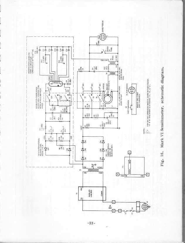

Yes it is a straight forward flash circuit. Three capacitors, with the proper ratings to get the three flash outputs, a trigger coil, a ac/dc rectifier circuit and dc filter capacitors.

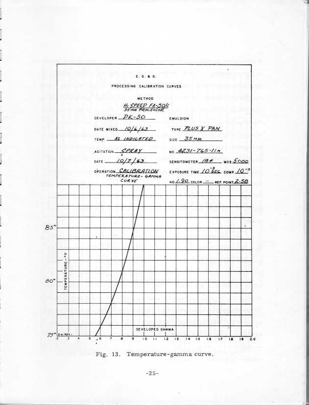

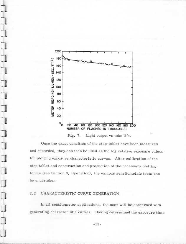

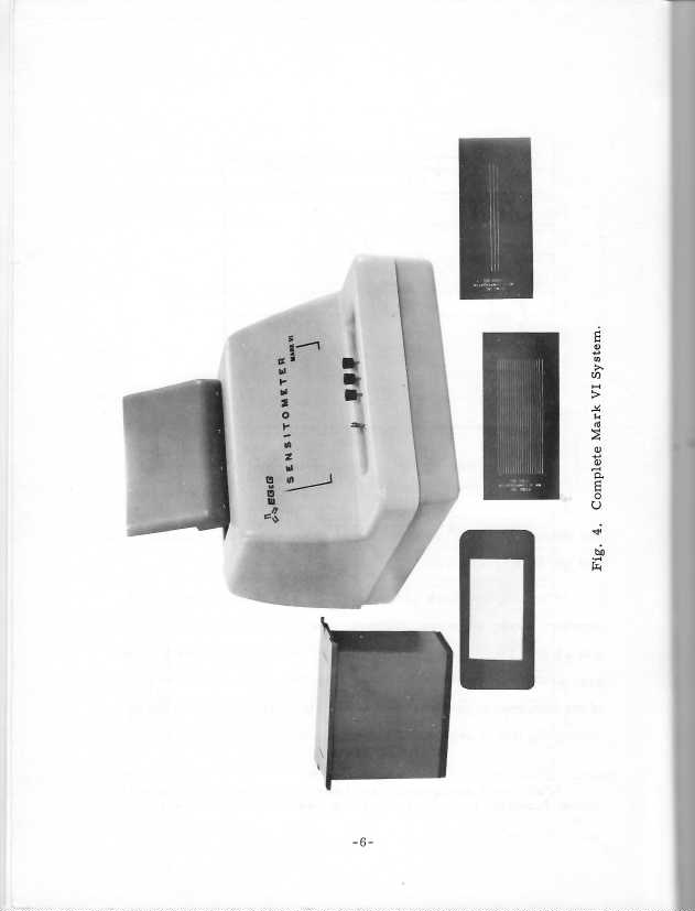

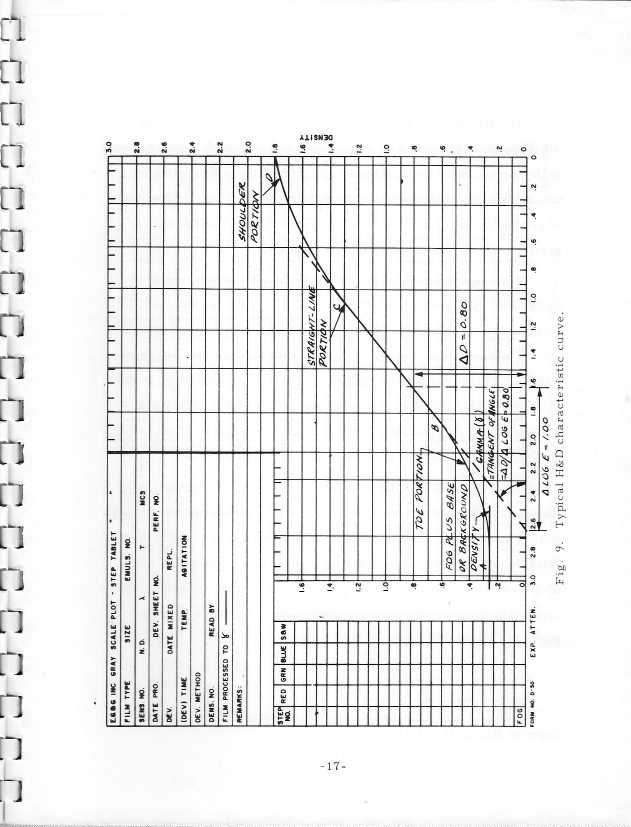

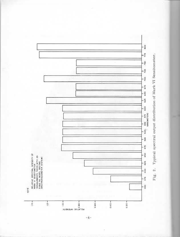

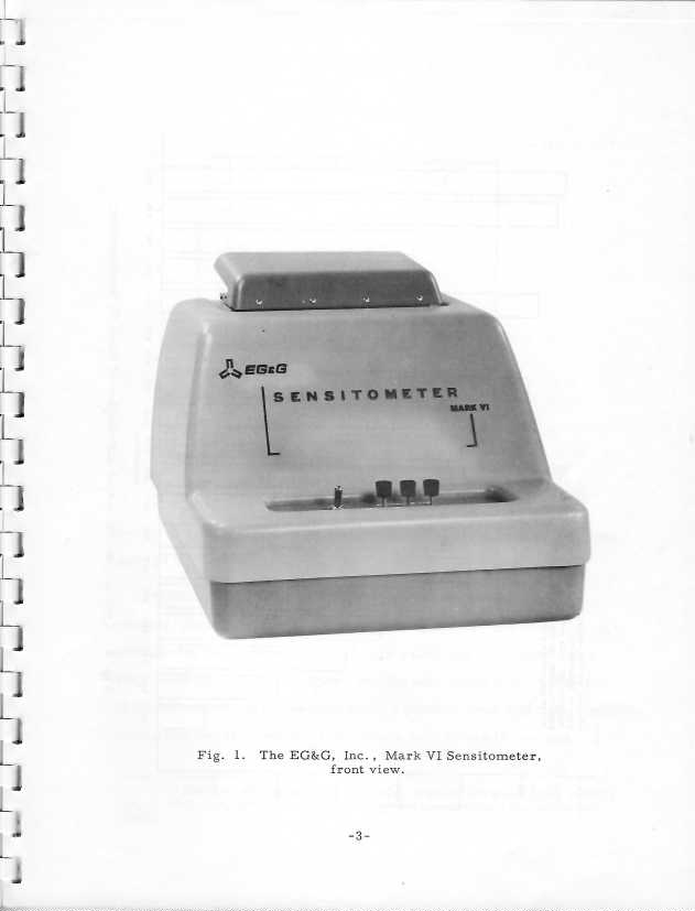

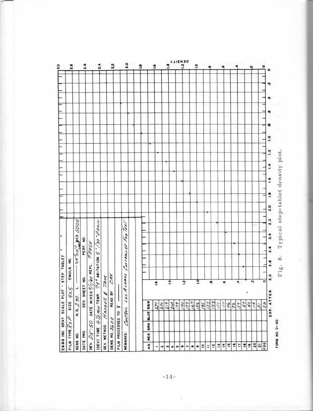

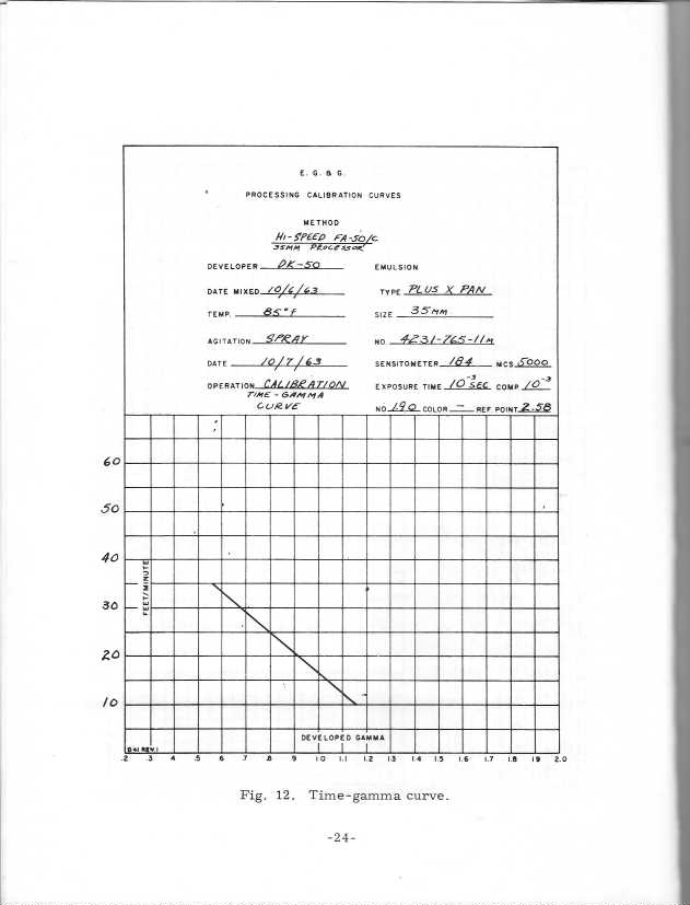

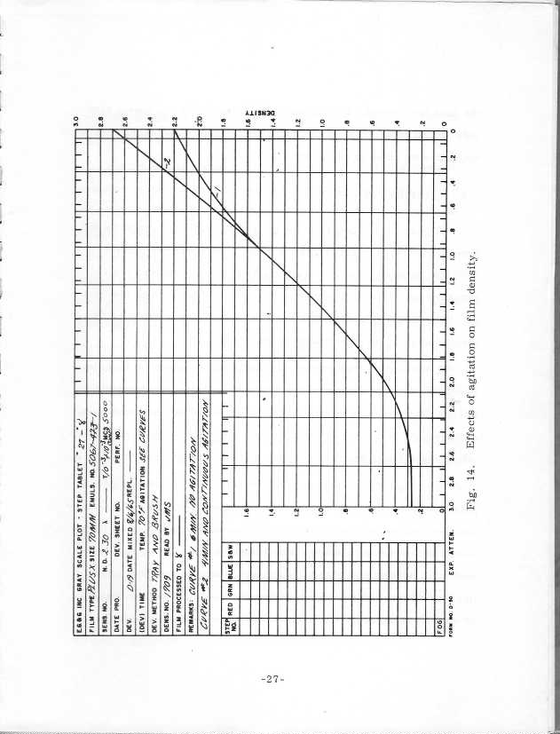

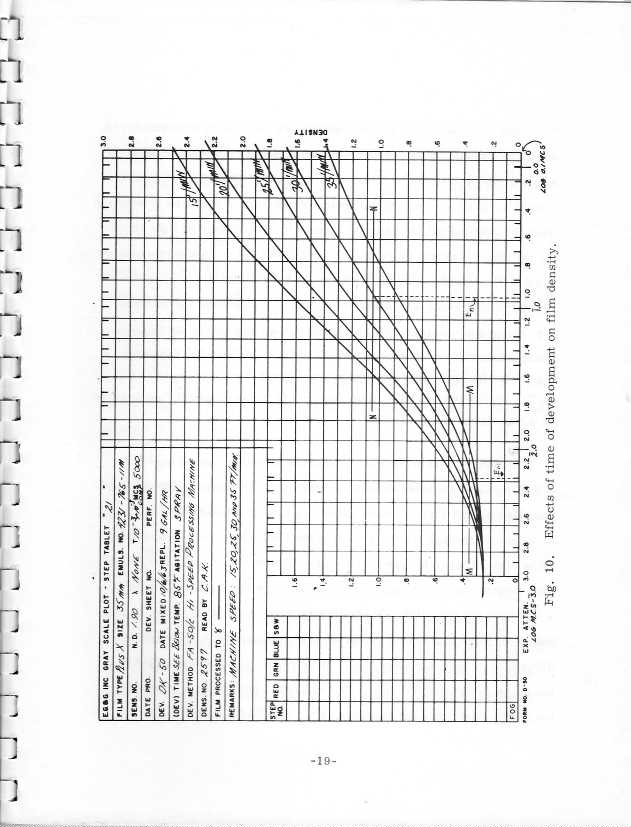

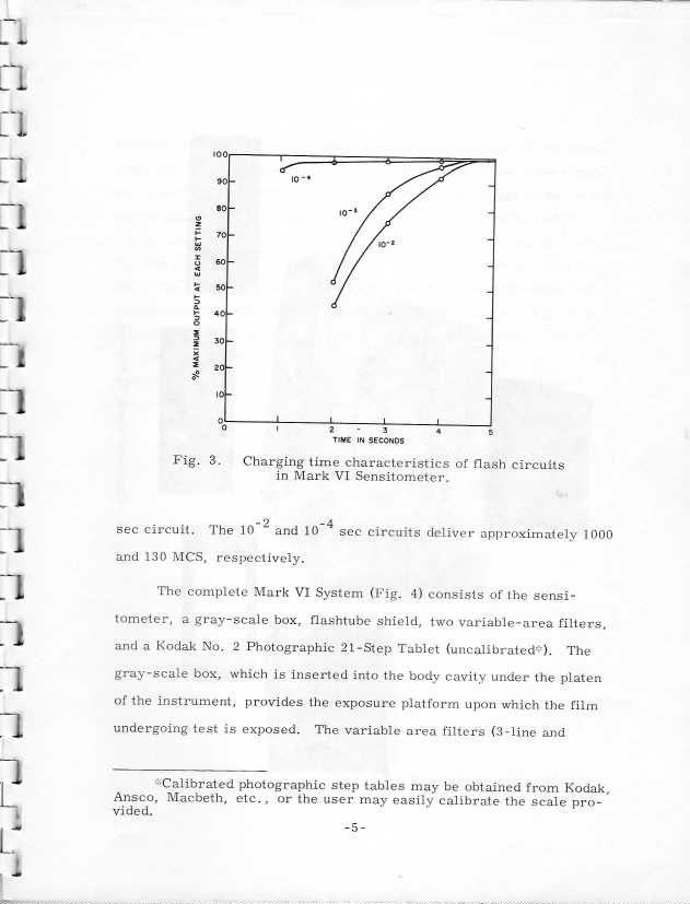

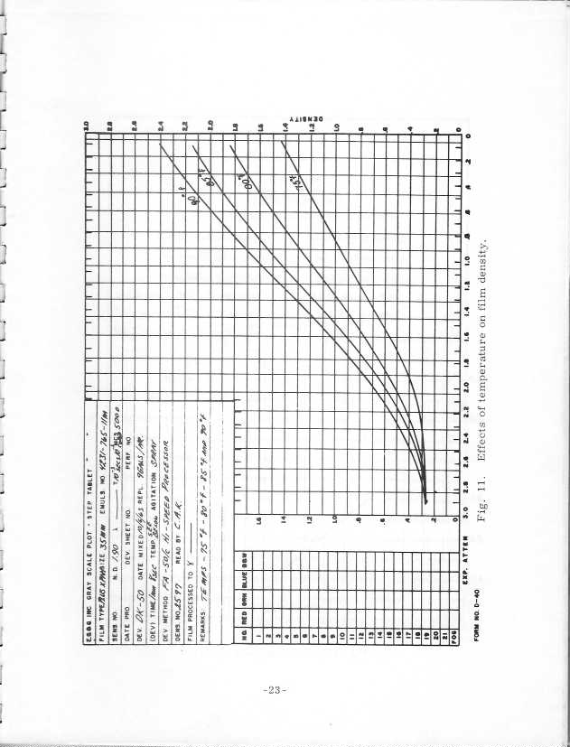

Here is the E.G.& G. Mark VI sensitometer full instruction manual number B-3610 August 1967
