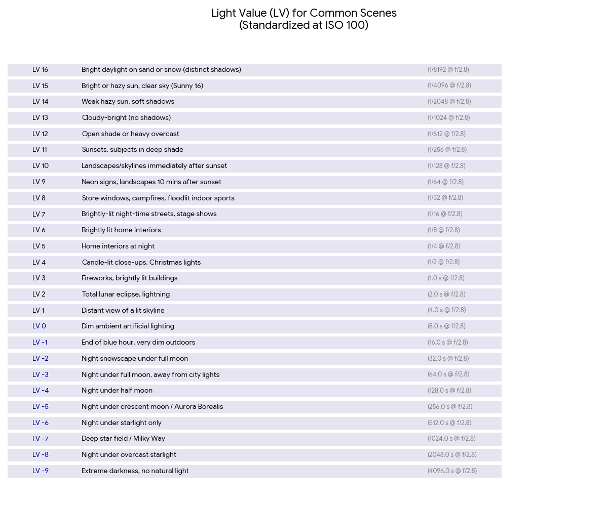

In most outdoor conditions learning the extended sunny 16 rules and manual mode are faster than incident or reflective light metering. It's only in certain ranges of conditions (LV12-LV9 mostly) that it's difficult to tell what the light value is with these rules.
