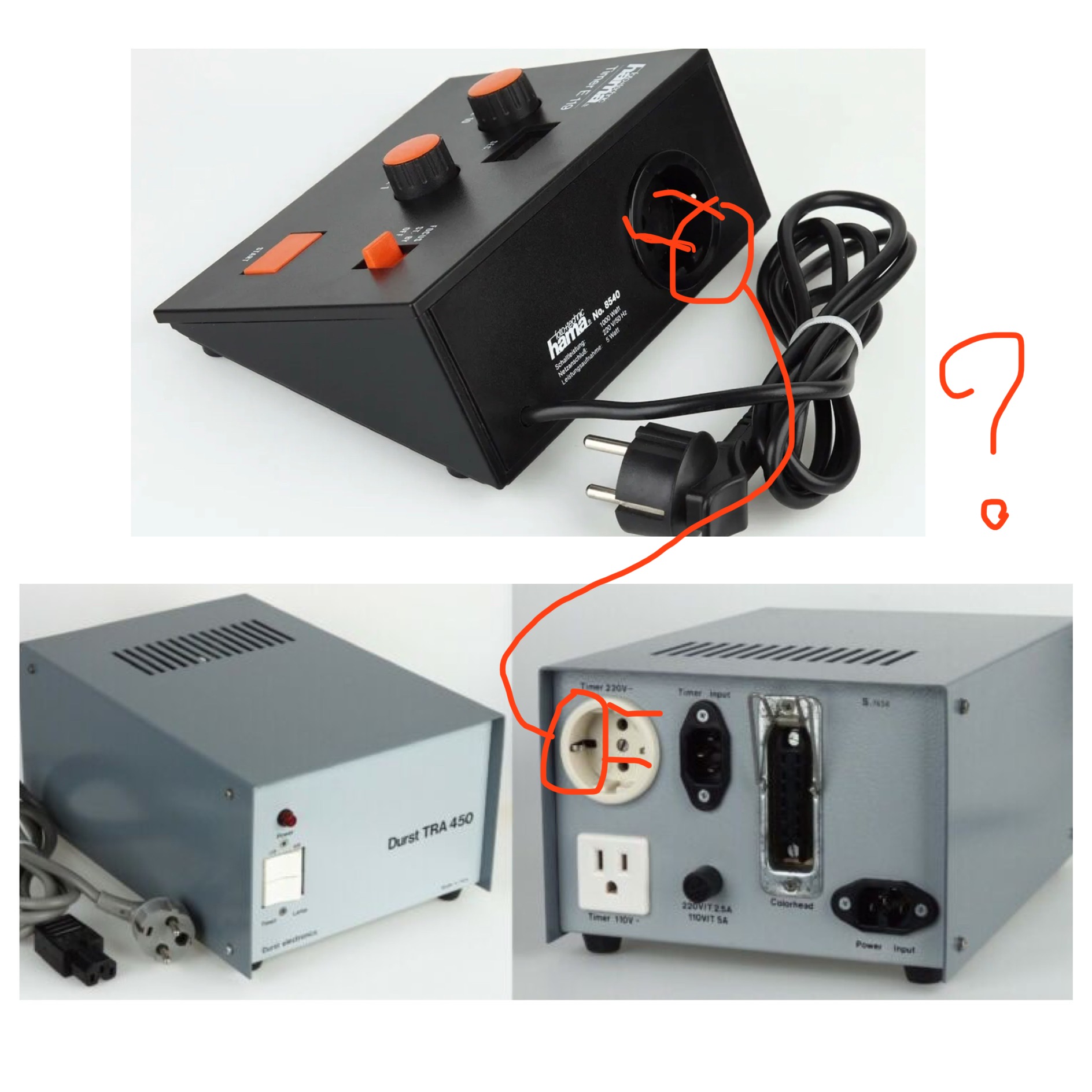

So something like this?

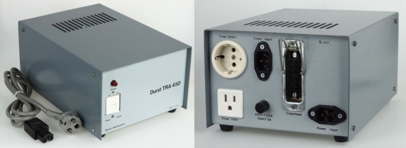

@Murdog36 you need to plug in a Euro-style power plug into the timer and the other end into the connector on the TRA450 that says 'timer input', next to the big white power output for the timer. It shouldn't matter much if you plug the timer's power cord into its own wall outlet or the TRA450's timer power output. Might as well do the latter to make the cabling less ugly, but it's inconsequential. So the red connection you drew into the photo isn't correct; it shouldn't go into the white connector on the TRA450 but the black one right next to it. Could you try this, please?

The idea by Durst seemingly is:
-) the TRA to be connected to the mains by a 3-pole german "Schuko" CEE 7/4 at the wall outlet,
and with a "Warmgerätestecker" C22 at its casing right-below at "Power Input"
-) the Timer to be connected with its mains cable and CEE 7/7 plug to the female "Schuko" connector left-above at "Timer 220".
-) the Timer to be connected with its Schuko outlet (where normally the enlarger mains cable is pluggd in) with a dedicated cable, with a male Schuko plug at this end and a "Kaltgerätestecker" C13 on the other, to the TRA at its connector center-above at "Timer Input".
This cable you have to fabricate.

What did he try then?
The connection drawn in red in the photo.

as the connection he draw in red already is possibly deadly
I think it explains the blown fuses alright :wink:
Fortunately, Irish houses can be expected to have protective measures that will prevent this from being deadly, although it sure can be frightening. Shorting 230V outlets with low impedance makes a darn loud bang alright (and it's also an effective, albeit poorly controlled way for some copper vapor deposition).
