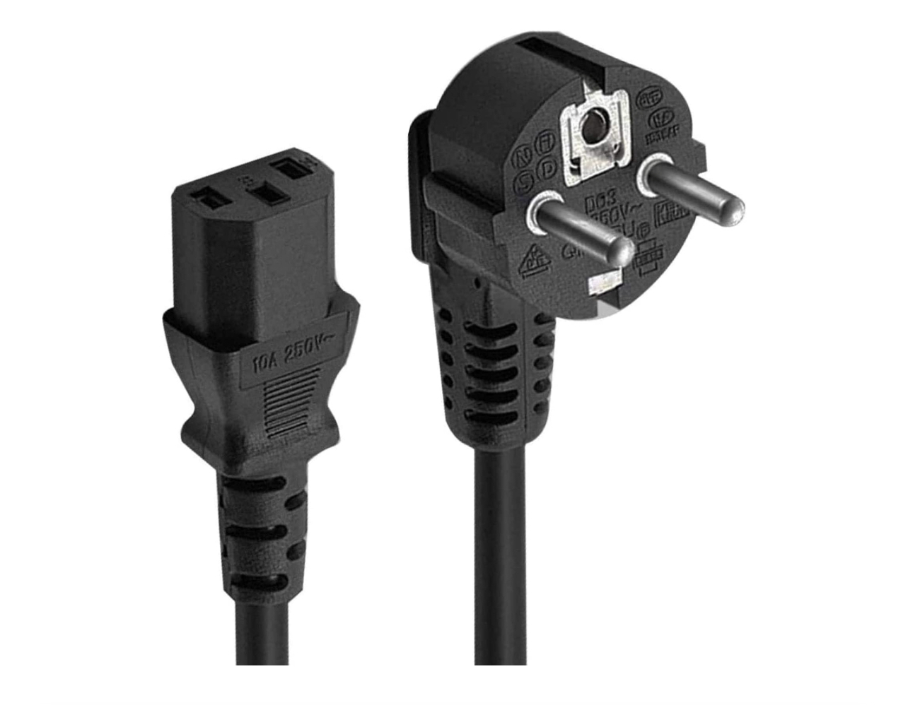

I re-ordered this just to be on the safe side. Save me messing around.

Yes, you would need this for the Durst-way set-up.
It delivers a 230V switching signal from the timer to the TRA.
