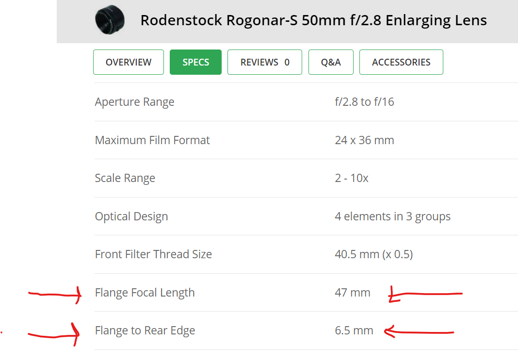

That Rogonar may have specs like the current Rogonar-S available for what seems silly money from B&H - you can see them here:
Those specs may very well be only partly compatible with that enlarger and the recessed board available for it.

If the flange focal length of the lens is much longer than 50mm or much shorter than 50mm, that enlarger can handle it, and still focus for large prints -- assuming the lens and the enlarger are working correctly, and worked correctly.
