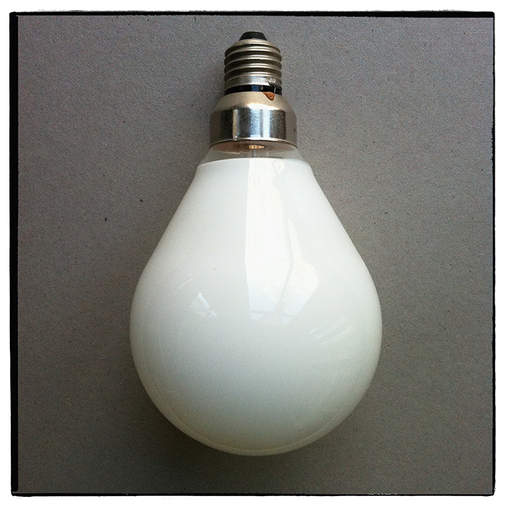

Ok, I had a look in my darkroom. I have three 200w bulbs, one made by Atlas and two made by Thorn. They are identical. Largest diameter is 11cm and the length is 18.5cm. When I put a tape around the largest part of the bulb it measures 34,5cm. All these sizes are just kind of 'looking and guessing'
This is what it says on the lamps:
Atlas: P 3/15 ATLAS 220V - 200W 82 (this 82 very small)
Thorn (left in picture) 220-230V 200W P 3/15
Thorn (right in picture) P 3/15 THORN 240V 200W

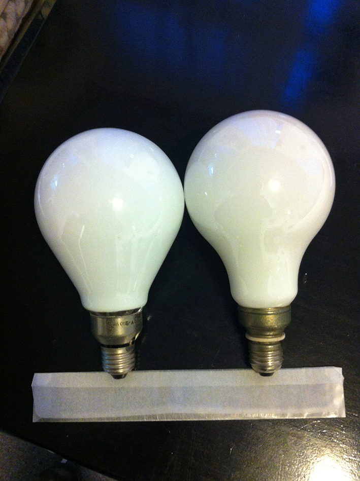

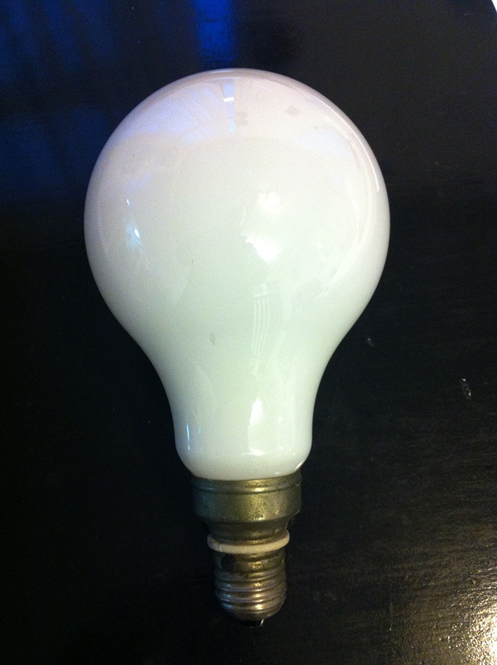

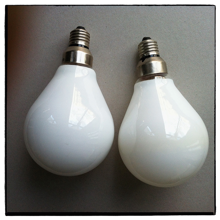

I received three more 200 watt bulbs, two have the same info which is slightly different from the ones I listed before:
P 3/15 Thorn 220 - 230 V - 200 W ( compare to my previous post) The size and shape are the same
The third bulb is quite different:
- The shape is more classic (less like a pear)
- the length is more, it is about 20cm

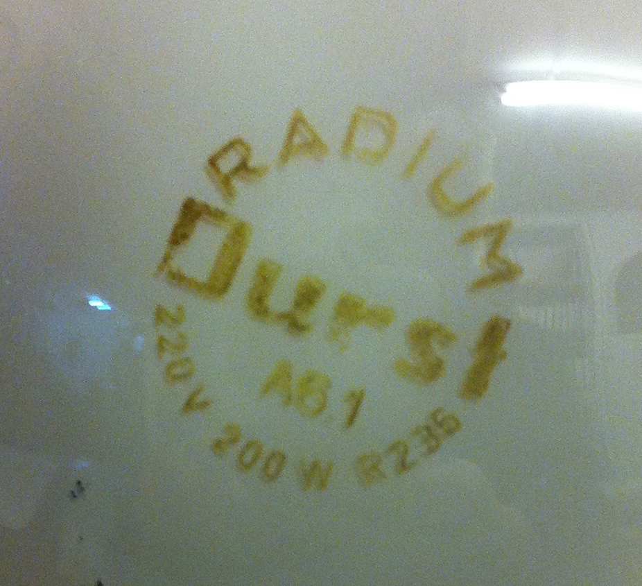

- the info is on the round top of the white opal and reads: RADIUM DURST A61 220V 200W R236
Pictures attached:
1) The DURST branded bulb
2) The info of 1)
3) comparing with the Thorn bulb

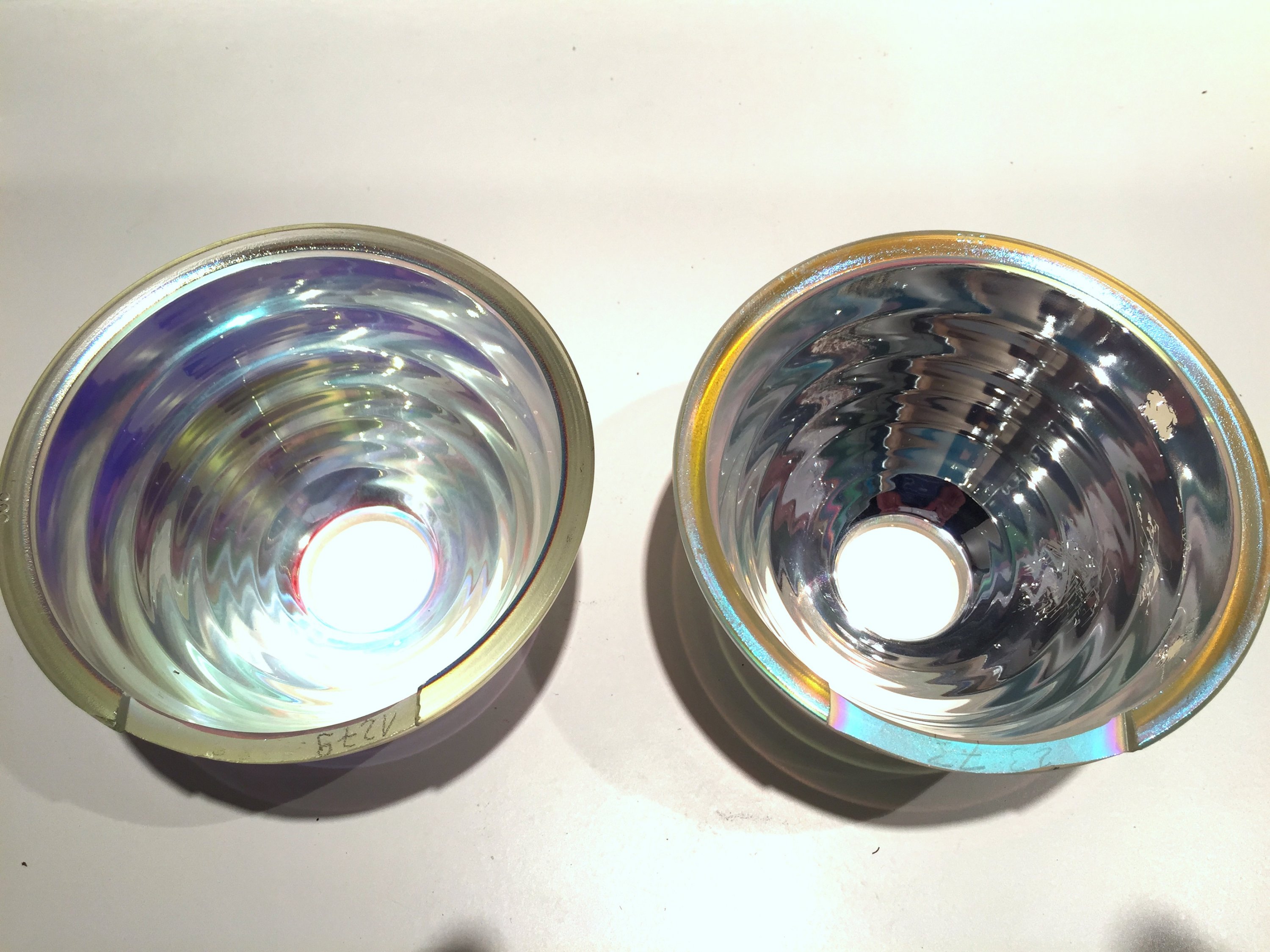

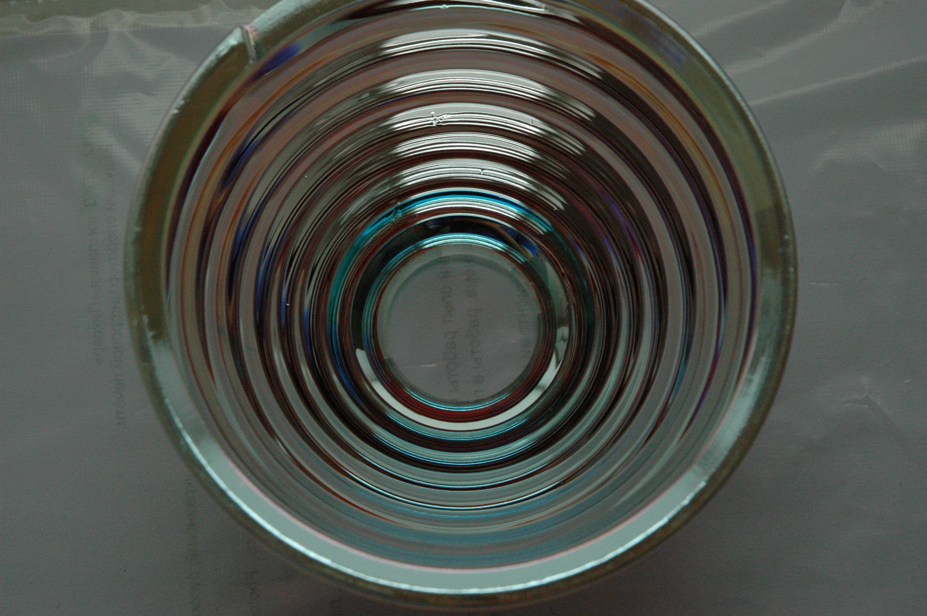

He had to find a solution for missing Durst Colamps 2000 and reflectors (not supplied with equipment) for Durst enlargers that we bought from one b(d)ad guy in Hillsboro.
After 2 years of using in practice, I think that reflectors made for us to copy few durst ones that we could get came out good.
We have ordered some few dozens of CLS1840/2000/2501/2606/Optromat reflectors as that was minimum order to make.
So if there would be a guy who can't find one for substitute his worn we might sell some from our treasure box.
The lamps that we made to copy Colamp 2000 came good for Horizontal enlargers but need to be more tested in vertical.
They came out a little bit more W than original 2000W (1.7 ohm VS 2 ohm) and some 100-200K warmer on the same settings.
One lamp is working already for a year in our horizontal machine. In vertical in factory tests, their couln't show even 100H lifetime due to filament bending down and breaking.
We made test run of 10 lamps and now 1 is down in 10-20 H run (horizontal) and the second one going for a year (horizontal) after we dropped V to 217V instead of 228V default on the pcb board.
These lamps make some yellow snuff at the inside of the glass from filament burning with time. But all those evaporations condensed on the "cold" part of the lamp (one that is outside reflector) so working part is clear.
With these DIY durst reflectors and "colamps" I could get 0.00-0.01D delta in over light field (measured with ZoneMaster photometer) over the 150-170cm board with some 150mm 1ev-stopped lens.
So they are enough to be a better option then "tomorrow" that never came.
Will try to make comparison pictures soon.
Forgot... I still have some hesitations if we used right kind of reflector coating.
I heard from an engineer that this reflector coated with some kind of coating that reflects visible spectrum forward but transmit head spectrum backwards to protect dichroic filters.
So it is so and to what extent, and were our reflectors coated right I can't yet check with present means.

Looks better than my worn-out reflector on the LEFT of this picture. I'd be interested in a new one or interested in getting the worn-out one re-coated.
