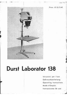

I'll let the 138 and 138S owners chime in, but if there is no other reply, the manuals I have seem to indicate the "S" has the foot pedal operated table. (see attached picture of the non-'S' and maybe lack of foot pedal).
I think the 138 3-lens turret is fixed and not removeable. Maybe I will be shown wrong on these points.
Interesting. BUT if you were right, the colour version on the right should be designated "Color Laborator 138S", which it isn't. Or was the idea to leave off the S, as the colour version was only delivered with that foot pedal from the start? Wasn't there a earlier colour head?
@ic-racer there were apparently something like 4-5 generations of the 138/ 138S - you do get ones with the footpedal table and the built-in lens turret - not sure when the move to the UNIPLA lens board model happened - the very last generation used a different neg carrier and casing for the light source/ condensers. I think the move to footpedal with the hose running to the table seems likely to represent the shift from 138 to 138S - then subsequent evolution to the UNIPLA lens board, finally moving to TRINEG carrier and new design of lamp house/ condenser setup - with the TRINEG continuing with the Durst Optopia.
The 138 series was around quite awhile and there are numerous variations of the chassis itself, plus a variety of head and carrier options, including multiple colorhead designs over time. Most components are interchangeable. My own two are 138S which I subsequently customized per light source and diffusion device. One of them came as a combo with the traditional condenser head, which I removed, and have never used. Perhaps the "S" designation has something to do with that, just like the green brochure depicts. Somewhere online there's a "Durst museum" website with some interesting pictures. I have basic L138 and L148 manuals; but they're generic with all kinds of tweaks and optional things shown. I've also encountered the hybrid 138/184 chassis for oversized baseboard use, and a rare octagonal precision column 138 chassis.
Can someone tell me how to tella durst 138 from a 138S
thanks
The 138 is the oldest model, it lacks the spring alowing the table to "float" suspended, more difficult to move it. Also the 138 header in more rudimentary having a worse handling, also probably he carrier is less perfected. The 138 is good but the 138S is more refined.

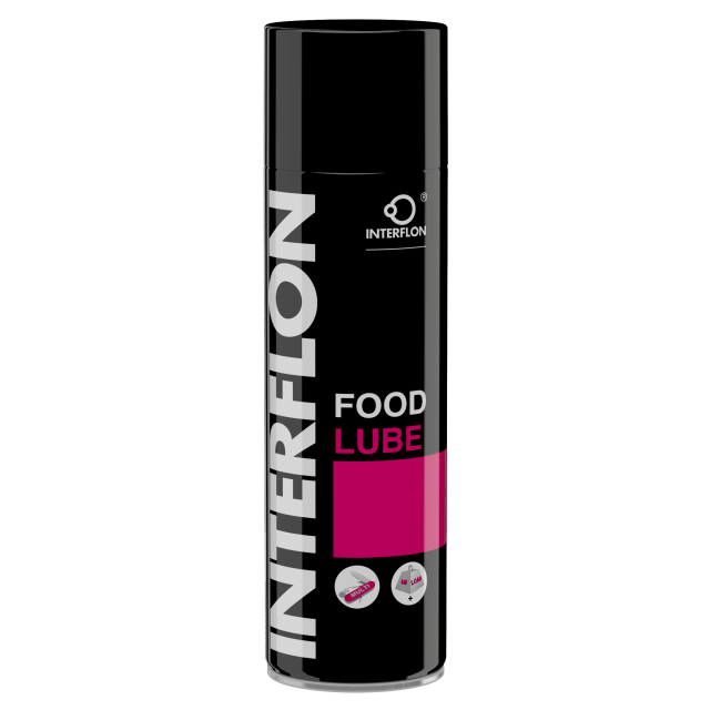

A vegetable oil cannot compete with a thin layer dry teflon lubricant...
This one: https://interflon.com/products/interflon-food-lube-aerosol
Is the H1 atoxic certified version that can be used for food processing machinery, accidental contacts with food are not a concern, nearly no smell, an incredible penetration and a powerful solvent effect to remove the dirt inside (as you move the mechanics), then the solvent evaporates and what remains is a very persistent teflon thin layer.
The "Fin" version is nearly the same but it is not H1 food grade certified. I tried most good alternatives for demanding applications (high speed razors in food packaging) and these ones were true game changers. The two 138S we have were extensively lubed with those, and years after I move the table up/down with a single finger, we were told that we had to disassembly the clutch mechanisms (etc) and we avoided that, with perfect results. Many 138 units have a lot of dirt (solidified grease) inside that is difficult to clean.
An alternative would be using a degreaser extensively before lubricating, but the penetration and edurance of a top quality thin layer dry teflon oil is not easy to match. Still it has to be real top notch one, many (even expsnive) teflon oils are lower performers, compared.

No vegi oil substitutes. They break down. And yes, I've been given samples to test, at least within the past 5 yrs. The best contained jojoba oil. Dry teflon sprays sometimes leave a white residue, so test those first too. Avoid silicones. Avoid WD-40; it's a junk product. Durst used grease on their helical drive rods on their bigger L184 chassis; it lasts, but obviously attracts grit. I'd rather go greaseless and if necessary apply a teflon blend more often that dries completely.
I referred to vegetabile oils only as 138S in his first advice referred to an oil that contains such. (Though in combination with mineral oils, which likely prevents the classic resination.)

AFAIK, the 138 has a tapered bellows and a fixed lens turret that is not interchangeable. The 138S has a square bellows and the 3 lens turret (tripla) which is interchangeable with the single lens Unipla board. The 138S has a tan or black knob on the lens state to change the lens board as seen in the photo below. I think those are the main differences. Mine is an SM-183 with the 138S camera, so I'm not that familiar with differences with the chasis.
AFAIK, the 138 has a tapered bellows and a fixed lens turret that is not interchangeable. The 138S has a square bellows and the 3 lens turret (tripla) which is interchangeable with the single lens Unipla board. I think those are the main differences. Mine is an SM-183 with the 138S camera, so I'm not that familiar with differences with the chasis.
This Durst manual, and my own personal experience working with/ maintaining a 138S with tapered bellows and a fixed lens turret suggest that you might be drawing the wrong conclusions. I think the 138 was the model before the foot operated table & with the pre-NEGA 138 carrier.

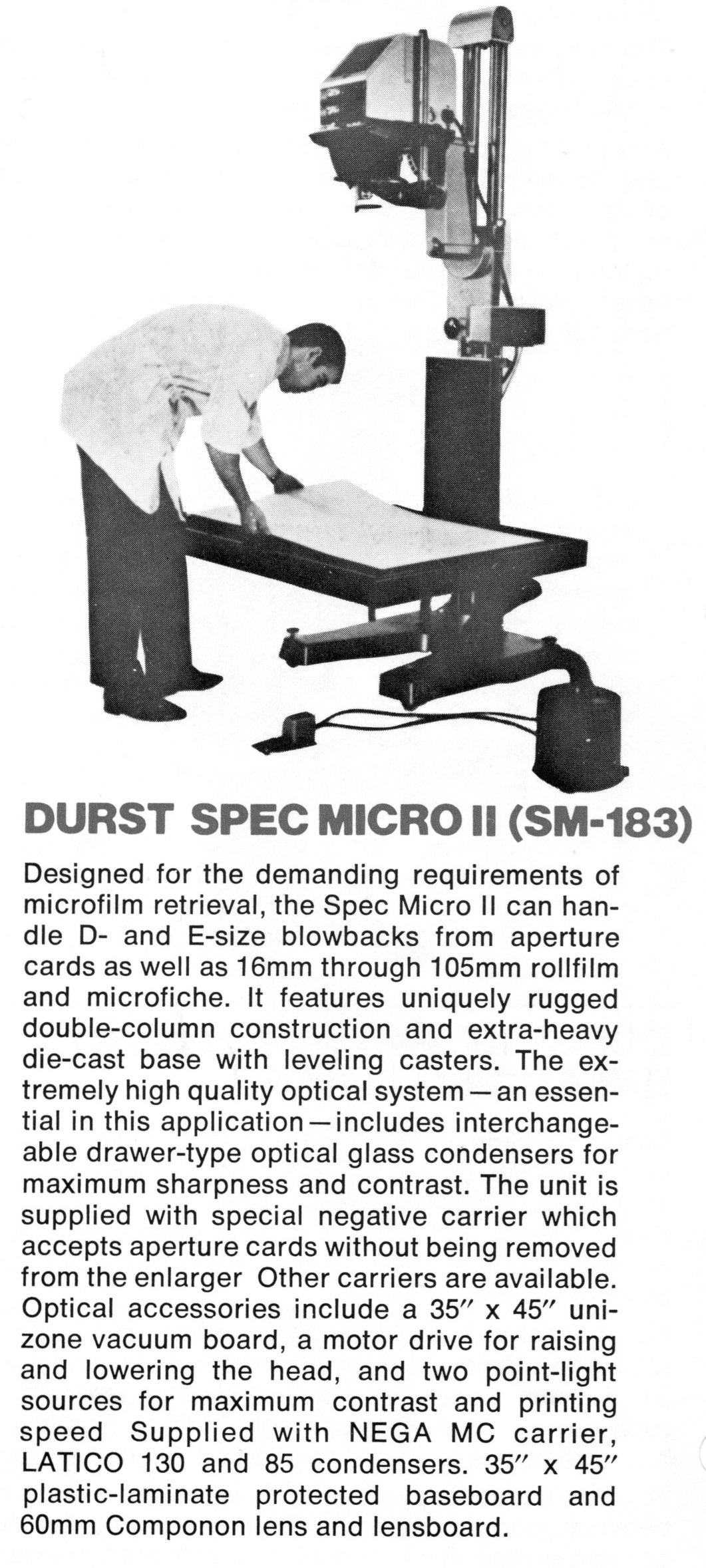

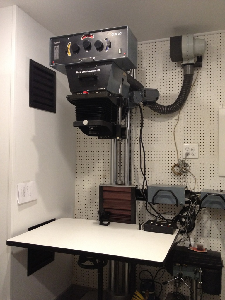

And the picture Luis showed isn't 138-style at all, but a double-column 184-style chassis fitted with a 5x7 stage, and a matching "138" tapered mixing box housing adapting or downsizing the 10X10 colorhead to the 5x7 platform. An early option configuration, I suspect, although the carrier appears to be a later NEGA 138.
There was also another hybrid version, with a thicker double-column 184 lower half supporting an oversized baseboard, but an ordinary single-column 138 upper half. I could have one of those if I had any place to put another big enlarger, or any way to haul the monster in one intact piece, colorhead n' all, up a whole flight of stairs out of a deep commercial basement without anyone getting injured, and nothing getting broken. Nope.
My statements are correct. What was it about "I'm not that familiar with differences with the chasis." that you didn't understand? How did this thread degenarate to a discussion about whale oil?
There was the L-139G for point light work (electron microscopy, I think) which was a single post upper with the L-183 base with the 5x7 camera.. The SM-183 or Spec Micro pictured had the "thicker double-column 184 style chasis" for the greatest stability and the 5x7 camera for printing microfilm. It had a 14" arm to raise the head above the height of the L-183 column This allowed for very large enlargements from microfilm. The photo above shows the arm down, thus lowering the head. With the arm up, you get an additional 28" in head height. Those are all the variations as far as I know. If anyone doesn't agree, please post photos or a copy of the manual. I do have a manual for a very early L-138, if I can find it I'll post it.

No, Luis, you've got it all wrong. The light source choice did not define 138 versus whatever, but the chassis style itself. The hybrid 138G chassis, with 184 dual lower column and 138 upper single column had nothing to do with point light sources or specialty micro work, but could be potentially used for any application where greater stability was needed. The one I could have does it for sake of a big colorhead, oversized baseboard, and greater cumulative height for sake of larger prints.. But just firm wall mounting will completely stabilize an all-single-column 138 at lesser height. Bellows style and lens mount (turret vs single-hole) were minor option differences which evolved over the decades of these things being produced. It's often hard to tell when a particular combination of features was sold that way from the factory, or jerry-rigged out of separate components by the user afterwards. All kinds of combinations were possible.

If you check out the Durst Museum site (I can't recall the specific link) there are some interesting huge dinosaurs in there, which don't show up on Jen's brochure.
Fascinating. Kinda like the head of a marmot on the body of a hippo. That beast has little resemblance to either the G138 enlarger depicted earlier or any 138 series support. What you do show is a full 184 chassis (double column full height) with a factory equipped vacuum baseboard (no doubt pin registered), plus Fein Italian-made vacuum, then a sizing adapter up above to accept a 5X7 carrier platform etc, and matching condenser head point light source. It was basically replaced by a very expensive temperamental autofocus unit which uses none of the above support options and requires unique carriers, not shown in Jen's brochure. I know where there's a used one of the latest version for sale; but they're holding out for 75K, set up to do 35mm film, replete with an apo lens (not an ancient Componon), just in case you also want to finance the revival of Kodachrome while you're at it.
That scan is from a Durst North America (no relation to Durst-Pro) brochure from about 1978. The other enlarger pictured on the page with the SM-183 was the S-45EM. So it seems they offered a 5x7 enlarger setup for 4x5 (S-45EM) and an 8x10 enlarger with a 5x7 head (SM-183) for 'scientific' purposes.
I think the S-45EM are more common, a friend of mine has one. I have never seen the SM-183.
