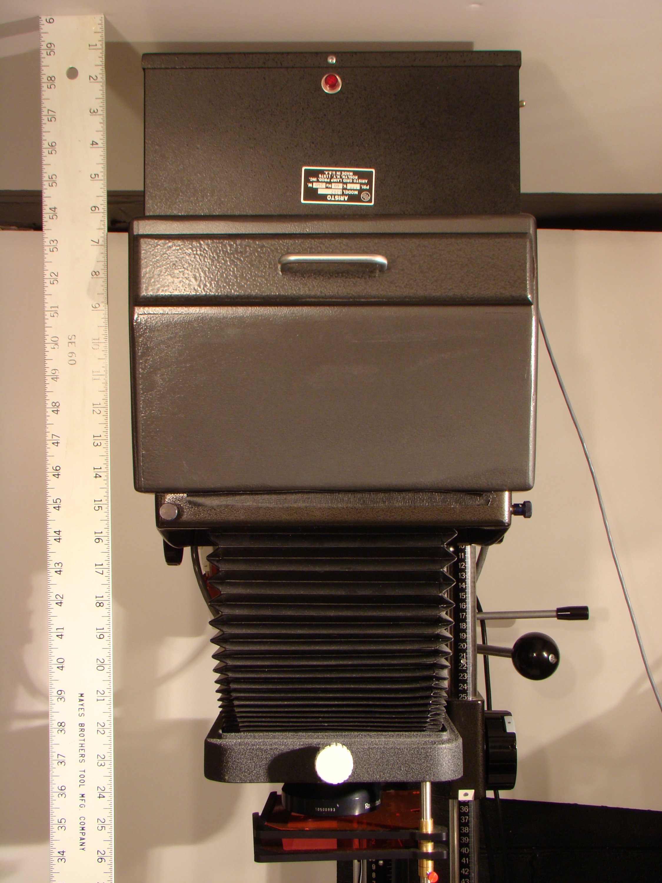

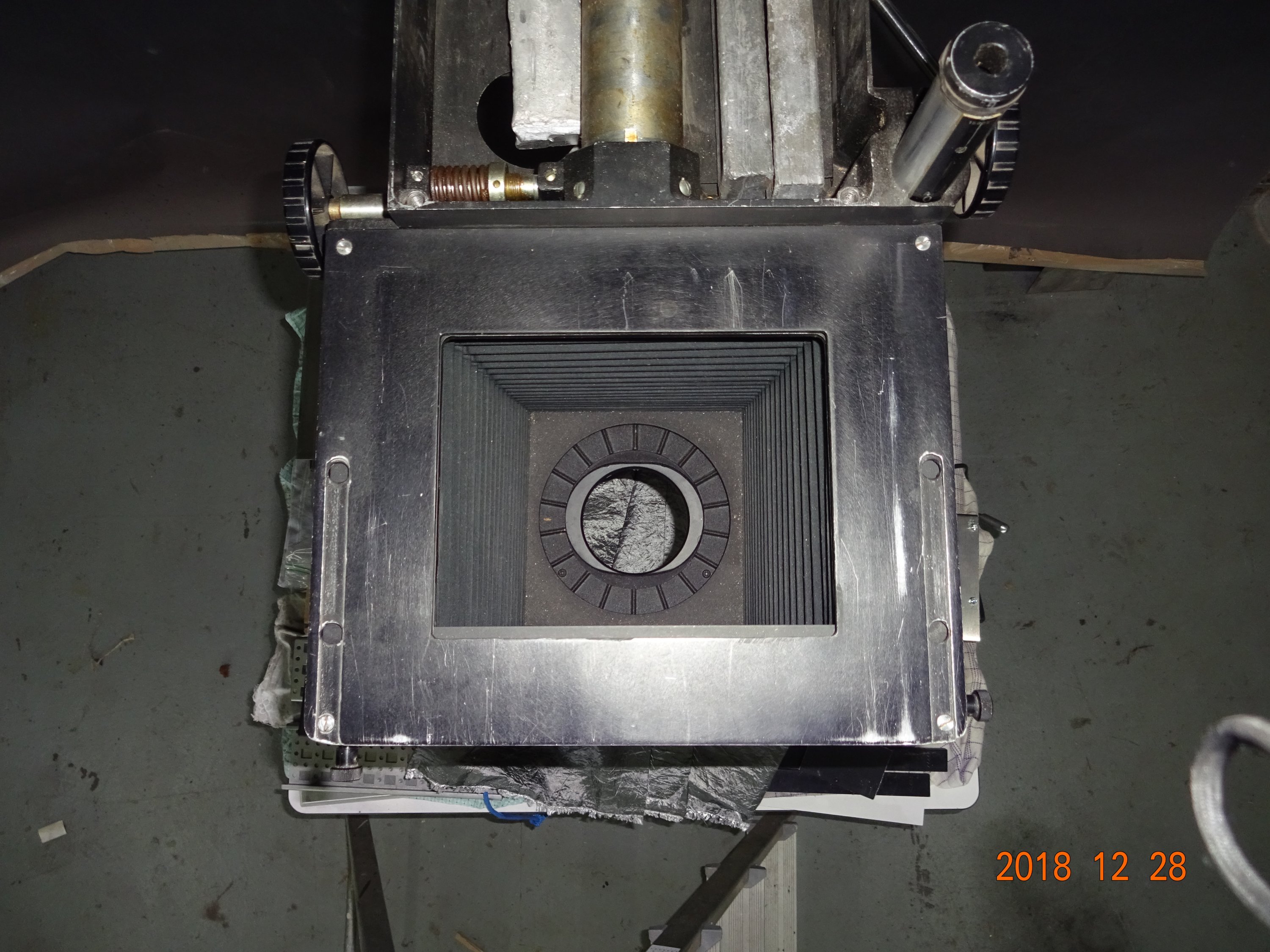

Doc W,
The LACAP (metal part under a CLS301 color head) and LATIBOX will be no help because theses are too small for your need.
You need to start the larger possible over the bellows, removing the masking blade will be mandatory. If you look on eBay I have this stage and you can see then when the plate (5x7 opening) is removed (exact item https://www.ebay.ca/itm/303011577869) that the masking blades still reduce the opening of negative stage (see this part https://www.ebay.ca/itm/292893993486).

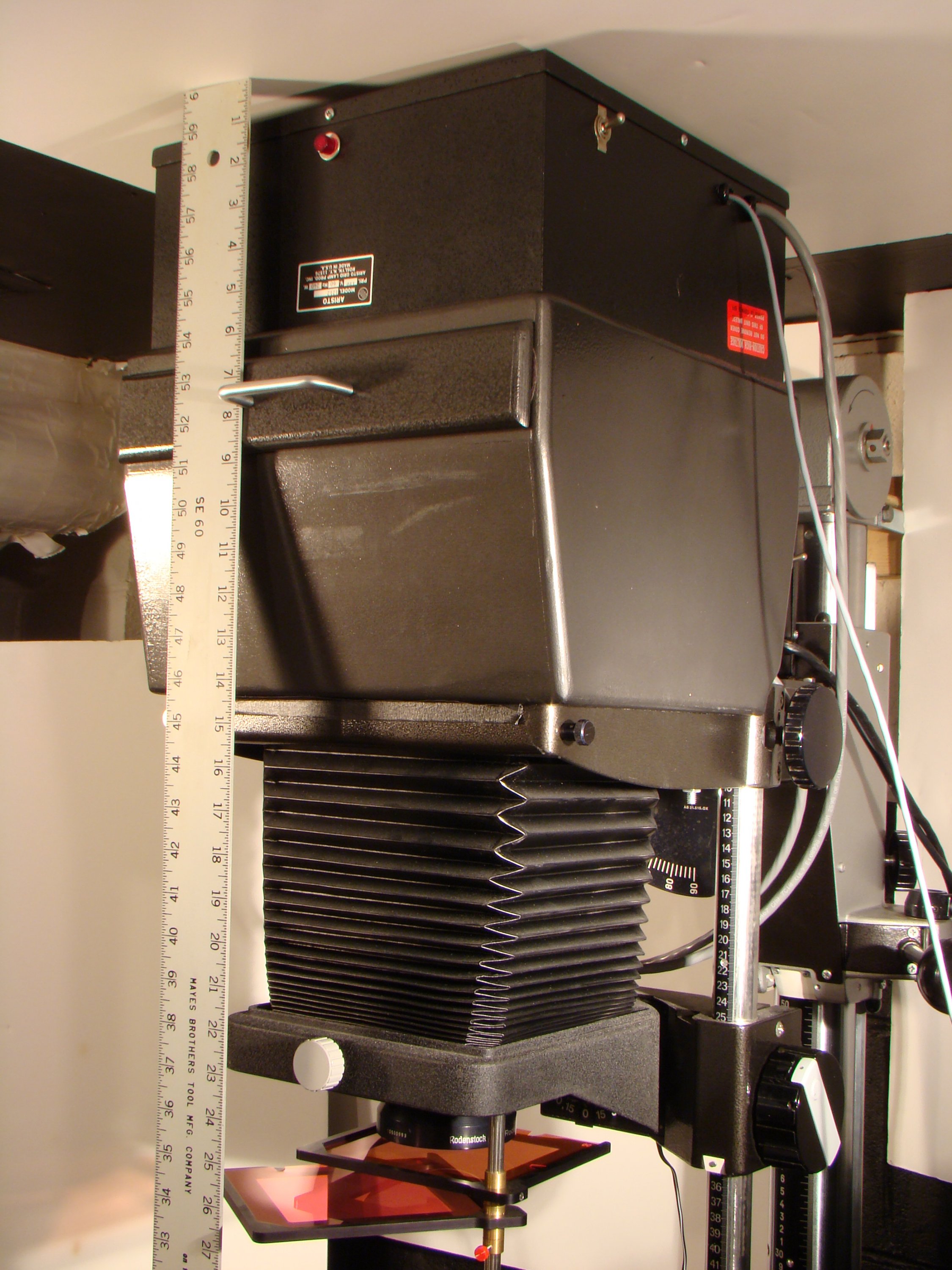

Over that part, you will need to make an extension box. The Michael Mutmansky box look metal but it is in wood! The drawer is the new negative stage. His negative carrier is simply a sandwich of 2 glasses.
The box need to be solid enough for the coldlight over it (coldlight with power supply in the head is heavy), LED unit can be less weight. But anyway made a solid extension box because the negative stage is into.
Here anothers images of Michael Mutmansky conversion that you can figure the height extension needed.

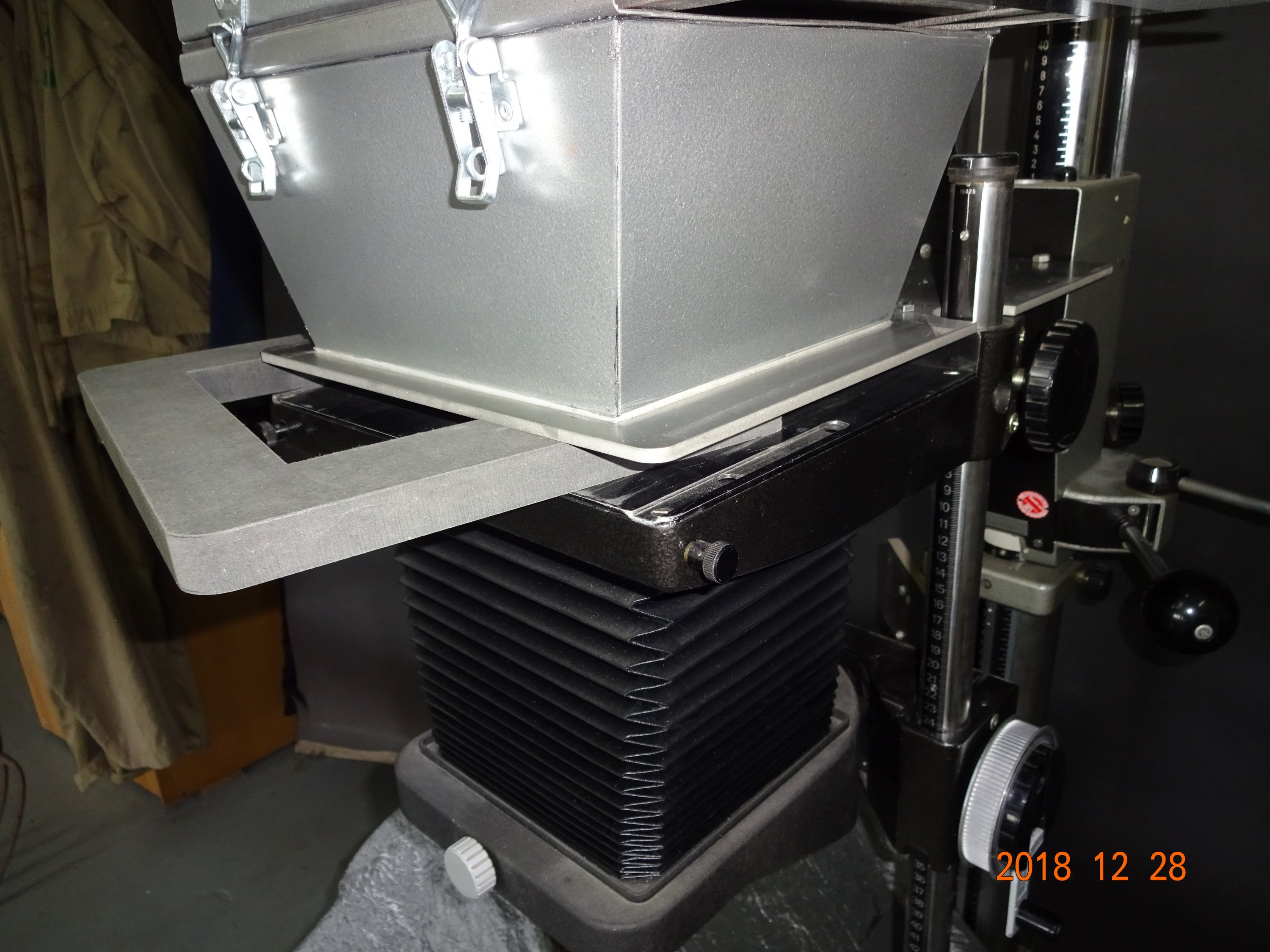

i have had quite a few questions on the conversion for sale.
here are informations:
the light box is with 53 pcs 3W leds driven by 2 led drivers. height is around 18 cm . led are glued on the 5 mm alu cooling / top plate.
the light has exactly same brightness as the original in my BW 300 head ( and that is the brightest of all durst enlargers)
and no need for cooling fan !!
the unit is made for 240 mm lens, negatives in 18x24 cm ( near 8x10")
all parts are lazer cut and spray painted in grey Hammerite paint, weight 9 kg same as original equipment.

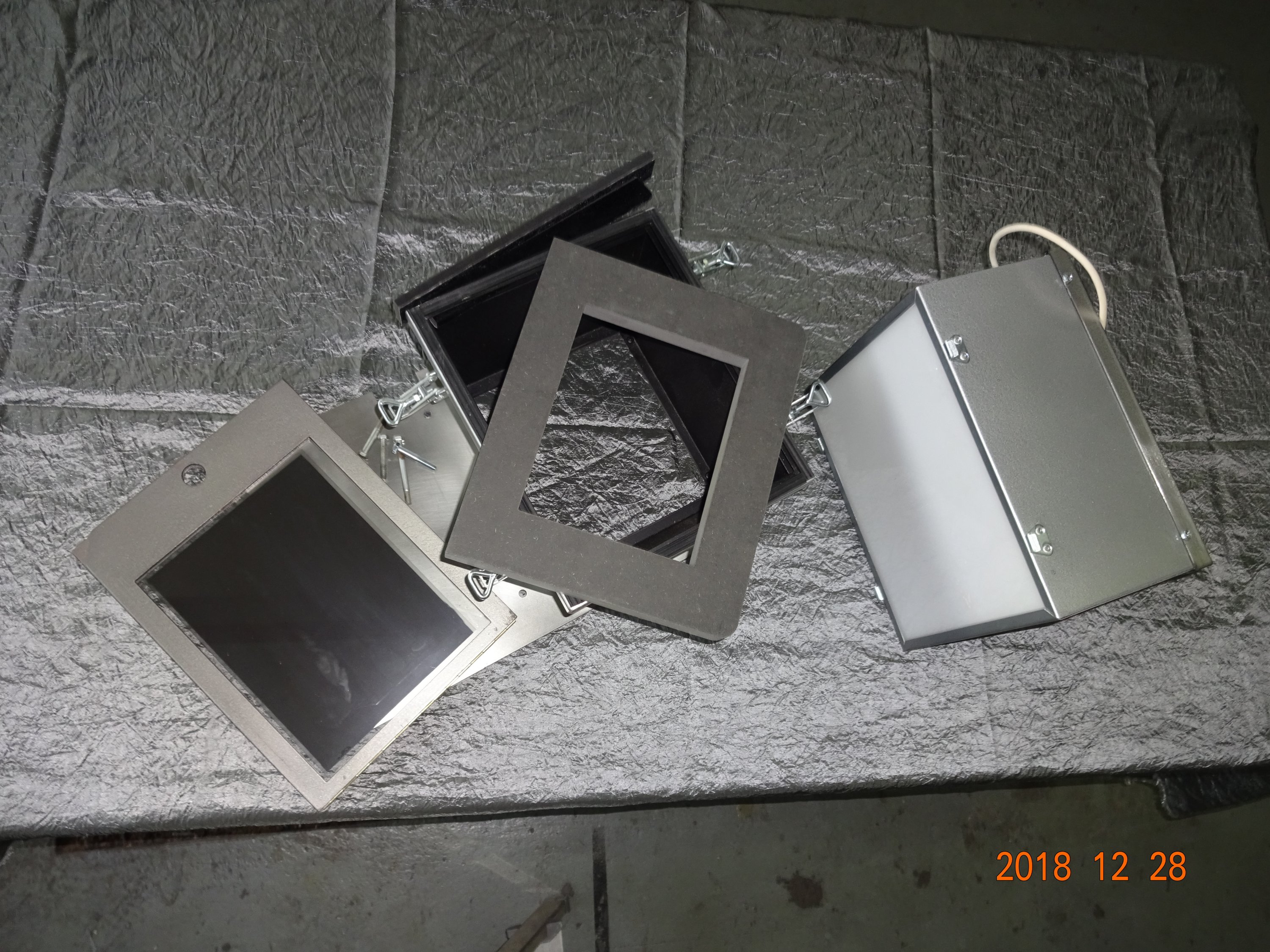

all parts needed for the set up are included:
one light box compleate with led and driver and 10 pcs spare bulbs
one pyramid stub on stainless plate / carrier
one 8x10 glass neg. carrier book type
one BMF insert ,with a cut out hole, to replace the original 5x7 neg carrier
one insert / light seal for replacing the 8x10 neg carr. ,in case you want to use original Durst 5x7 carrier with the led head.
you only need to cut out 2 corners of the alu plate under neg carriager. (see picture, you see what i mean)
a screwdriver to take the old head off and a 10mm spanner for the new unit.
that is all !
with my conversion you are still able to use the enlarger precisely same way as beforeDSC00075.JPG DSC00081.JPG DSC00082.JPG ,
nothing is altered apart from the small cut out.
if you dont use under lens filters you can use 5x7 neg holder, but you loose light then. i do not recc. that.
